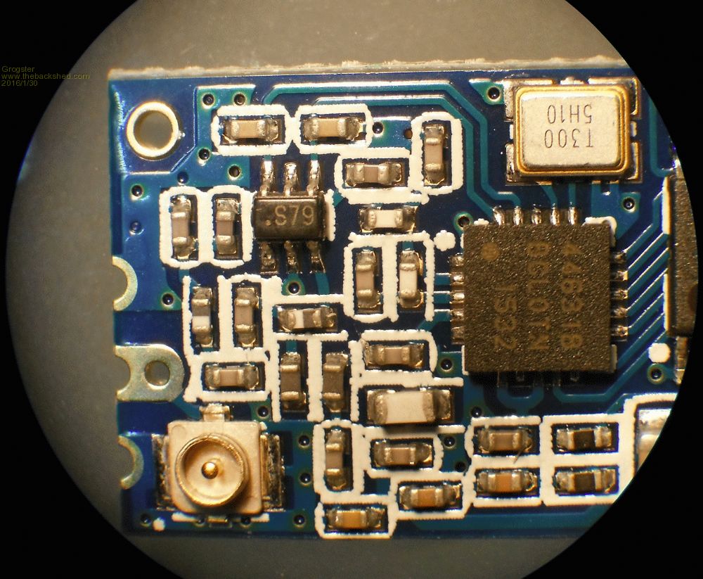

  Grogster said   I much like the little micro antenna socket so that you could elect to use an external SMA antenna if you wanted, which should make the performance even better.
What kind of socket is that tiny thing? I think it's the same as on my HC-11.
Its a UFL.
You can get UFL to SMA socket leads for around £1 delivered on eBay.

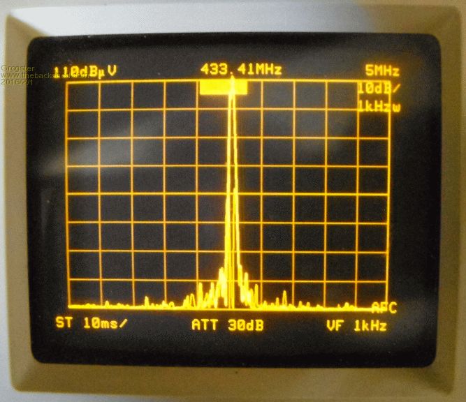

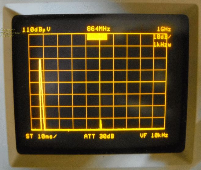

Posts: 10081
Posted: 03:22pm 31 Jan 2016
RF output @ 100mW directly into analyser via UFL socket on default frequency:
Spectral purity, showing 2nd harmonic - 3rd harmonic is immeasurable:
Considering the price of these units vs the output power, I am actually very surprised at how clean they appear to be in some basic analyser tests.
I am indeed impressed.
2nd harmonic @ 866.8MHz was better then 70dB down on the carrier, and the 3rd harmonic was totally invisible, as you are into floor noise by then - this is very good performance in my humble opinion, and I would happily recommend these modules to a friend.
(EDIT: That should be 1st Harmonic was 70dB down on the carrier, and 2nd and 3rd immeasurable. Excellent, IMHO.)
As mentioned before, this is not exactly a lab-level test, but it does result in some useful information as to what they actually emit onto the spectrum.
...hard to get over the price of the things for the output power - I was SURE they would have a dirty output at that price(cos something has to give, and it's usually the output filtering), but...
Edited by Grogster 2016-02-02
(EDIT: That should be 1st Harmonic was 70dB down on the carrier, and 2nd and 3rd immeasurable.)
G,
You had it right the first time: the second harmonic is 868.8 MHz. The first harmonic is rarely used in conversation, but it refers to the fundamental.
H

  Grogster said   2nd harmonic @ 866.8MHz was better then 70dB down on the carrier, and the 3rd harmonic was totally invisible, as you are into floor noise by then
I've spoken to grogster, and there is just a little mistake here in the magnitude of the 2nd harmonic.
For the record, from the screenshot, 866 MHz is down by a little more than 50 dB.
