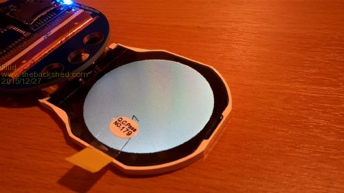

Posted: 08:34am 27 Dec 2015
Nothing again, unfortunately

Posted: 12:42pm 27 Dec 2015
  Quote  Nothing again, unfortunately
Have you a scope to check that all the control and data lines are correct and waggling? All wiring must be as per SSD1963 for the 64-pin MM+
RESET - single low pulse at initialisation then high
RD- high
CS - Low
WR - very fast negative pulses
RS - low and high with slower timing than WR
DB0-DB7 all showing movement
IOVCC and VCC = 3V
If you can find/check them IM3-0 should be 0b0011
The new initialisation sequence is taken from code that is purportedly working for the R61505V so should at least blank the display ready for use

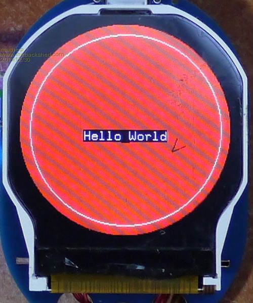

Was looking a your round display Pix above... What kind of PCB is the display connected to..? I was wanting to order some of round R61505V based modules from Ebay, But it looks like you have one mounted to a PCB with some kind of plastic mounting frame for the display.. Is this your creation..? Looks like a SD card connector and other parts there... Just wondering...
I was hoping you got the new driver from Matherp running OK....
@Matherp..

  Zonker said   @kiiid
What you see in the picture is a small board that I have designed for this display. It has a MM+, uSD, and a couple of other features. Since it is still in a very early stage, I can't announce any details yet.

@kiiid...
Would you have the info and pin-outs of the round display..? Will be ordering a couple of these this weekend... Thanks in advance..!!
Posted: 10:25pm 29 Dec 2015
Zonker
We haven't got a working driver for this yet. Kiiid is sending me a display to work with but code that should work isn't so you may want to hold off. There is very little evidence on Google that anyone is getting this display to work.

Posted: 12:49am 30 Dec 2015
  Zonker said   @kiiid...
Finding enough information for these is not very easy... As @matherp says there is still no evidence that it will be possible to use them with a mite. Anyway, here is a datasheet for one of them. I assume they all are sharing the same pinout although made by different manufacturers.

Zonker
The driver for the ILI9325 works on both 44-pin and 64-pin
This driver is similar but not the same as the R61505V. I've produced a driver for this but it is not yet tested.
It transpires there are two variants of the mounted display: the TFT1P2477 and the TFT1P4967 (both use the R61505V controller).
These need different wiring. I think Kiid's board is wired for the TFT1P2477 but the one he sent me has a TFT1P4967 mounted which I don't think can work irrespective of whether the driver is correct.
I'm communicating with him off-line and will update when we know more

Posted: 05:23am 30 Dec 2015
  Quote  Aaah, please don't say that!
I'm afraid so:
The banding is just an artifact of the photography

Posted: 06:35am 30 Dec 2015
  Quote  How did you get this one working? Using DB8-15, I guess, and high on pin 26?
Yes
Tested code for the R61505V is attached.
There is something strange about the way these displays address - I assume it is the same for all versions but it means I have had to do some address mapping in the CFunction. This is transparent to the Basic user except that MM.HRES and MM.VRES are both set to 230 although the display is effectively 220x220 (with the corners removed).
The only effect is that the centre point on the display is 110,110 for all orientations and not MM.HRES\2,MM.VRES\2
C Code attached. This includes conditional compilation for 44-pin, 64-pin, ILI9325, R61505V.

'**********Append this code and below onto the end of your MMBasic program***********
' Copyright (c) Peter Mather 2015
' Initialise the Display Driver for R61505V controlled TFT LCD Panel in 8-bit databus, 16-bit mode
' i.e. RGB565.
' Display.Open initialises the loadable CFunction driver so that you can use all of the
' MMBasic graphic commands in your program.
' Orient% LANDSCAPE=1,PORTRAIT=2,RLANDSCAPE=3,RPORTRAIT=4
' RST% is pin number of Reset signal
' After Calling Display.Open, any of the usual MM Graphic commands may be used
' in your MMBasic program, eg BOX, TEXT, LINE, CIRCLE etc
' Use the standard Micromite+ LCD pins
' Tie CS Low and tie RD high
' Ver 1.02 2015-08-19 Initial Release
' Ver 1.03 2015-12-21 Swap parameters for compatibility with 64-pin code
' Ver 1.04 2015-12-27 Initialisation for R61505V controller
' File R61505V_V64.bas written 27-Dec-2015 17:37:02

Thanks a lot!
That was a priceless help
