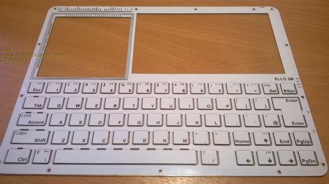

Continuing with the topic - for whoever is interested, this is the current firmware of the keyboard controller. It generates the entire ISO8859-15 table straight from the keyboard (although MM+ will not support the upper half of it, yet). Also supports controllable auto-repeat.

I also have a better design new keyboard panel for the final release as well. It is much easier for alignment and includes the functional keys and the shortcuts for on, off, reset and battery check. The shortcuts are executed together with CTRL pressed and held for a certain time.

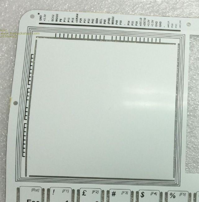

I am particularly interested in the experimenting area.
looks like a grid. Do you have a closeup/schematic of that?

The schematic is on the panel. Well, almost...
There are 26 columns, each consisting of three linked groups of 9, 8, and 9 dots. The whole array is surrounded by four (only three are drawn on the panel) 'circular bus' lines.

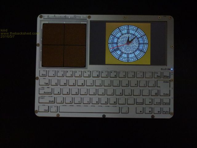

Pether's excellent Big Ben clock is the first program ever ran on my just assembled and now fully functional ELLO 2M laptop (still using the old screws as the new ones with smaller heads are on their way)

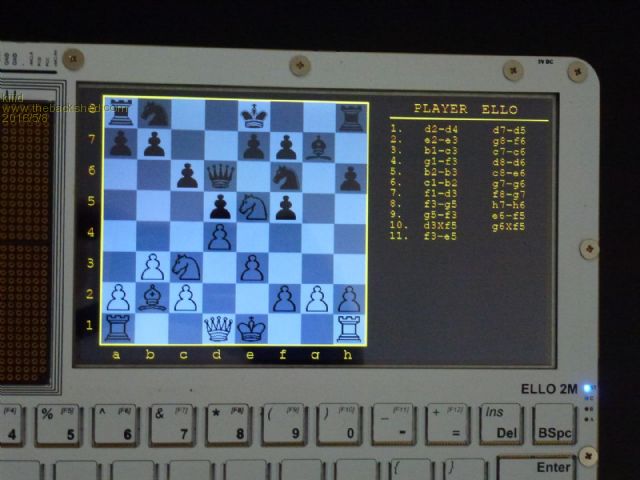

I think this is the first ever of its kind running on a MM-powered system
http://rittle.org

Is that a membrane keyboard or real buttons?

@bigmik
Kon has 'constructed' the keyboard by using the PCB layers of his solution. So he has five (or six) PCBs and uses the top layer as the key 'cap' (with the legend printed on it), and then some 'spacers' before the contact layer. There is enough 'flex' in the top layer to give a key-like feel to the overall set-up.
I was lucky enough to see an early prototype and will hopefully see this latest version in a weeks time
As Geoff has said - it is a brilliantly engineered solution and wish Kon every success with this product
EDIT: Kon has cleverly cut a specific shape around the top keyboard 'key-cap' to create the moving key 'button'. Hope this makes sense Edited by WhiteWizzard 2016-05-10

I did notice some `slots' milled/punched into the top panel but I wasnt sure,
I gather 0.6mm PCB substrate would work out quite well, a novel approach that I have never seen before..

0.6mm will be to rigid for this size of the keys. I had made the earliest prototype using 0.4mm, and it was too rigid as well. Currently I am using 0.25mm for the top panel, but my feeling is that 0.3mm is just about the right one for it.

just a question : what is this Chess software ?
is it the code source available ?
is it for Micromite (with LCD screen) only ? or alson for Maximite on VGA ?
thank you for answer

Posted: 02:29am 09 May 2016
It doesn't use any hardware-specific references and will work on any MM+ system with 800x480 touch-screen LCD. It will not work on the Maximite because its Basic doesn't have the GUI commands.
This is not based on another chess program. I have written it entirely from scratch and will publish the code once it is fully ready (still working on its play strategy).

0.25mm? 0.30mm? Boy that is thin, I used 0.8mm on my Nanomite and I thought it was very thin but you are talking less than 1/3 that thickness..
Wow again... I wonder how the longevity of it would be, any ideas?
