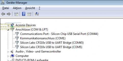

Posted: 02:20pm 26 Oct 2015
What version of Windows are you running?
Assuming that you are NOT running W10,
If the board worked previously, you must have installed the Silicon Chip drivers.
If so, the maximite would appear under "ports (COM & LPT)"
If there is a problem, there will be a device with a yellow exclamation mark, either ports or other devices.
If you ARE running Windows 10, it might appear as a Microsoft serial port.

  jeffj said  I understand that the mm should show up in device manager under "other devices"
There is no "other devices" showing up . I assume this is only displayed when something is found .
Hmm, can you confirm a installed Silicon Chips COM port driver?
Michael

Posted: 07:41pm 27 Oct 2015
this may help:
1. right-click on the unknown device and delete it.
2. unplug the USB connection between maximite and computer.
3. re-connect the USB.
4. when prompted for drivers, navigate to the silicon chip drivers you downloaded.
i've not followed the thread too closely, but if windows marks a device as 'unknown' it can often be quite determined about not installing any drivers for it until the 'unknown' entry has been deleted. this is why many printers and scanners come with a label stuck over the USB socket telling you to NOT plug in the USB cable until AFTER you have installed the supplied drivers.
rob :-)
Posted: 07:48pm 27 Oct 2015
On the XP machine,
look at devices before and after inserting the maximite.
That will tell you if the PC sees any changes.
The maximite will hopefully be the unknown device. If so, you can right click and update/install driver as per the Silicon Chip instructions.
A different USB cable and different port on the PC is always worth trying.
