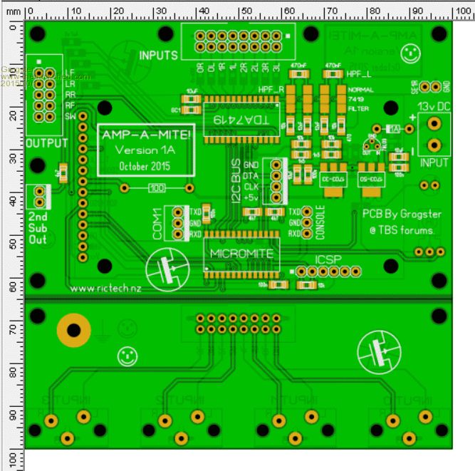

Great project! Just a quick question slightly off topic - what software do you use to design the PCB? I like the transparency effects, it looks very professional.
Akash
Posted: 08:49pm 30 Sep 2015
Sprint Layout 6

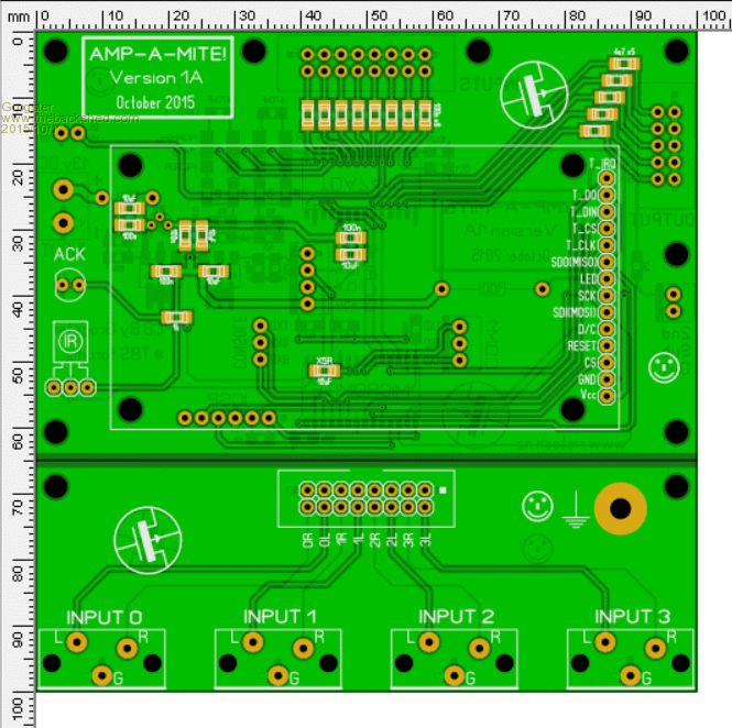

UPDATE
New version of the main pre-amp board. This is a 100x100 panel, but with two seperate boards on it - the main board, and the input sockets board. Technically, this is a multi-design panel, and the likes of Shenzhen2U will charge an extra US$9 for designing like this(they call it 'Sub-boards'), but I still think it is cheap for the price - US$20 or so for ten sets of boards - pretty good!
I plan to order all these boards next week after a few more tweaks, and while I wait for the boards to arrive, I can concentrate on doing the case. Jaycar sell a lovely case for this kind of project, and not to bad on cost: HB5556 - which is probably the one I will elect to use. If that one proves to be too hard to fit everything in, then I will look at getting a custom laser-cut and powder-coated case made - they are not really that expensive.

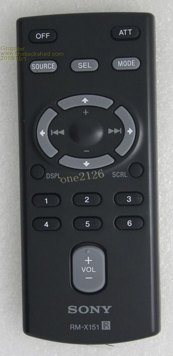

EDIT: This is the remote control I am going to use - hopefully.
It is simple and not covered in buttons, but should allow all the basic features to be included. Being a Sony remote, this one is most likely a 40kHz one, but element-14 sell Vishay TSOP4840's for only a couple of bucks or so, so that will be the receiver to go for. I will try it with my 4838's for a start, but the 3840 would be desirable.
These remotes are easy to find on eBay for about US$4 or so, or brand-new ones can be had from a few traders for only US$10 or so, but the shipping cost from America is what keeps me buying from China most of the time as far as eBay is concerned....Edited by Grogster 2015-10-02

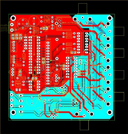

Talking about amplifiers and pre-amps.....
Ages ago I built a stereo pre-amp based on the PGA2310 stereo audio volume control chip. This used an IR control and also control by a rotary encoder. It used two Picaxe chips, one 8-pin for the IR and the other 28-pin to do all the rest. IR is blocking on the Picaxe. The display is a standard 16x2 LCD.
The board supports 4 channels switched via relays with one available internally to connect to a DAC if built into an amplifier. Connection of the audio signals is by PCB mounted dual phono connectors
Supply requirements are one or more transformers to provide 9-0-9 and 0-6 outputs
The circuit is attached:
2015-10-01_104930_Preamp_-_Project.pdf
and the layout was carefully done to separate the digital and analogue circuits with a single point ground connection
I've got a number of these boards left. If anyone wants one send me a PM. It should be possible to use a 28-pin Micromite to replace both Picaxe with a bit of patch wiring. Alternatively I can make the Picaxe code available if required.

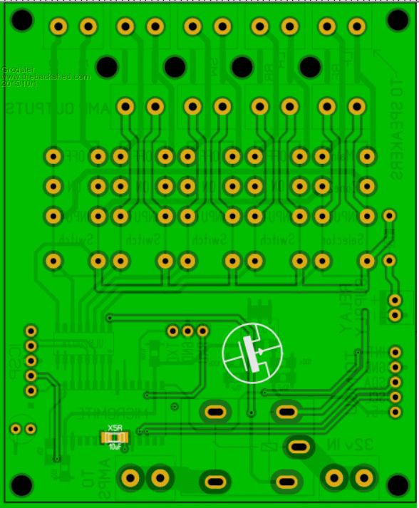

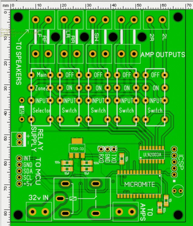

UPDATE
Thanks to matherp, I have replaced all the 337 relay driver circuits with a single SOIC ULN4003A darlington driver IC, and this has allowed me to shrink this board by 15mm on one side - yay!
I have added a grunty 10A relay to switch the main juice on and off to the amp modules when the system is "Off" in standby. I have also added a couple of bits to the main preamp board to turn off the LCD backlight when in standby.
There is also a line going back to the preamp board called INT. This is an interrupt line from the relay board back to the preamp board, so that if it wants the attention of the master, this can be used to tell the master that the relay slave wants to talk to it. I plan to add some extra temp sensors etc to the amps and maybe PSU, which the slave board(the relay one) can monitor, and if it detects anything urgent, it can signal the master that it wants to send some info, and if this data is bad enough - like overheating - the system can shut itself off and display a message to that effect on the LCD.
3:37AM now, so enough for tonight!!!!!
EDIT: There are still a couple of errors on this board - will fix them tomorrow. 32v amp switching relay coil is not connected, and the CONSOLE word is on top of the pins at the moment. 2003 main GND needs to be thicker. No series resistors needed anymore(the 1k network in previous images), as the 2003 has 2k7 base resistors built in - this is really neat.
More tweaking tomorrow.Edited by Grogster 2015-10-02

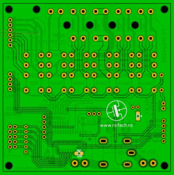

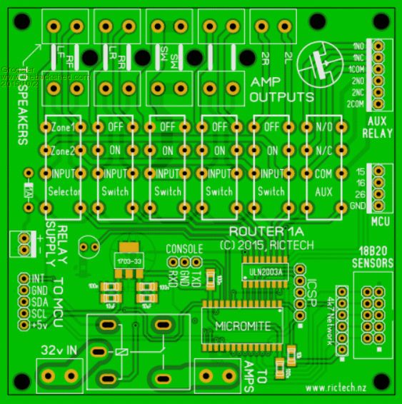

UPDATE
OK, I have finished the relay board:
I added one more relay so as to use the full ability of the ULN2003 chip. This last 7th relay is not assigned to anything, but it might come in useful at some point. The remaining three unused pins are routed to the MCU header - they might be useful later too - you never know.
The plan is to control the relays with a single byte from the master. The byte will control the PORT command for the relays connected via the 2003 to pins 2-7 by setting the PORT command. PORT(2,7)=BYTE_SENT_FROM_MASTER kind of thing.
The board allows for up to five separate 18B20 temperature sensors running with parasitic power, to monitor up to five different heat-spots inside the amp. Naturally, you don't need to use these unless you want to - my initial code won't even allow for them - this is future-planning.
Traces made much thicker around the subwoofer speaker relay, as this one when thumping hard, can be passing a quite respectable current. Trace width of 2.5mm on 1oz copper board allows for up to 5 amps of thumping current for the sub - about 160W RMS for the sub(at 32v)
The other speaker tracks are 1mm, which is good for 2.5 amps on 1oz copper - about 80W RMS per channel(at 32v).
What all this means is that unless you are running the amp at the Motorhead #11 setting(out of ten!), then the relays and tracking around them should be able to cope with just about any amps you connect to the system.
I will be ordering the boards next week, so I can start building. I expect that the problems will surface once I start trying to talk to the 7419 chip via I2C.
But you never know - things might just work - that would be nice.

Grogster, do you have any concerns with driving the uln2003a with 3.3v? I am trying to find information on doing this as the chip is speced at 5v. I'll keep searching....
EDIT...
Just found this...
Note: Although this is specified as a 5V chip, it works fine at 3.3V although max output current will be reduced to at max 300mAEdited by viscomjim 2015-10-04
Posted: 03:48pm 03 Oct 2015
...as you say.
As the DIL relays use about 30mA, and the larger SPDT one for switching the amp power uses about 40mA or so, this should not prove to be a problem - hopefully!

UPDATE

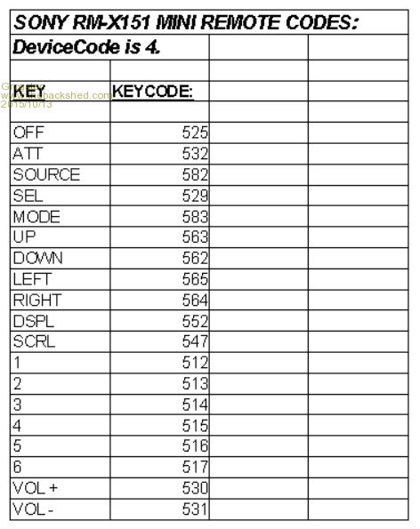

My dinky Sony remotes arrived today, so I immediately hooked up a TSOP4840 to a MM, and ran the test code to find the codes.
I post this chart here, for anyone else to use, should they wish to use this remote.
