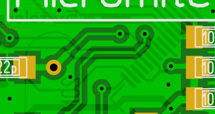

@ Jim - Supervisory chip has no cap on the MCLR line, so you can program the 470 fine with it in place. The Skinnymite has one of those 130's, and I was able to program it just fine.
@ TZA - Like this?:
Posted: 11:24pm 05 Sep 2015
Yes. It is one of the last steps i always do when adding a copper pour.
Often moving a few vias can make a big difference.

Also could you inform we what via/trace and space sizes you are using. I am about to prepare some to send to the same pcb manufacturer and on their site it is not that clear.
Edited by TZAdvantage 2015-09-07
Posted: 02:14am 06 Sep 2015
Hi TZA.
Re. PTC - Yeah, you make good points on all fronts there. I think I will just drop it. There is an area around the PTC, so that if/when it trips, it can properly heat up without the copper pour sucking away its heat.
Having said that, yeah, I think we can drop the PTC, actually.
What are other members' opinions of that and the reasons behind?
On the specs, they have tab on the page - scroll down a little, and click on the "PCB Capabilities" tab - all their specs are listed there.
As to what I use, I am using 0.2mm tracks, 0.4mm ground-plane spacing, and the vias are 0.7mm OD, 0.3mm ID. 0.3mm is the minimum drill size for SH2U. The fatter tracks are 0.6mm except for the one feeding the ICSP and SD card socket, which are 0.5mm

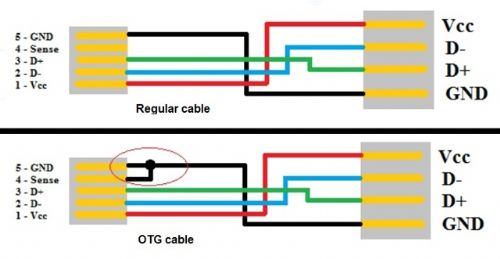

this just jogged my memory - is the pin between D+ and GND on the USB connector not used to sense an OTG (on-the-go, reversed master/slave) cable:
(from: http://tech.firstpost.com/news-analysis/how-to-make-your-own-usb-otg-cable-for-an-android-smartphone-29503.html
you might wish to route this sense pin to an input pin on the MX470, and use that to sense when an external USB keyboard is plugged in. at the same time you could replace the diode with a MOSFET (with internal bypass diode) that when turned on would route power out the USB port. all this would consume 2 i/o pins on the MX470.

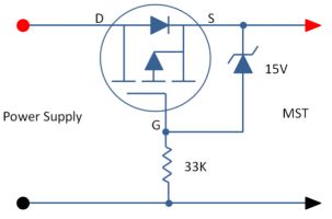

further reflection. the MOSFET should be wired up like this:
(from: http://www.ozqrp.com/rev_pol.html )
the zener diode and 33k resistor are not necessary, D goes to USB socket V+, S goes to 3v3 regulator input, G goes to the USB sense pin directly. there should be a 10k or so pullup from G to S.
when power is fed into the USB socket (from a host PC), the diode in the MOSFET will conduct. but the MOSFET will not switch on, as the gate is pulled high by the 10k.
when the 'sense' pin is tied low by the OTG cable, the MOSFET will conduct, allowing power to flow in the reverse direction, from E64 board back into the attached keyboard.
retaining the existing (external) diode may be desirable, as it my have a lower forward voltage drop than the one in the MOSFET.
rob :-)
Posted: 02:21am 07 Sep 2015
yes - a P-channel MOSFET. because it would be a rather small device and low currents are involved, the -5v gate voltage should suffice.
