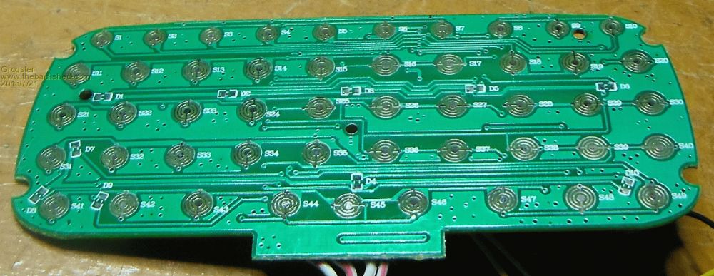

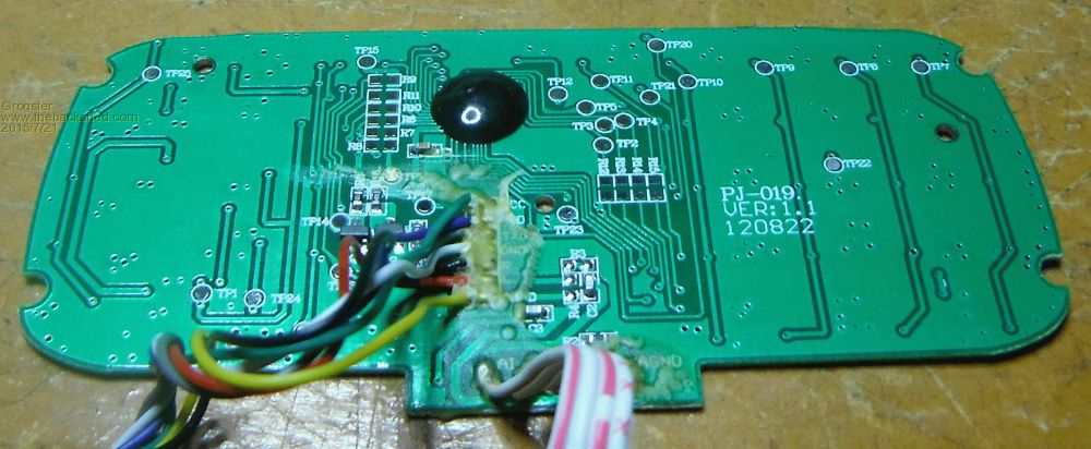

Chinese eBay ChatPad:
I am going to have a go at working out the matrix wiring, so that then we could just grind off the chip and it's protective black epoxy blob, and hook into the matrix directly, and couple to a nice MM controlled replacement.
Something else to play with.
EDIT: I have been unable to get any kind of serial output from this unit at all. It is possible it is a factory dud, but no MM circuit sees any valid serial, and the logic analyser also sees not a thing. I have ripped all the wires off, and I will grind the chip out of the equation, so we just have a keyboard matrix, then I will design a dinky SSOP board to slide in there and interface with the matrix - so long as I can work out the matrix.
I have been trying to find any info on the matrix used in the chatpad, but have so far found nothing. If anyone has any links.....Edited by Grogster 2015-07-22

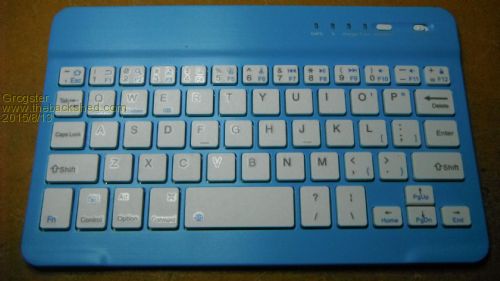

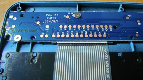

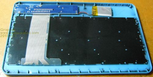

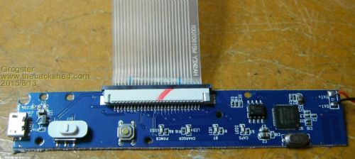

UPDATE: My little blue units arrived at last. Here are some shots:
Rob is correct - the backplate on these things is about as flimsy as one of those tin oven dishes. Screws holding the back on are about 1mm in length, and one of the two units I got, had five screws missing, and one more fell out when unpacking, so we definetly need some sort of hardware improvement there.
On the plus side, the keyboard itself seems to be s standard looking matrix, and there are even nice little test pads on the PCB, so I can probe the matrix to find what key is where. I have had a look on the web for the HASKEY part number, but cannot find anything. Further down the ribbon, there is the marking: "PRIDE-K1311 VER:B", so I will also look for that too.
It would be quite easy to grind and file a small slice of 3mm aluminium to replace the bottom, and give back the rigidity to the board as a whole. I think I would just use zinc or stainless countersunk machine screws from the top of the keyboard, and use small rubber feet to keep it off the table on the bottom - a work in progress...
EDIT: Forum has squished these images a little, but you can see the gist of it. I have high-res close-up images if anyone wants to see them. Let me know if that is the case, and I can link to a ZIP file.
EDIT: Control chip is AIROHA AB1112A, which directly interfaces to the matrix. Looking for datasheet - does not appear to be available from their site. Not sure the data sheet will be much help as far as the matrix is concerned, as this device has a PROGRAMMABLE matrix up to 8x18, so it could likely be just about anything.
I am not going to waste too much time on datasheet searches - I plan to hook up one of WW's 44 pin MM modules an write a matrix scanning code, to allow me to decode the matrix.Edited by Grogster 2015-08-14

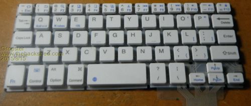

Posted: 05:12pm 14 Aug 2015
UPDATE: Here is a photo of the keyboard membrane once removed from the plastic case by drilling out the melted plastic locating dowels:
The keys themselves, the rubber springs, the membrane and the black plastic backplate are all one unit, so it is not easy to remove them - I will leave well enough alone.
I will remove the matching connector from the PCB, then hook up some link wires so I can run tests to establish which key is where.
That done, I will design a PCB consisting of a MM(I think the 44 will have enough pins, failing that, the 64 MM+) to interface to the keyboard, and output serial. This will all be released on the forums, so others can copy from it, if they wish to. Code would not be the most efficent in the world, but other members would be free to develop better code for driving the thing, and perhaps even adding the VT100 commands to the serial stream - who knows. The latter would be extremely useful, as then this keyboard project could be directly connected to the MM console.
