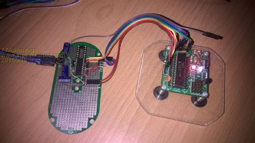

The PIC16F1455 memory use is 550 bytes RAM out of 1024 bytes and 4736 bytes of Program Flash out of 8192 bytes.
It also functions as a USB to Serial.
Currently i have it for test purposes waiting maximum 20 seconds for ten '>' characters after it is plugged into the USB port. My preferred use would be to use the DTR to switch between modes. So if DTR is asserted and 10 '>' are seen within 2 seconds it switches to Programmer mode, if not then it defaults to USB to serial.
Using the DTR keeps all the pins free, and no more need to remove the USB cable and reset the comport.
Here it is connected with Mick's MUP. Now your PIC32 chips can be programmed through USB without a bootloader.
As you can see power, serial and ICSP are all wired and no more need to take out these cables. When using MMEdit you can use the DTR to reset the uMite. The USBtoSerial will stay connected so you will not loose connection anymore when you have to reset.
Here is the code. I added a few functions to keep it more in line with the Arduino code. Manipulating the pins directly instead through a function might increase the speed a bit. But honestly. If i not have to start MPIDE,load the hex file, choose the right options etc it is already much faster.

Posted: 11:15am 19 Sep 2015
@Rob,
Would it be possible for you to pulse the DTR?
I think the best place is here:
[code]
// Serial port now open and configured.
//Pulse DTR (10ms is more than long enough)
//Pause for 50 milliseconds.
printf (" Adapter: ");
[/code]
Maybe for backward compatibility only use DTR when a -UseDTR is added to the command line. If it has no effect on the Nano then that would not be necessary.
And if i may ask. I would very much appreciate if you could add the ProductID.
I now use the same string as the Nano but that does not feel right.
The ProductID is "MicroBlocks - U2SPxxx"
The code stands for
U - USB
2 - to
S - Serial
P - Programmer
the 'xxx' are for future additions, in use now is U2SP5a. I am working on a U2SPH5a.
The 'H' stands for HID and the '5' for 500ma version. The 5 could also be replaced by a 1 (125ma) or a 2(250ma) depending on which voltage regulator is needed.
The last 'a' is the version.
As long as it starts with 'U2SP' it will have the ascii ICSP function available.
Edited by TZAdvantage 2015-09-20

If I may ask a couple of questions or suggestions:
Are you allocating the same or different pins for PGC/PGD and Tx/Rx ?
I ask because it would be nice if both the ICSP and the Serial Connections could be permanently connected. If they were then the PGC/PGD lines could be made High Impedance after programming to free up the target device pins.
Secondly Have you, or would you be able to, add an LED or two to indicate traffic?
An LED to indicate Tx and Rx could do dual duty and Indicate programming in progress and a pass/fail indication.
I will Flash a 16F1455 with your code and start playing with it tomorrow, (after the F1 Race ).
Do you have a HEX file available, it would save some time ?
If not I will finaly have to cave in to Microchip, jump through the hoops and install MPLABX it will be worth it now that I have a valid reason though, and I would probably need it for CFunctions too, so not a waist of effort I guess.
Chris

Posted: 07:26pm 19 Sep 2015
yes that version is a bit faster.
[code]
C:\Users\mail\Dropbox\Micro Blocks\Projects\BreadBoard\U2SP5\Software\pic32prog>
pic32prog -d ascii:com4 mm.hex
Programmer for Microchip PIC32 microcontrollers, Version 2.0.BETA (30-08-2015)
Copyright: (C) 2011-2015 Serge Vakulenko
(ascii ICSP coded by Robert Rozee)
Adapter: .......... OK1 OK2 - ascii ICSP v1E
Processor: MX170F256B
Flash memory: 256 kbytes
Boot memory: 3 kbytes
Data: 258712 bytes
Erase: (110mS) done
Loading PE: 1 2 3 4 (LDR) 5 6 7a (PE) 7b 8 v0301
Program flash: ################################################# done
Program boot: ####### done
Verify flash: ################################################# done
Verify boot: ####### done
Program rate: 1950 bytes per second
total TDI/TMS pairs sent = 3304781 pairs
total TDO bits received = 606728 bits
total ascii codes sent = 1043405
total ascii codes recv = 208592
maximum continuous write = 911 chars
O/S serial writes = 100150
O/S serial reads (data) = 18970
O/S serial reads (sync) = 5
XferFastData count = 58606
10mS delays (E/X/R) = 11/0/0
elapsed programming time = 2m 14s
[/code]
I have updated the code with your changes.
I first thought it was a Product Identifier, but indeed it is a Protocol Version.
Now that i have got it working i can tweak the code for speed.
Edited by TZAdvantage 2015-09-21
Posted: 09:43pm 19 Sep 2015
Ok after tweaking the code a bit i got this:
[code]
Data: 258712 bytes
Erase: (110mS) done
Program rate: 3609 bytes per second
total TDI/TMS pairs sent = 3480383 pairs
total TDO bits received = 758600 bits
total ascii codes sent = 1105103
total ascii codes recv = 260798
O/S serial writes = 104896
O/S serial reads (data) = 23716
elapsed programming time = 1m 12s
[/code]
Not bad for burning the latest beta30 into a PIC32MX170 in 1 minute 12 seconds.
I think i can shave off a few seconds more. The main change is that i now use port A4 and A5 which have internal pullups. I can now connect a MUP without any extra parts. After programming is finished the A4,A5 and C3 pins which are connected to the ICSP pins PGC,PGD and #MCLR return to inputs with high impedance so they should not influence the normal use of the pins on the target.
This is still with the FREE XC8 compiler in MPLAB-X.
Memory usage is now 550 bytes RAM and 4544 bytes Flash.
