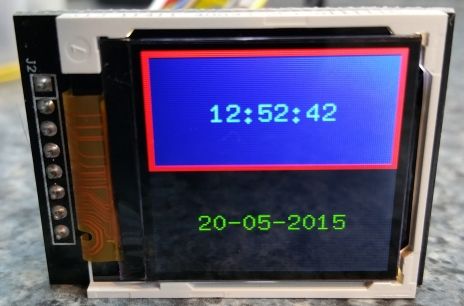

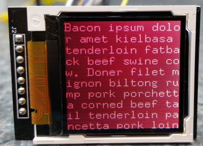

Tested on 1.44" ILI9163 display:

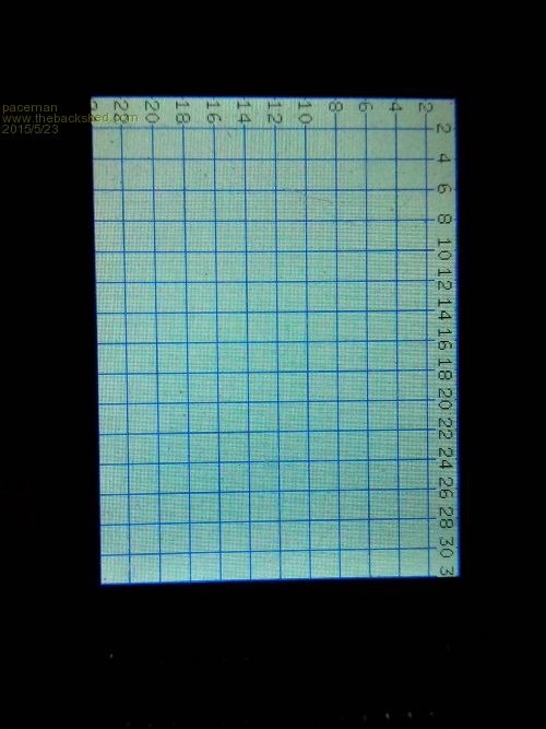

My question is, is there a simple means of determining where something is going to live on the screen, I have thought of a sheet of graph paper or just suck it and see as I have been doing.
Cliff
Cliff
paceman
Joined: 07/10/2011
Posted: 08:39pm 22 May 2015
Something like this Cliff? BTW that's the 2.4" screen, not graph paper
OPTION EXPLICIT
DIM INTEGER i
CLS rgb(white)
FOR i=0 TO 240 STEP 20
LINE 0,i,320,i,,rgb(blue)
text 2,i,STR$(i/10),m,,,rgb(black),rgb(white)
NEXT
FOR i=0 TO 320 STEP 20
LINE i,0,i,240,,rgb(blue)
text i,2,STR$(i/10),c,,,rgb(black),rgb(white)
NEXT
Edited by paceman 2015-05-24

paceman
Thanks for the graph paper works ok had to change it a bit as I am using PORTRAIT mode.
GM
I dont know what (HRS,2) is but the STR$ function works ok.
It is used in the "weather" above and in paceman "graph paper" no problem.
Or are you to close to the edge to display big characters.
There is no error message if you are outside the 240X320.
cliffEdited by centrex 2015-05-24

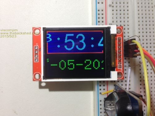

I am having an issue with the 1.8" ST7735 display. I am running beta 3.
OPTION LCDPANEL ST7735, L, 2, 4
OPTION EXPLICIT
CONST DBLUE = RGB(0,0,128)
COLOUR RGB(GREEN), RGB(BLACK)
FONT 1, 3
BOX 0, 0, MM.HRES-1, MM.VRES/2, 3, RGB(RED), DBLUE
RTC GETTIME
DO
TEXT MM.HRES/2, MM.VRES/4, TIME$, CM, 2, 1, RGB(CYAN), DBLUE
TEXT MM.HRES/2, MM.VRES*3/4, DATE$, CM
LOOP
'X = MM.HRES
'Y = MM.VRES
'PRINT X,Y
My display draws the box correctly but the text is very large as shown...
when I do the mm.hres and mm.vres it shows 160 x 128

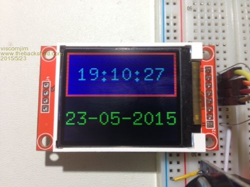

EDIT...
I guess I should play with the font command and report back. DUH!
EDIT 2...
Yep! RTFM Jim. Here is new code for smaller display...
OPTION EXPLICIT
FONT 1, 2
RTC GETTIME
DO
TEXT MM.HRES/2, MM.VRES/4, TIME$, CM, 1, 2, RGB(CYAN), DBLUE
LOOP
'X = MM.HRES
'Y = MM.VRES
'PRINT X,Y
and result...
Edited by viscomjim 2015-05-24
