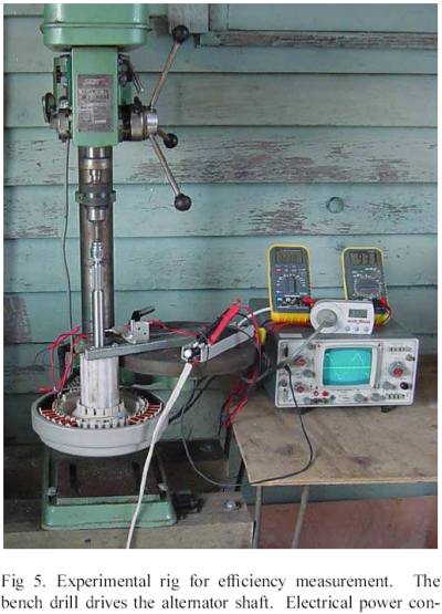

I see the CRO output voltage waveform on the last pic and Digital RMS meters. Not a bad sine wave, not real good to try and put into a battery though. The only time current can flow is when mill volts > batt volts. If you are measuring RMS V and A then you are seriously under-estimating the real peak V & A. I can not begin to predict the outcome with cheaper metering.
I also notice the use of a SparOmeter power meter. I have one of these. They under or over estimate depending on the power factor of the load.
Has anyone looked at the current waveform with a CRO for a Cap v non Cap system into a battery.

what has wrong with this thread? Is it me or are all the posts running over past the edge of the screen. A bit tiring with the mouse on the scroll bar. Gizmo, can it be fixed ??
cheers, Gordon.
become more energy aware
Posts: 5200
Posted: 11:43pm 20 Oct 2007
  Quote  what has wrong with this thread? Is it me or are all the posts running over past the edge of the screen.
Its caused by large images, you can blame 9c12m for it Sorry 9c12m, dont mean to pick on ya.

HI All I would suggest the picture of Glens F and P in a drill press has not got caps on it. Therefore get a 80s F and P , do the standard rewire 80sp put the caps on exactly as shown and then criticize.

to be fair on Gizmo, the photo was lifted from a research paper and is not his mill. The gen is another mod of a F&P, 100S with half of the stator fingers removed. This leaves 3 phases with 7 coils in series.

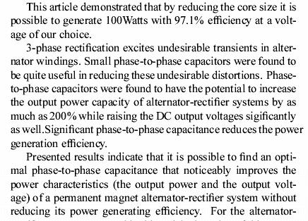

Hi FandPwithPVC,
here is the section from the conclusions on the last page of Dr Chalko's paper.
This was the confirmation of your experimental results from another source.
cheers, Gordon.
