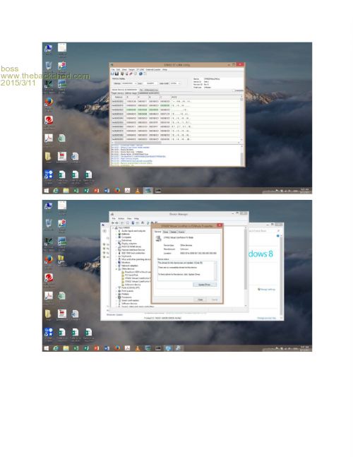

ST-link works like charm now on the same comp with virgin 8.1 installation.
Problems persist with virtual driver.

Joined: 19/08/2011
Posts: 268
Posted: 11:27am 11 Mar 2015
Works fine now on W 8.1 FW b12.
Bo

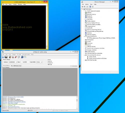

Posted: 11:57am 11 Mar 2015
Just tried B12 exactly same sysptoms:-
All looks OK but no message on TT (com5) see below
A couple observations:-
The erase seems to work now. Tried the boot0 to VDD link and then an erase.
A reset of the STM32 shows com5 being disconnected and reconnected.
A compare of the hex file and STM32 flash memory are identical.
The cable used seems OK - Used to connect my phone to my PC and reset shows the connection.

Posted: 01:07pm 11 Mar 2015
I'd be interested to see the results of following dmasz's post above - I have had to jump through stupid loops to get CERTAIN things working in windoze 8, by making those changes so that you can install unsigned drivers. This seems to be a Windoze 8 issue, and not something that is a problem in earlier windoze 7.
It's a pain in the arse to do, and involves a couple of reboots just to enable installing unsigned drivers and to get back to the desktop proper again, but it did seem to work for me.
I suspect that the trouble started for Bizzie, when windoze did that update. The forced signed drivers thing must has been part of the update, thus - the mess you have now where anything unsigned is blocked by the OS.

Posted: 10:55pm 11 Mar 2015
I have finally got the STM32 working over USB!
I followed dmasz's instructions but had to repeat the last step several times, not sure why.
I also used an account with admin privileges instead of giving the admin password, of course I do not know if this was essential or not.
I will now have a play with the beast.
