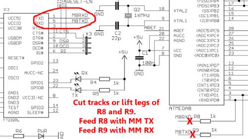

The Duem... module has an onboard FT232RL chip for its USB interface so you should be able to isolate the TTL out put from the FT232RL chip to the CPU and feed the CPU directly with the TTL output of the Maximite
Looking at this circuit:
Duemilanove cct
And this section
Either cut the tracks as shown with red X or lift the legs of R8 and R9 that go to the FT232RL chip (circled) and feed these lifted legs with the Maximite RX/TX (TTL level) pins.
Note, you may need to go to the otherside of R8 due to MM only being 3v3.. try it
Of course you will need a GND connection as well.
MickEdited by bigmik 2015-02-11

Posted: 09:33pm 09 Feb 2015
Amazing, 24hrs later and we have lots more input
Going back to my last post, we need to link the MM and Arduino directly via a serial connection. Thanks to Mick we can now see that no Arduino code needs changing (which was your fear) as the serial connections for the Arduino that we require are available with the aid of a soldering iron.
Not 100% convinced you need to cut tracks though. Personally I would just solder a wire onto the MBTXD resistor for now - see below . . .
One word of warning - IF you do have the version of unit as in Mick's post, you can't necessarily go by the PCB silkscreen on your unit and look for R9 (ignore the other signal - R8, as I don't think you need it). IF your unit is a 'clone' then there is a very good chance that the required resistor (R9 in the circuit diagram) will be labelled as something else on your unit.
So with your unit, I would go to the FTDI chip (FT232RL or similar - assuming it has one!!) and follow back from Pin 5 ensuring it passes through a resistor (the ones labelled R9 in the circuit diagram above). Make sure that the track traces back to the Atmega to Pin 3 as a sense check.
Then the FTDI pin 5 (MBTXD in circuit diagram) I would simply solder a small wire onto the FTDI side of the resistor.
All of this is just to ensure you have the correct connection from the Arduino (the Arduino Tx line). This is then connected to the MM COM1 Rx line.
Finally take a ground from each unit and simply connect together - result is just two interconnections JOB DONE
Please don't think this is too much hard work - it is easy, no tracks are cut, and it will result in what you wanted.

bigmik is right in concept, I agree.
Maybe the way to get one's brain around it is to think that it's the PC that needs USB because it hasn't got a serial port. Neither the MM nor Arduino need USB except due to the PC so to connect 'em together you want to bypass the USB parts.
I think you may need to cut tracks / remove USB-serial chips because to drive serial-serial between the 2 boards you don't want to be fighting whatever level the USB-serial chips are outputting.
If you'd had a 'mite with a USB-serial that was off board and an Arduino likewise then this would be so simple - just connect the 'mite to Arduino leaving the off board USB-serial devices disconnected (or plugged into the PC doing nothing).
(You'd have to worry about the Arduino being 5V logic and 'mite 3V3 but the series resistor previously mentioned is enough to let the 'mite cope.)

Posted: 10:13pm 09 Feb 2015
ERROR
In my last two posts I made the 'too early in the morning 'error that data was going from Arduino to MM; this is NOT the case, it is going from MM to Arduino.
There is still no need to cut tracks - just need Tx from MM connected to the MBRXD signal (as shown in the circuit diagram) connected to what is shown as R8 (connected on the Atmega side of R8.
Still take all the precautions mentioned above to ensure you get the correct resistor on your module . . .
SORRY for the confusion guys.
