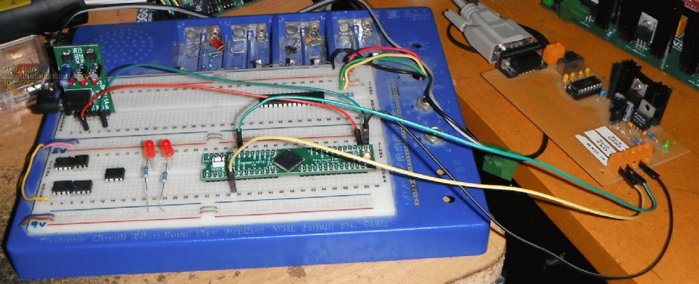

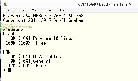

UPDATE: Everything seems to work OK on the prototype board:
If I can get it going OK, I am confident that others getting boards will also be able to.
NOW - on to some testing.........
EDIT: Basic testing(no pun intended!) at the default speed does not seem to show any issues, and I am now running the 470 @ 96MHz - again - there does not seem to be any issues that I can detect at the moment.Edited by Grogster 2015-02-23

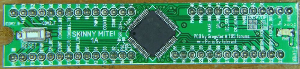

UPDATE: All PCB's ordered thus far, have been dispatched international airmail. You should have in 7-10 days.
I have prepared a ZIP file that anyone can download, which contains all the documents - GIF images of each layer, overlays, BOM, construction notes, and a schematic.
When I order 1B boards, there will be a new thread, with a new set of documents to reflect the changes.
SkinnyMite 1A documents ZIP file link. (3.2MB)
The description is an ODT file by default, and you will need the likes of Open-Office, Libre-Office or a reasonably recent version of Microsoft Word to be able to open this file. I have also included it as an RTF file, but the formatting is slightly different.

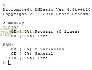

Posted: 12:27am 04 Mar 2015
Well I have passed soldering 101 for SMD 1206.

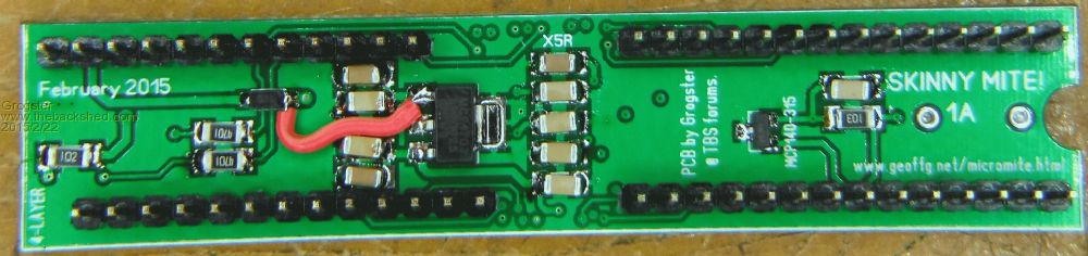

The soldering was easier than expected, but probably only because I had got a few things ready for it as suggested. The Gel Flux, magnifying light, tiny pair of tweezers and a new tip for the soldering iron.
I initially put the power LED on the wrong way,but once swapped around it was OK.
The LED had two small green marks at one end,so I though this was the pointy end, ie the Cathode. There is a small dot on the silkscreen, I assumed this would be the Cathode. Is there a convention for the placement of the dot and does it mean Anode?
The supervisor MCP130-315 is sometimes referred to as MCP140-315 (BOM, silkscreen) but the part I got based on the part no. was MCP130-315 and schematic refers to MCP130-315.
A neat little board.
Thanks Grogster.
Gerry
