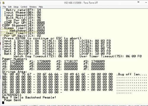

OK, another update for you all.
When I put a pager transmitter on this 107, as the 107 is an RS232 unit, and so is the pager transmitter, I can directly connect them, and I can talk to it fine.
NO ERRORS AT ALL.
So, the uM is not liking the module, or could it be that the 232-USB chip used on WW's 44-pin uM module, being still connected on the PCB, is upsetting things?

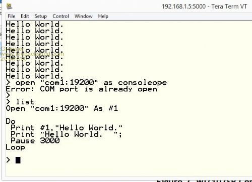

Connection to full size CMM seems to work fine.
The errors in this screenshot are cos my first test was "Hello World" as you can see, then I tried to open the com port as console without closing it, so it looks a little confusing there, but the MM is happily responding fine in both directions.
This is the CG CMM2, on COM1 for the purposes of testing.
I don't think that the CMM can go faster then 19k2, as both COM ports on the CMM are software driven - can't remember - will try some higher baud rates, and will probably get an error from MMBASIC if I exceed the maximum baud rate.
NOW I will hook up a standard 28 pin uM on a breadboard and hook that into the mix, as perhaps the USB chip on the 44 was upsetting the serial timing. Does not matter really, as it was a full size MM I was wanting to talk to on the net rather then a uM anyway - I just got my hands on a 44 before the MM board.Edited by Grogster 2014-07-31

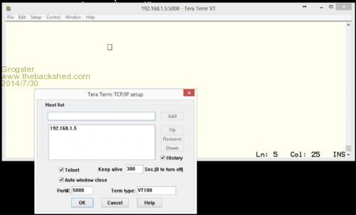

Hi there again.
Now that I have correct operation over the network fron TT to the MM, I started playing with other things. VT100 mode does not seem to work in TT via network. This is what I get when I type edit:
I included the TCP/IP window, so you can see that I had it set correctly for VT100.
EDIT: Nevermind - TT window too small. When I maximized the TT window, edit works, shows the code etc fine.

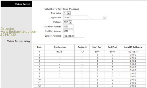

Posted: 03:17pm 29 Jul 2014
  TassyJim said  When you get to WAN, all that you need to do is port forward port 5000 to the module address.
Then you connect TT to your public IP port 5000 and it gets to the module.
If you don't have a fixed IP, you can use one of the DNS services.
This was from a post back on page 1 of this thread, but I am now ready to start doing this kind of stuff, now that the LAN side of things is working OK.
I follow you with respect to port-forwarding port 5000 in my ADSL router to the module's IP address - seems logical enough.

Posted: 03:39pm 29 Jul 2014
OK, I have HOPEFULLY setup port-forwarding correctly on my router - a TP-LINK unit, and according to the web and a few searches, TP-LINK now call forwarding Virtual Server.
This shot SHOULD allow port 5000 to be routed to the module from the WAN - correct?

Posted: 04:55pm 29 Jul 2014
SUCCESS!!!
I can talk to the MM from my workshop machine, via the Internet.
I CAN'T ping the IP or the IP+port, which is probably a good thing. I expect that the router is refusing the ping command from a WAN location.
But all up and running, and I am really pleased, and I have also taught myself some new technology, so all is good.

Posted: 05:02pm 29 Jul 2014
Getting there!
Re port forwarding.
Did you choose Telnet from a list or add a new server?
If you chose from a list, the modem might be forwarding external port 5000 to port 23
You may have to create a new server and call it anything you like. You should then have the option to set the destination port(s)
I much preferred modem/routers when they didn't try to be so 'helpful' and you could just enter the correct details.
Hopefully, you can use another internet connection to test the port forwarding. Some modems will let you address your external IP and do the forwarding correctly but others will not.

Posted: 05:10pm 29 Jul 2014
@ Jim - I named a new service - called it TEST, and selected TELNET. When I did that, TEST turned to TELNET, and APPLICATION became blank - I guess the router though it knows best? I will call my buddy, and see if I can get access to his PC for a few minutes to try that from another location, as you suggest.
