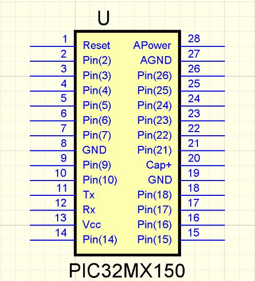

Lads, especially ViscomJim,
Thanks to WW's good (pigeon) eyesight, here is a, hopefully, corrected version of the Pic32MX150 28pin library part for use as a micromite (uM names have been used)
If there is anything else wrong I am going to give up.

Posted: 12:43pm 06 Jul 2014
Not bad Mick, but . . . . Pin 1 and Pin 11 have a leading space.
Please don't "give up" as I'm sure nobody else will notice!!

Posted: 01:13pm 06 Jul 2014
  WhiteWizzard said  Pin 1 and Pin 11 have a leading space.
WWeyes
Hey Pigeon eyes (must be full of pigeon DooDoo) that's the way DEX does their numbering...
The left hand column of pins are RIGHT justified the Right hand side are LEFT justified,
I cant change that one..
I will go and pour some more beer on my Corn Flakes now.,

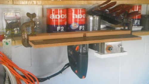

I made a PCB cutting jig out of the back of an old speaker box, and an electric jigsaw mounted upside down. A customwood(MDF) strip provides a lock, to stop the board moving up and down with the blade. This cuts up boards really quickly.
The little silver box on the underside at the right, is a speed control for the jigsaw, built into an old PC PSU case.
Once cut, the boards are then offered up to the disc sander, to clean up the edges.
Edited by Grogster 2014-07-08

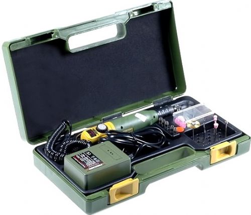

Hi WhiteWizzard,
I used my little PROXXON machine to separate your PCB's:
Frank

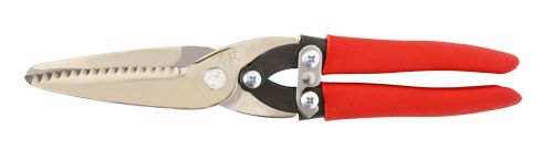

I use a sheet metal notcher. Slices boards like butter.
I use to put multiple small boards on one ExpressPCB $59 mini panel and cut them with this for cheap boards. I plan to do the same with ITEAD next time I need a batch.

Posted: 02:52pm 07 Jul 2014
Very clever - better then my upside-down jigsaw, and would be quicker too. How much did you pay for your metal notcher? Does this method not fracture the boards?
elproducts
Joined: 19/06/2011
Posts: 282
Posted: 06:21pm 07 Jul 2014
I paid $225 for it new 8 years ago.
The amount I've saved panelizing boards has more than paid for it.
I mark the board edges with silkscreen and then slice them apart.
They cut easily, no fracture. The edges come out straight and clean. A slight sanding if you want it smooth.
I've cut a lot of boards and never had a single issue.
www.elproducts.com

vasi
Joined: 23/03/2007
Location: Romania
Posts: 1697
Posted: 01:12am 08 Jul 2014
Someone says this is just perfect
Amazon link Edited by vasi 2014-07-09

vasi
Joined: 23/03/2007
Location: Romania
Posts: 1697
Posted: 01:20am 08 Jul 2014
As for me, I use a Proxxon tool.
with fiber discs (well, usually I use just a hand saw because the dust made by the proxxon is unbearable).
