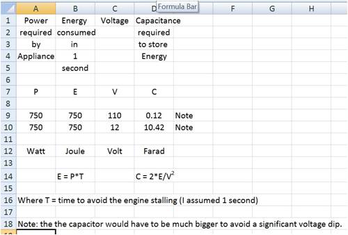

Robert,
A capacitor connected to DC is like a water tank.
You fill the capacitor with charge just like you fill a water tank with water.
Then the cap can discharge and do work of some kind. In your case, supply the energy necessary to supply the welder for a brief period in order to prevent the engine stalling.
Water flowing from a tank can do work such as turning a turbine to generate electric power, etc.
To continue the water analogy, a diode is equivalent to a one way valve. Water can flow one way, but not the other.
LenEdited by larny 2011-12-31

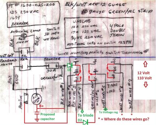

Robert,
I have attached a modified version of the circuit that was on page 24 of one of your .pdf docs.
I assume that this is what you have.
I have added 2 diodes to prevent reverse voltages causing damage.
D1 needs to be 63A rated.
D2 will only have to pass the field current so it can have a lower rating.
I initially added a D3 & then realised that it won't do anything, so I deleted it (as you can see near the breaker).
If you need to use a capacitor (ie. if the flywheel idea is not viable) then I'll add some simple circuitry to cope with the charging current, etc.
Len

Len, The wires 7 and 8 are not used and are tied back. Terminal 9 is not connected to any wires at all. For my alternator wires 3 and 6 are connected together. The engine I have is off a riding tractor and has a cast iron flywheel as do all small engines like from a lawn mower, roto tiller, etc. The pages in the PDF Len is the ones referring to the GM Delco 1 wire alternators. I believe it is pages 4 and 5 in my PDF. The only option I really have is a cap. I have several on hand, but would like to start with the 10 UF cap. I also have a 40 and 50 UF cap. I can also order as large as 60 UF from the surplus center on the cheap. I also want to confirm that installing a proper bleeder resistor on the cap will not cause any problems? This is to bleed the cap fast for changing out batteries to prevent any arching if the B+ cable touchs the frame. Can I also confirm that adding a MOV to the alternator from B+ stud to ground will not cause any problems? This is to arrest any spikes from loads being turned on and off that could harm the alternator diodes.
Len, you say the diode near the breaker needs to be a 63 amp? The breaker is only 30 Amp. Or is the diode supposed to be in wire 1 from B+?
Len, This system is not used for any kind of welding. I either charge batteries, or use 110 Volts DC for light construction or work around my property.
Len, Can you confirm your drawing will if used? Not cause any damage to the system, or interfere with how the switch works. 12 Volts in one mode and 110 in the other? I don't understand the diode in wire 3 and 6 where they are spliced together?
I know this must be getting tiring for everyone? But I really do appreciate the help as I am not a electronics expert, but a tinker like most of you guys on here. However I do know the basics and the dangers with DC vs AC and stuff like that. Circuit design is my weak point in this hobby.

  WindyMiller said   Len, The wires 7 and 8 are not used and are tied back. Terminal 9 is not connected to any wires at all. For my alternator wires 3 and 6 are connected together. The engine I have is off a riding tractor and has a cast iron flywheel as do all small engines like from a lawn mower, roto tiller, etc. The pages in the PDF Len is the ones referring to the GM Delco 1 wire alternators. I believe it is pages 4 and 5 in my PDF.
The only option I really have is a cap. I have several on hand, but would like to start with the 10 UF cap. I also have a 40 and 50 UF cap. I can also order as large as 60 UF from the surplus center on the cheap. I don't know how much capacitance you will need. It depends upon how much energy has to be stored. Even 60 uF seems too low to me.
I also want to confirm that installing a proper bleeder resistor on the cap will not cause any problems? This is to bleed the cap fast for changing out batteries to prevent any arching if the B+ cable touchs the frame. The only effect of a bleed resistor will be to put more load on the engine. However, as I said in a previous post, you could use a relay to disconnect the resistor while the system is operating so it is only switched in when it is necessary
Can I also confirm that adding a MOV to the alternator from B+ stud to ground will not cause any problems? This is to arrest any spikes from loads being turned on and off that could harm the alternator diodes. A MOV won't cause any problems, but my understanding is that they only last for a limited period. You could use a power outlet surge protector, they have MOVs inside.
Len, you say the diode near the breaker needs to be a 63 amp? The breaker is only 30 Amp. Or is the diode supposed to be in wire 1 from B+? I thought you said that the alternator can output 63 Amp. Besides, diode D1 is not in the breaker path. It is in the battery charging path. You said you want to protect against accidental battery reversal. However, note that D1 prevents the battery supplying the load if the alternator voltage reduces (or the engine stops). Is this what you want?
Len, This system is not used for any kind of welding. I thought you mentioned welding in one of your posts. I either charge batteries, or use 110 Volts DC for light construction or work around my property.
Len, Can you confirm your drawing will if used? Not cause any damage to the system, or interfere with how the switch works. The diodes won't cause any damage, but you need to think about the point I raised re D1 above. 12 Volts in one mode and 110 in the other? I don't understand the diode in wire 3 and 6 where they are spliced together? Diode D2 is to prevent damage to the voltage regulator if you accidentally reverse the battery.
I know this must be getting tiring for everyone? No problem But I really do appreciate the help as I am not a electronics expert, but a tinker like most of you guys on here. However I do know the basics and the dangers with DC vs AC and stuff like that. Circuit design is my weak point in this hobby.
Robert

Robert,
I had a look at the diode links. 1 & 2 are transorbs & not suitable. Also it appears that you have to buy more than one.
Diode 3 would be suitable for the D2 diode, but it appears that you have to buy 50.
However, I'm not sure if what I proposed is what you want, so I won't do any more until you answer my previous post.
PS old computer power supplies have high current diodes in them. So, if you can obtain one cheaply, you could possibly remove the diodes.

60UF too small? I can get my hands on a high voltage DC cap of around 5000UF if that would work? What do you think I should be on the lookout for? see the attachment
This is the game plan
1. The engine is a variable I cannot change right now.
2. I want to add a cap to stop the stalling issue which is caused by #1
3. My loads are battery charging, Power Inverter, Or heating elements, electric tools, lightbulbs. Welding maybe in the future if I can convince myself that if done with the proper gear is not as dangerous as was distilled in me growing up. Long story!
4. I know that 63 amps in 110 Volts DC the output is only 6 amps or there abouts. I can and will be rebuilding the alternator for 105 amps using new parts and the fan and back half of a 12SI as they have a superior cooling system than that of the old 10SI. This would give 16 amps in 110 Volts Mode. Note that - if the alternator can supply 63 Amp, then the diode D1 must be able to hanlde at least 63 Amp in case there is a short circuit or other heavy load. I know the engine would stall, but it may be too late for the diode by the time the alternator stops turning.
5. Someday I hope to find a 6HP 3200 to 3600 RPM engine to replace my old 1750 RPM engine of 30 years of age. Engines are expensive and rare around town so I would need to order one and have it shipped in.
6. Caps and diodes are cheap if you know where to look? I know some people who can help and I will be talking to them this weekend.
Robert
Roberet,
I have highlighted my questions in the quote in red so it is easy to see my text versus your's.
I also added the note re the 63 Amp in red.
I have attached some rough calculations on what size capacitor would be required.
Note that I did not include the contribtion of the alternator. but I think it is obvious that 60 uF would be next to useless.
I suggest you ask someone to check my calculations & assumptions.
Len

Robert,
I have been forgetting to make some points about the diodes.
If you connect diodes as shown in the drawing, this will introduce a voltage drop of 1 Volt or more - depending on the current.
This will not make much difference in the 110 Volt case, but it will in the 12 Volt case.
So I suggest you consider Schottky diodes in lieu of normal ones. These have a lower voltage drop, but there will be still some effect.
Diode D1 will prevent the issue that you raised regarding draining the battery in the 12 Volt case if something is left plugged into the outlet when the alternator is off.
Diode D2 will reduce the voltage at the voltage regulator. Is it possible to adjust the voltage regulator to compensate?
In other words, can you increase the voltage output from the alternator in order to account for the voltage drop across the diodes?
Len
