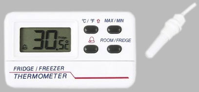

If you are looking for ways to spend the hard earned $
$15 each, very good value
only downside, it is possible to bump the buttons and be looking at the daily minimum or the room temp and not know unless you have a close look at the screen

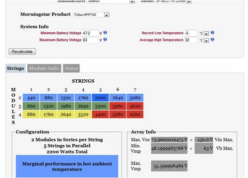

will be fascinated to hear what panels you use and how they will be wired to meet the 40 volt minimum criteria.edit (for the scc-2)
Morningstar Corp
morningstar string calculator
this is a mockup for a 48 Volt system, yellow is over volt, blue is under volt and red is over current.
Edited by yahoo2 2011-11-02
Yahoo ,I had to re-read that brochure before I finally found that statement, but I wonder if the 40v is for the 48 version. Will email them and ask the question.
I have not used the calculator before, but wonder if the aim is to achieve a Green line. Have to read and try it.
