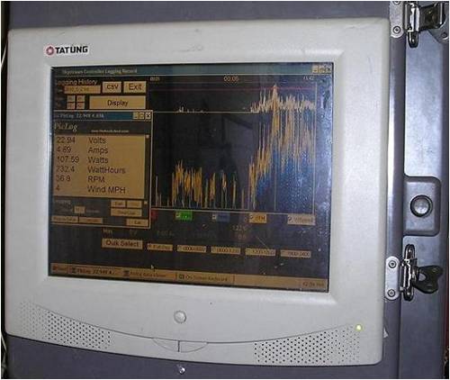

Re placement of graphs in the browser. All the graphs are the same time interval. I think it would be best for comparisons that all the graphs are the same width, and arranged vertically. Any additional graphs can then be easily added to as a list.
Until I get an anemometer, I am going to send out the RPM as windspeed. My windmill tracks the winspeed quite well, so this should be quite easy to calibrate. Will make better use of the graphs on screen as well.

I have modified Pete's piclog hardware, to measure the windmill rectified AC phase voltage, and AC phase current, so the windmill power is more accurately represented, similar to what would result from a GTI boost converter type windmill.
The voltage will range from 0-70V or so in my case. instead of the 51-53V as seen so far.
This mod will have impact on any users that wish to monitor the windmill with Pete's hardware as well. It would be best if the software was as universal as possible I think.
I hope a few more get to put their windmill/other systems online.

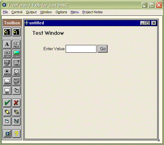

Just BASIC can be used to create forms like VB6, though its a more hands on approach. You can have several forms open at once, each doing their own thing, like this example...
There is a free program called FreeForm thats a GUI form designer for Just BASIC. FreeForm is even written in Just BASIC!
FreeForm will generate the code to copy/paste into your Just BASIC program. This code will create the form above.

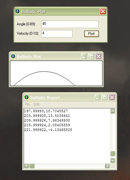

The more I play with the software the more I like it. I've writte a test program that receives PicLog data and sends it over the internet.

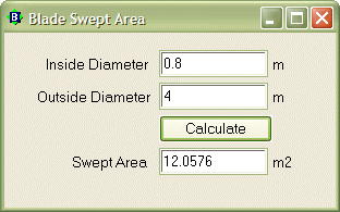

This is an example of a little program to calculate swept area. Very basic stuff at this stage.

produces this little app
Now for the harder stuff.
