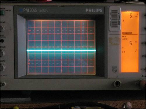

I took some photos of the voltages on the CRO for you to see and help to understand what is going on.
Firstly your meter will not read peak to peak of the wave and will give an average of the voltage.
For the photos i used a 12 volt rated transformer and as you will see the peak to peak voltages are much higher than this.
Each graduation from bottom to top of screen is 5 volts.

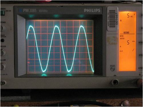

This is the straight 12 volt AC out of the transformer.
As you can see from the bottom of the wave to the top it is 35 volts peak to peak.

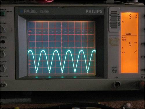

This is with a bridge full wave rectifier added.
Here you can see it is rectified but not a smooth DC output, and is about 17 volts peak to peak.
Remenber you meter can not read to the peaks, so you see and average of this.
