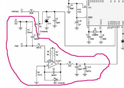

i did find this cct which seems to amplify a .01r shunt to match a pic chip
it seems to use a tc271 to match the shunt...dont know if this will work but i went ahead and ordered a few anyway
this is the pdf of the cct (its not overly big)....erm i,ll need to brush up on the Italian though...
2010-06-15_225001_mk3980.pdfEdited by niall1 2010-06-16

thanks for the replys and info ..the shunt is a bit on my brain at the moment...
there seems to be lots of variables and a knowledge of instrumentation electronics would help ...but thats beyond me........
i know it,d be better to buy an off the shelf shunt but i dont even know if the amp will work...
the opamp seems to be the crucial bit....not as much the shunt ?

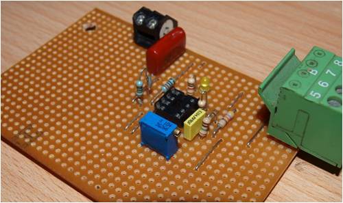

thanks again for all the input...i never thought a humble shunt could be so interesting ...i,m still waiting on the opamps to come so this post dosent contain as much as i,d like
i made up the/A very doubious Mv pre amp board in the meantime....
surprisingly what was actually a lot more interesting was putting a simple piece off stainless shunt on the batts ground and putting the multimeter across it ...never thought i would actually find a use for that Mv setting setting on the meter ....it is a lot off fun
but all the while the windmill seemed to be looking down saying ...do your worst , if i could care less i would...i guess it knows something i dont....
it usually does
Edited by niall1 2010-06-19
