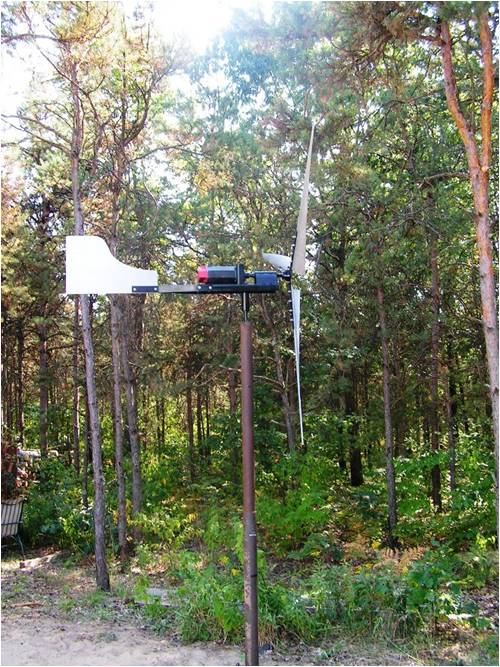

It's easy to get it to do this with
enough offset and a light tail.
It limits its output an keeps it safe.
97fishmt
Joined: 19/04/2010
Posts: 77
Posted: 05:01am 21 Apr 2010
But try and dial it in to
take advantage of the winds
power once you get close and
starting with a light tail to
have it look like this powering
through the storm and putting out power.

fish-
yea, i did 6" of offset for a 101" prop. about 6%. thinking about using bs-1088 okoume 4mm ply for the tail. it's light, bends really well, and is super good for the elements. i think i may even have to add weights for the tail to keep it from furling too early, but i guess time will tell.

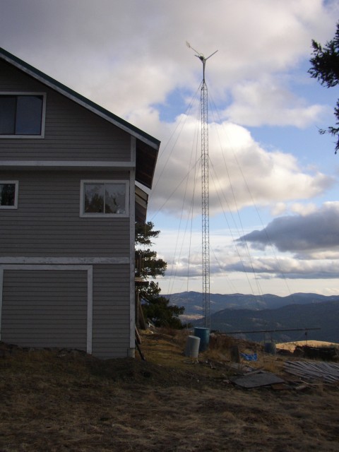

65 feet on the tower, it was a challenge because
I don't have any level ground. And make it a tilting
tower.
I was welding through the inverter from the batteries.
I brought up 12 2 volt cells to try them out and thought
I would put them through some abuse. Now they are all
hooked together and I think I need to have two banks.
I made it through the winter we'll see how it goes.

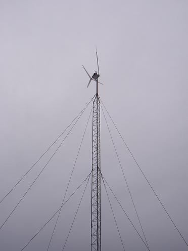

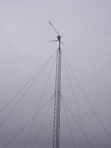

Hi 97fish,
You have some photos similar to my avatar. It is reassuring when the mill folds in half when designed to.
I see 5 wires from the top. I assume there are 4 steel guys, and possibly the AC feed line.
Unless the electricals have steel support built in, then the wire should be supported, and not just hanging, especially from 65'.
Gordon.
PS edit: AHah, I see another wire in other photo, so looks like is more guys still.
Edited by GWatPE 2010-04-22

Hi Gordon,
There are five 3/8" galvanized cables
at the top. One is for raising and
lowering the tower. It is hooked to
a hand winch, or boat winch. It's
used to ease the tower plumb when
going up and pull it over when going
down. I use a grip hoist with 7/16"
wire rope for raising and lowering.
The AC wires are three #1 copper wire,
the rigid stuff not multi-stranded,
going through a strain relief at the
motor and then through a kellems grip
and down the center of the tower.
I had the wire on hand. I may put larger
wire on it someday.
Actually there are six #6 copper wires
coming out of the motor ( 2 per phase)
and soldered to the larger copper wires
about 10' down the tower. I needed flexible
wire to get into the motor.
Thanks for your interest.
MikeEdited by 97fishmt 2010-05-07

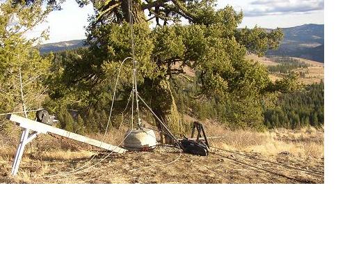

Hi Bryan,
Yes it is a Rohn 45G. I used the concrete base
pad and welded a 5' piece of 4" channel to it
http://www.anotherpower.com/gallery/mine
The gin pole is 30' of 3" schedule 40.
I could only haul 15 foot lengths so I
cut two 21' lengths down and welded them
together at the mountain with a sleeve inside
(2 1/2" with some pipe strapping for shim
material for a snug fit) and 3 1/2" outside.
I made the gin pole to fold down with the tower
so I didn't have to look at it when the tower is
down.
So using the grip hoist will pull up the gin pole
from laying on the tower up to vertical and into the
channel. I put a 3/4" bolt through the pole and the
channel. Then the gin pole pulls up the tower and it
stays horizontal when the tower is up. It works really slick!
Mike Edited by 97fishmt 2010-04-23

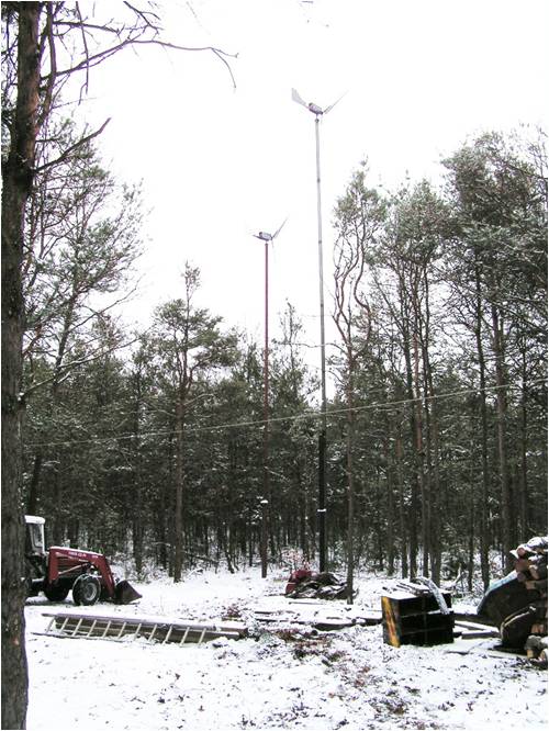

I have two Fanucs up and running for almost a year now. They work great.
The tag on the motor says 5amp. I get about 20A 12v (pumping into bridge rect)
@ about 150rpm and have seen 35amp with good wind gusts.
I is a injenear

dupa- we chatted quite a while back. that's amazing that you can get as much as 35 amps out of a 5 amp (rated) motor. i'm starting to wonder if the rated amps on the sticker of the fanucs is the amps per phase??
fanuc also makes some REALLY big DC servo motors. i've never seen one go for cheap though. they always have yellow cases rather than the red for the 3 phase ac units.
in fact you (dupa) are the only person i know of with a fanuc mill that's currently flying. this is making me want to finish mine asap!
birdhouse
