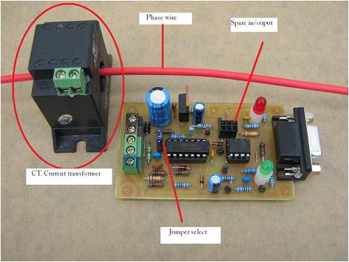

Logger progress report
With some further testing of the circuit by Gordon and myself we identified some minor problems that has taken some time to implicate a solution for, that involved many hours staring at wave forms on a cro to get it sorted, followed by a redesign on a already crammed little board to accommodate the changes.
I was aware of the low input voltage of the LM-7805 Vreg and it not suiting use in a 48v system so the reg has been upgraded to a 125v input capable HV-reg. ( TL-783 )
Problem 2 was a little harder, and resulted from using the CT for the RPM. No problem with it working, but it would only record RPM once current was flowing through the phase wires. Meaning any RPM before the batteries reached cut in voltage was not recorded as the CT will only produce an output when current is flowing through it and not before hand.
A design change was made to take RPM direct from a phase wire through a simple circuit so RPM can be read regardless of current flow.
This then set a problem of sync with the amp readings for use with monitoring mains voltage if used as a consumption recorder.
I added a 3 pin header so either mill RPM or mains Hz could be selected as a input sync and /or RPM or Hz reading by moving a jumper on the 3 pins.
With the addition of a phase sensor wire it has made this a 5 wire system from the previous 4 wire logger.
The extra wire is optional and will only give mill RPM below cut in.
I tested having the CT wired through a length of wire 20m long (what i had on a roll at the time) and got a change of 0.02 in the reading.
This would imply the CT can be mounted some distance from the monitoring circuit and function quite well.
Any loss in signal over distance can be compensated for in calibration.

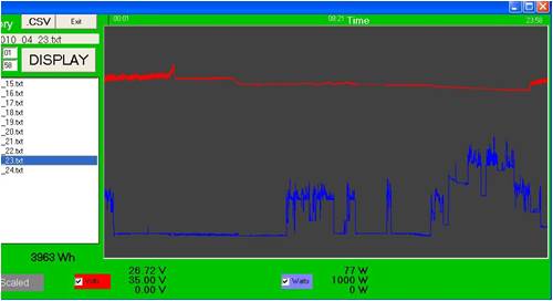

Gordon's developments of the on screen software is progressing well and is easy to use.
The displaying of graphs for recorded data is easy with some good user friendly functions.
Gizmo's on screen display has been retained with changes made to the graphing window and setup, along with some data error checking included.
At this point the software is still backwards compatible With Glenn's PicLog but not forward compatible.

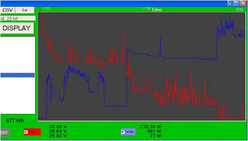

I have pretty well finished stage one. This is a revamp PicLog program, that now will be available as a self installing package, that will create all the necessary files, and folders, as well as a place on the "Windows" start bar menu system. This is a PC only application. The program in testing allows interactive selection of the logging port, the baud rate and system voltage. The program can recover the logging function following a change in baud rate, port, serial cable disconnection, and many forms of COMM errors. I have also improved the Excel data file generation to place the files in the Excel folder, instead of with the raw log files. The Zoom within Zoom has been enhanced, to avoid the need for a Display refresh between Zooming. The program creates the Excel and logs and html folders, if they don't exist. There will be a few more days of Beta testing. This will be a supplement to the original Piclog, so existing users will only need to copy their existing log files into the new logs folder, and these can be viewed and processed in the new program. Logged Files created with the new program are not backward compatible though, due to the file naming convention now adopted to place logged files in chronological order.
Edit:
The file was available for testing but is now on hold. it would be grateful if The readers whom have already downloaded, would be able to provide some feedback.
There still may be some bugs, and I have an error log system, should it be needed. Interest would be approciated before a version is released in an article. I am allowing a short period for some comments. It would be best to use the forum for this.
Gordon.

Well,
I can see by the enthusiastic responses that there is little interest in what is being offered.
Readers must have better systems that they are not prepared to share info on, on this forum.
This piclog is now in the form of a self extracting file, and requires little computer skills to get a working logger, with data graphing.
I can only assume that if readers don't have a better logging system, that they don't place much importance on logging.
I can say, that there are many large, expensive, commercially installed Off grid RE setups, that are coming to the end of the installer warranty period, that will need battery replacement. These are 1000-1500Ah 48V systems, with top shelf batteries. If these systems had some data logging, then deficiencies in the system, either solar RE, or windmill RE capaqcity, or Genset function, or battery performance, or load profile would be be picked up. We are talking about a low cost logging system to gather data to protect a high cost investment.
I can only deduce that readers do not fit into this RE setup category, and do not have any significant investment that is worth monitoring.
I do know that if an RE system is monitored for the first year, or even month, that problems to supply the loading, and battery recharging performance, that may have drastic long term impact on component life will be evident.
I hope that at least current users of a piclog, would be able to make some comments.
I will stop now before this becomes a RaNT.
Gordon.

Posted: 02:53pm 22 Apr 2010
I understand how frustrating it can be after you put all the time and work into something for the benefit of others to get little response or feed back.
I have found the same with the logger circuit board as well, but i am not going to give up and will see this project through.
With the hope that some will find the inspiration to give it a go, and then realize just how powerful of a little tool it really is.
To be able to sit back inside and review the day, weeks or even years performance of your mill that you spent the time to create is a very rewarding result.
It allows you to see exactly what any modifications or adjustments have made to the operation of the mill, and what further adjustments are needed.
As Gordon has said on the battery side alone it will indicate maintenance pending, and show over all battery performance.
This is not a daunting project, as between Gordon and myself we have endeavored to make this as easy as possible with self extracting software with almost auto logging, along with simple easy to construct circuitry.
There is really no programming or code required as the picaxe will be supplied pre programmed and other than making changes to add extras there is nothing to program.
All calibrations are done on the computer screen in the calibration window. Its as simple as clicking a mouse and typing a number in a box.
I was once a little reserved to having a go at logging to a computer with Gizmos logger, and once i tried it, found it only to easy.
Now we have taken his work a step forward and made it even easier with more built in functions and more stable.
Along with a circuit to suit that will be available in a kit form, so there is no problem accessing all the parts required or needing to producing a circuit board.
It should work on any windows based computer either through serial or USB.
I hope to have all the data together by next week to post on the circuit side of the project, as the circuit is finished and just need to compile the information to post to the forum in a article form.
Pete.

I have to add that this hardware component is purely a DC voltage sensor, an AC current sensor and an AC voltage sensor, with a spare port. There would be different logging apps for say a replacement piclog windmill app, and say an app for monitoring the performance of an RE home, battery and loading.
You do not need a windmill.
If you have AC power in your home, you can monitor it. You can monitor how much power your AC coupled solar is making for a lot lower cost than a manufacturers option. You could even monitor your fridge, or TV etc. Depending on the house wiring, an electrician may need to be consulted. An Electrician could incorporate the AC current sensor into a short AC extension lead, for appliance monitoring.

Are you able to show some graphs of the data obtained from the logging you mention on this meter for, say last Friday. You may want to show say the maximum power on each of the sensors, and at what time it occurred for example.
If you can, it would be interesting to show say for a 1 hour period, a graph of an interesting period of import, or export power.
Here are some graphs I recorded with this new logger app. The first is the inverter load to the house, and Terminal voltage of the Lithium Battery for the whole of Friday.
The next is a graph of a portion of this day from 5:30pm till 8:00pm. During this time, the battery was discharged approx 40%, and there was 0.67kW used. The max consumption was 490W, and the minimum was 77W. The battery terminal voltage fell from 26.6V down to 26.0V during this time.
This sort of data on a full sized home RE setup is invaluable.
