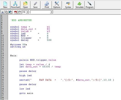

At a quick draft of a basic program i came up with this.
Its for a 08m picaxe.
Any points of view....ITs only a first draft and just raw data out.
Any conversion/calibration will be done in Piclog on the pc.
Pete.

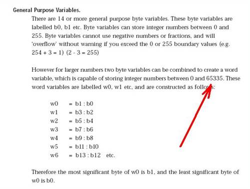

  Downwind said  Why do you choose 16 to divide the pulsin count by.
Do it relate to the pulses pre rev you have.
I would think 16 could be any figure, just curious why you choose 16.
Ps. i think you mean 65335 and not 65535 as well???
Hi Pete,
You need to get a number that fits the precision of the final reading you want. Remember that a picaxe can only perform integer maths. I wanted at least every 10RPM, at the lowest RPM, so 16 was the divisor. If I had chosen 128, then resolution would be compramized at the high rpm. 32 is probably the best, with 3 readings. This would give approx 1% across the RPM range. Hardly needed though.
BTW 2^16-1 is 65535.
Gordon.

Posted: 02:50pm 13 Mar 2010
Hi Gordon,
BTW 2^16-1 is 65535..........Ok i was thinking a Word-register will only handle 0 to 65335 so thought you had worked to that.
Pete.Edited by Downwind 2010-03-15

  Downwind said  ......Ok i was thinking a Word-register will only handle 0 to 65335 so thought you had worked to that..
Hi Pete,
I suppose you are referring to the text from the picaxe manual. I am afraid there is a mistake in the manual. I suppose this is a case of spell checking is not proof reading.
This could be the extract.
The number pointed to should be 65535

As you step through the program, make sure you select to display word variables. The register w0 will change from 65534 to 65535 to 0 and then to 1, as expected. This is normal integer maths.
I hope this clears up why I used the 2^16-1.
1111111111111111 in binary.
Gordon.

Posted: 02:04am 14 Mar 2010
Hi Gordon,
Correction noted.
I had thought 65335 was weird but had not over flowed a word register to check.
Its quite clear when you look at it in binary.
Thanks.
Pete.

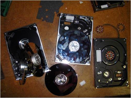

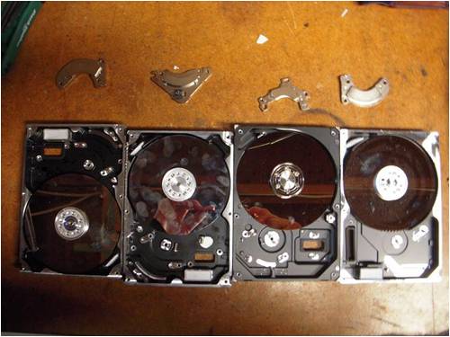

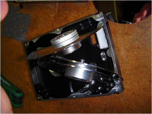

Been a busy weekend. Turned a carbon fiber bike into a bamboo bike, still working on it. I had company from out of town helping and took up my anemometer time. We are back on it full gas.
I have access to a lot of HDD parts, a company next to my work does data recovery. When they can't recover, I can get parts.
(big pictures...)
http://thegyre.org/imgs/anemometer/4_hdd.JPG
http://thegyre.org/imgs/anemometer/2level_vs1level.JPG
http://thegyre.org/imgs/anemometer/motor__s.out.JPG
I've left one completely intact in case I do anything terrible.
Some have are double deckers, others just have one level.
Also one has a bearing attached to a smaller post, and two others have fatter bearings sticking out of the bottom, I can take pictures. I am contemplating the best way to build a base for these. Maybe just route the bottom of the HDD housing in the shape I want?
Suggestions?

Posted: 01:10pm 15 Mar 2010
Back to the aneometer.... any or all HDD will suit your purpose.
There is little difference between each hdd except for the number of platters (discs) they have.
The cogging effect (or drag) that the the magnet causes is a problem.
I set up a rough test using the hdd motor for a pulse generator against the aneometer i built with no hdd magnet and just the photo interupter from a printer as a sensor.
The aneometer using the photo interupter will spin if a fairy farted and will record down to 0.1 kph easily.
The aneometer with the hdd motor as a signal generator needs above 6kph to start it turning and maybe not accurate till 10kph.
If all you are interested in is recording the higher wind speed and nothing in low speed than the hdd motor makes for an easy project.
To me it is a waste of time if the bottom end is not equally read to the top end of speed.
I would recommend you strip out the inner windings and steel core and use some form of pulse detector like a photo interupter or hall effect sensor to reading the hdd motor magnet.
This way it has no friction drag and makes use of the full advantage of the excellent bearings a hdd motor has.
As Gordon has surgested the use of larger cups will help with the use of the hdd motor as a signal generator. But from my testing it would need cups the size of breakfast bowls to make it work and then this would cause problems with higher speed.
Think it best to not use the hdd motor for a signal generator itself.
The hdd motor i used, was like the one you have that has a pin/shaft pressed into the housing.
I removed the pin and used a rod from the canon bj printer i ratted the photo interupter from, which happen to be 5mm dia the same as the pin in the hdd motor.
This gave me a long shaft for easy mounting.
If you can power the bike sensor with between 3-5v then we can use the same aneometer if you wish, to supply the picaxe with a pulse signal as well.

Played with anemometers tonight. I have two functional spinning platters that can be tinkered with. One i took and just made a basic conceptual (all tape etc..) anemometer just go through the motions and work out measuring kinks etc. Nothing on it is permanent so I can start the platter from scratch again.
the other platter is much more clean so far as spindle is concerned.
-kingw

Yes, gutted. The double platter spins just as you say, on a fairy fart.
The plumbing mounted one spins freely, but not quite as nice. I am inclined to use the double platter for the real project. My photo interrupter does not fit between the platters though.. maybe I can find a smaller one, or have it go over the two platters.
It is extremely reflective. I was thinking ruff it up and epoxy, however solder seems to be a quicker more permanent way to keep it aligned.
-kingw
Posted: 03:31am 16 Mar 2010
You may well find you can take the platters apart and change the spacings around as they are only held together with the washer on top.
