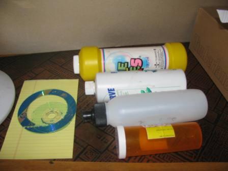

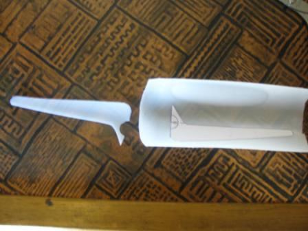

Posted: 01:39pm 26 Feb 2010

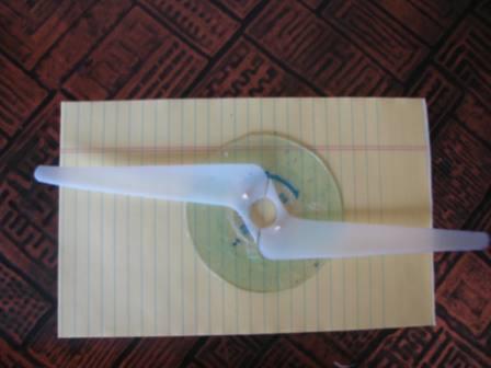

Here you have the pictures!!!

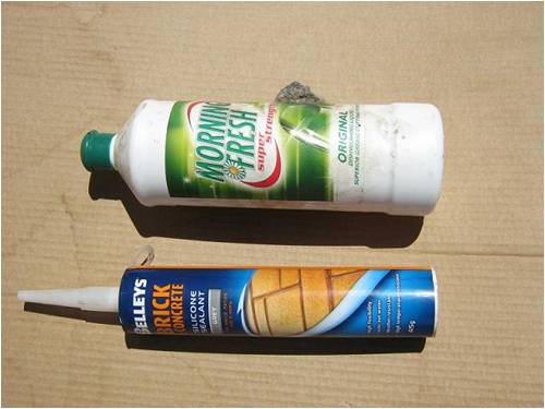

The first one is my wick try...& second one are the materials, the harder is the one that is clear brownish with the white cap. As you see everyone have different diameters… I’ll going to try with all and see.
See you later!
Gaby Muino

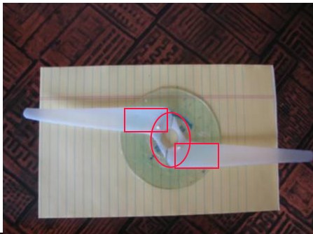

Posted: 02:59pm 26 Feb 2010
Your first attempt looks that you blades are upside down. or back to front or the wrong way around, but far from right.
You will soon see what i mean when you cut a blade out correctly as per the template.
Good to see you trying all the same.
Pete.

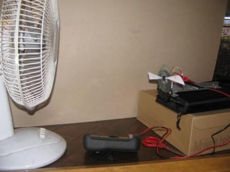

Posted: 04:54pm 26 Feb 2010
Hi Pete,

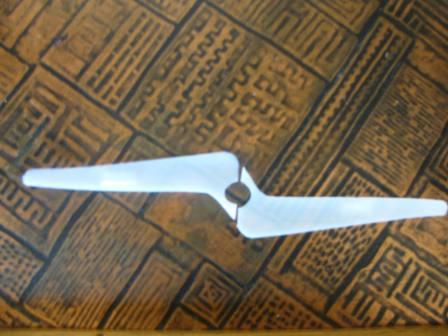

I'm finished with my first try… Ooopsss, the one that I sent to you from last nigh, I didn’t notice that I putted the blades upside down. I just turned off my computer for check.
Here you have some pictures… it’s working OK, but I’m having trouble with the starting!!! I have to help the windmill with my hand to start (I’m not allow to do that) the voltage that I have now is 0 mVDC at low and almost 300mVDC in high velocity .
I don’t know if I'm measuring correctly. I have the voltmeter In the side of the VDC in 2000m. I asked my teacher and he told me that it’s correct what do you think.
Last year score winer was 600
The distance between the fan and my CD that I’m using is 40 cm.
By the way I sent you the PM but I don't know how attached the pictures
Gaby Muino

Posted: 05:33pm 26 Feb 2010
Im not sure what the 2000m referers to on your meter but i would start off on a low volt setting like 2 volts or 20 volts.
Just remember there is 1000 mV to 1 volt.
So 0.300 volts = 300 mV.
The volt reading is taken with a meter probe attached to each wire off the motor.
You might want to reduce the cd disc size in the middle as this would be not helping startup.
A lot of the starting torque comes from the wider centre part of the blade and all that disc area will be preventing the airflow across the blade.
Get rid of it you dont need that.
The part of the blade where the centre line was must be flat down on the disc so the back edge cocks up in the air out towards the fan.
The centre line bit is the "leading " edge and must cut through the air, so if it is not flat than it will cause drag and work poorly.
Try to trim the disc down like this and keep the red bits. Loose the rest.

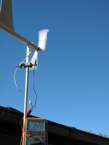

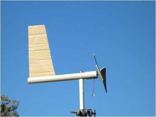

For testing today i mounted my generator up like a mini mill so it could piviot with a tail and this lets it track the wind better.
What is noticeable is how the turbulance makes the mill hunt in the air stream.
My set up was quick and rough it involved a bit of pvc pipe that i put a saw cut in, to slide a chunk of cardboard into (the cardboard i just ripped off a box)
Drilled a hole through the pipe for a piviot point.
Then cut a smaller length of pvc pipe and cut it length wise to make a snap around clamp to hold the motor on.
Bunged it ontop of a stand and that was it.
You could try the cardboard tube out of a roll of lunch wrap to experiment with to mount the generator up as a mini mill.
There is a lot to learn by doing this setup as you will notice how the mill tracks the air flow and will not always sit face on to the fan, but by moving the mill left and right and up and down you will see the changes that will teach you a lot about placement of the mill.
It also lets the mill hunt left and right and in doing so makes startup easier.
The size of the tail fin and the weight of the tail will effect things to. I needed to add some weight to the tail to dampen the hunting effect.(i just shoved a bolt up the tube end for weight)
I also found it easier to gauge some results outside in a light breeze as it was not effected as much from turbulance.
Its a matter of finding what works best with the generator and then how to get the best out of it with the fan air flow.

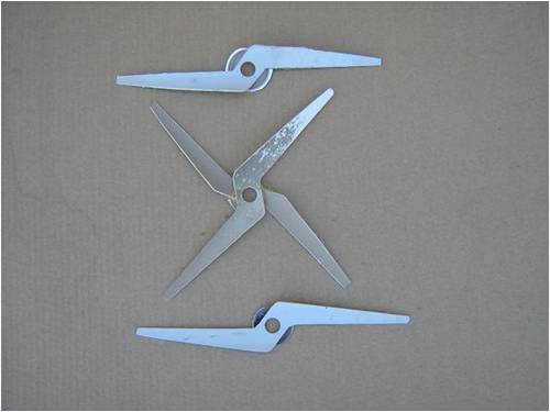

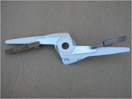

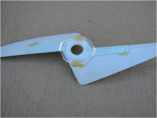

Heres some photos of my dodgie setup and a few rough blades i tried.

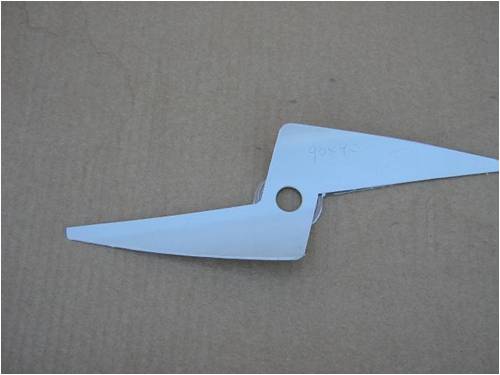

Do you see here what i mean about the centre line needs to be flat with the disc as i am using 2 pegs to clamp the disc to the blade for gluing.(pegs right on the very edge)
Also the shape of the disc after a serious cut down.
As an overall proformer this blade worked best.
It was cut from a section of 90mm dia pvc pipe and is 90mm wide across the centre.
I used the template and measured 45mm each side of centre line across the centre, then drew a line out to the tip of the template.
The meter is reading volts and here we have 1400mV or 1.4 volts in a light to medium breeze.
It did hit over 2 volts in a light gust.
Useing the fan at 2 meters away i got around 0.7 volts average with periods of 1.2 volts when the turblance settled down.
You will need the generator mounted so there is little behind it to effect the air flow past the blades (i noticed in a previous photo you had it on top of some books.....This is a No,No.)
Even the pole it is mounted on will cause a wind shadow.
You need to understand its all the little bits that add up and effect preformance.
If you think you can make 1 set of blades and get outstanding results first up you will be kidding yourself or very lucky.
We often say to newbies wanting to build a big mill to build a mini mill and learn from it, and i must say i have learn a lot more from the few tests i have done here.
To some it might seem a waste of time but it is cheap and very informative.
Although the cost of CD's and beer is adding up.
Pete.
