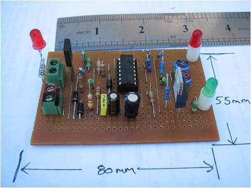

Posted: 03:14am 13 Feb 2010
Bob, i would like to see a pic of your work.
I dont think George will get confused knowing it is your layout.
You must find the circuit very practical to be on your 4th one now.
By all means post some pin voltages as it will help to answer some others questions to.
Think i will still build one as its only a 15 minute circuit to construct and i have all the bits handy except the 8 volt reg.
That way i have something to cross check others results against too.
Pete.

Posted: 03:37am 13 Feb 2010
Welcome adonis; I'm still trying to get my head wrapped around this op amp also.
@ Pete I'll get some new pics and data from this one first of the week, I just had to relocate the 100k on this board so its changed from my current pics but should be ready to smoke test. Looks like a busy weekend here or I'd do it sooner.
Bob

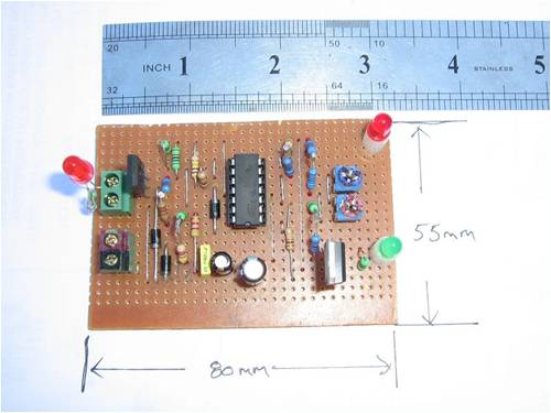

Posted: 07:45am 14 Feb 2010
This had all got the better of me and started to feel it was going around in circles.
With who is right and who is wrong and what works and what dont........................???????
So i constructed the circuit as per how Glenn has shown with the vero board layout hole for hole.
One important thing to note i did not have a 8 volt reg so i used a 9 volt reg and adjusted a couple of resistor values to bring the voltages back within the operating range.
The circuit worked fine!!!!!!!!!!!!!!!!!!!
The red trimmer is the high V, and the blue trimmer is the low V.
The help with the discussion on threash hold voltages i will list the opamp pin voltages for my circuit but as i am using a 9 volt reg and the pin voltages might be different to others circuits with a 8 volt reg.
[code]
12.15 volts supply
pin volts
1 1.32 OP1
2 3.42 -
3 2.89 +
4 9.00
5 2.88 +
6 2.89 -
7 1.47 OP2
8 1.37 OP3
9 1.47 -
10 1.25 +
11 0.00
12 1.37 +
13 4.05 -
14 1.23 OP4
15.00 volts supply
pin volts
1 8.20 OP1
2 3.42 -
3 3.41 +
4 9.00
5 2.88 +
6 3.41 -
7 1.32 OP2
8 6.90 OP3
9 1.32 -
10 6.24 +
11 0.00
12 6.90 +
13 4.05 -
14 7.44 OP4
[/code]
Note the vero board layout is slightly different to schematic.
The actual circuit pinout are as follows.
The high V opamp is OP1 (pin 1,2,3)
The low V opamp is OP2 (pin 5,6,7)
opamp 3/4 is OP3 (pin 8,9,10)
opamp 4/4 is OP4 (pin 12,13,14)
Also the schematic shows a 12K resistor as R1 and the vero board shows a 10K resistor as R1.
I found i needed a 10K resistor as R1 to get the circuit to work in my case.
Pete.Edited by Downwind 2010-02-16
