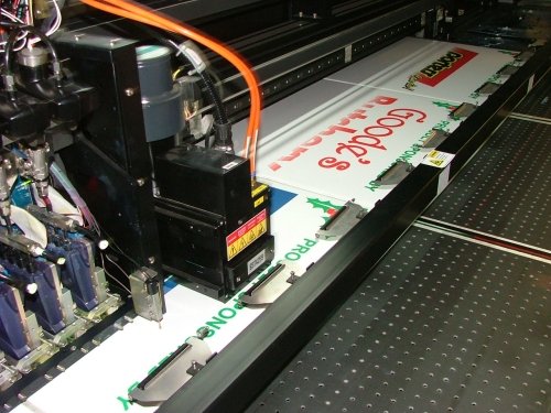

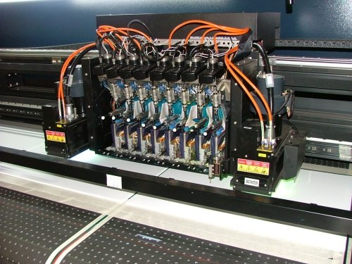

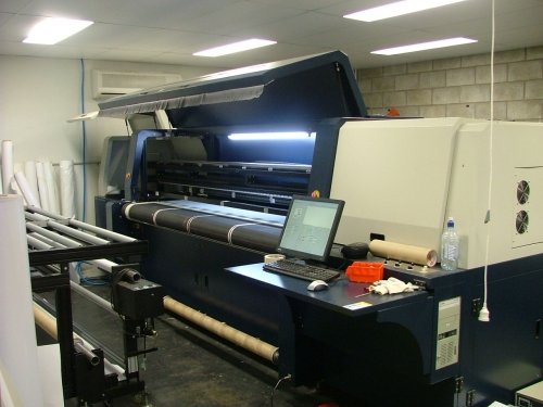

Speaking of UV lights and printers, this is a photo of a printer I use at work.
It can print on media 2.5 meters wide, and uses UV cured ink. Its mostly used for printing "for sale" corflute signs for the local realestate businesses.
The head, showing the separate ink heads and a UV lamp at each end.
And here are a few corflutes being printed for a local Christmas fair.
The printer will print onto any surface, and the ink dries as soon as the UV lamp has passed over. I'm tempted to see how it goes at printing circuit boards.

Thanks for the photos - a most impressive printer. It makes my A1 size plotter look like a midget!!
What ink does it use? - if its available it might be worth experimenting with in the Epson provided its viscosity is low enough and it turns out to be etch proof - hope you give it a try.
Also, is it water based or organic solvent? (Sorry, lots of questions)

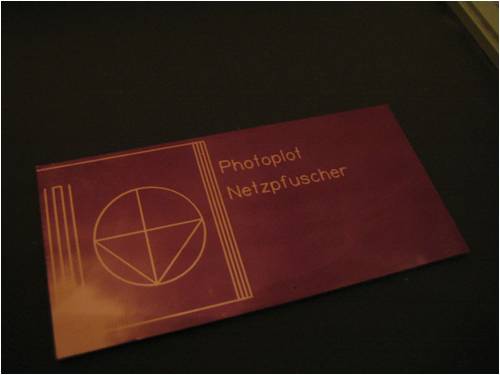

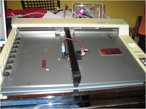

Whilst reading another forum (with some cool toys - it added a few new projects on the to-do list, such as a building an induction bearing heater: http://4hv.org/e107_plugins/forum/forum_viewtopic.php?74994; also came upon some very familiar names in that forum, LOL) I stumbled upon this:
http://4hv.org/e107_plugins/forum/forum_viewtopic.php?66471
They're using a flatbed plotter with laserdiode for directly plotting the PCB traces in the photosensitive layer:
Interesting idea that is, hadn't thought of that yet. And you probably don't need a BlueRay laser, an UV LED with proper optics to focus it into a small spot may work too.
Have recently built a laserdiode driver for an IR laser diode (out of an old 24x CD burner), should work for driving a BlueRay laser too:
Pity my only plotter (HP7550) isn't a flatbed one.
Using a BlueRay laser shouldn't work only with a flatbed plotter but also with a CNC mill. Interesting innovative solutions.

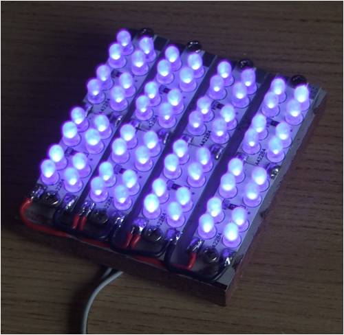

The UV LED modules arrived and I removed the Aluminium backing from each and assembled and wired them up on a piece of Masonite for a quick test.
At a distance of about 150mm they will cause a sample UV set polyester resin to gel in about 5 sec. After 30sec it has reached the hard gel stage, so I am very pleased with the results.
Now all I have to do is organize a 12v power supply capable of a couple of amps for use in the shed.

Posted: 06:18am 28 Nov 2009
Thats not a bad result in setting times, you would have to be pleased with that.
For around $10.00 its a good cheap option and much easier than building the boards yourself.

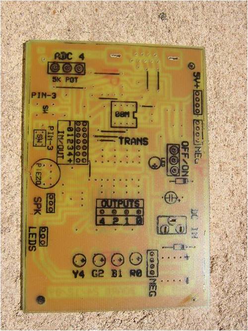

Posted: 05:13am 01 Jan 2010
I tried an idea to print some text and outlines of the silkscreen layer onto the top of the pcb.
Not a perfect result but ok for a quick attempt.
I first reversed the image on screen.
Printed it onto the waxy backing sheet you get stickers and lables on with a Laser Printer
I soldered some header pins into the mounting holes.
Aligned the header pins to the dots on the artwork and pressed down on top of a sheet of foam so the pins punched through the paper.
Flipped it over and with a clothes iron on the hot setting applied a gentle pressure over the back of the paper moving it gently around the board.
Wait for it to cool down and the paper peals away leaving the print behind.
The same can be done for the copper side to print the tracks etc onto the copper for etching.
It can be a bit tricky to get a good result, but if it dont work the first time than wipe the ink off with some acetone and start again.
Pete.Edited by Downwind 2010-01-02
