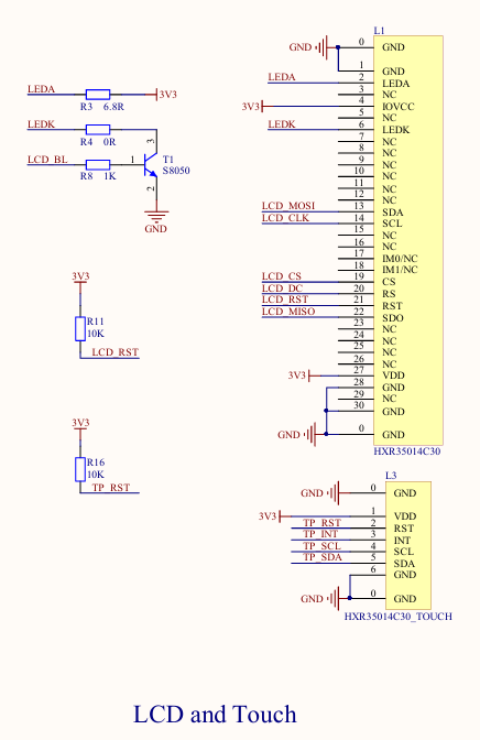

  Quote  The ST7796S controller does support reading from the framebuffer. Check the schematic for your screen and that GP16 is properly connected. You may be able to modify something to get MISO working.
here are some info...
is modification possible?
/Peter63

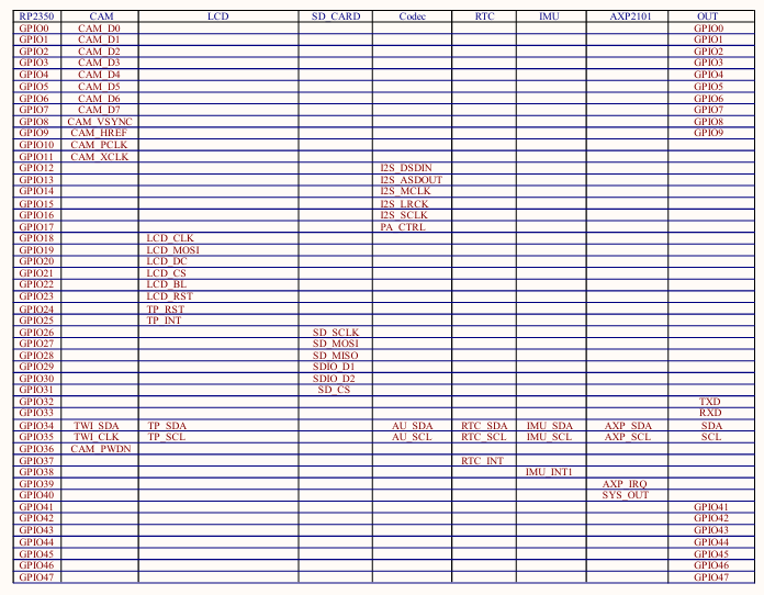

Posts: 3398
Posted: 08:22am 23 Sep 2026
In the table of RP2350 pins, LCD column, MISO is not assigned.
The display has SDO (MISO) shown but it does not appear to be connected to the RP2350.
Posts: 6151
Posted: 08:25am 23 Sep 2026
/Peter63
LCD_MISO is not connected to the pico.

I am also using a hw-config without MISO (data from display to cpu) connected. When using the cursor, MMBasic seems to read data from the display hardware via MISO, for whatever reason. If MISO is not connected, it is read as all ones and this results in a white patch. Tried it with MISO on the pico side tied to GND and the patch was black (all zero).
So the artefact is because MISO is internally used but not connected properly or not connected at all.

Precisely so, without miso nothing involving reading the display framebuffer can work. BLIT, transparent text, cursor and probably more
