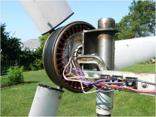

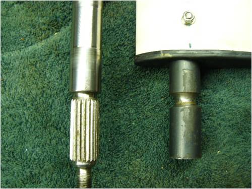

The minor diameters of the groves I machined in my blade stubs ares approximately .670 thousandth of an inch or 17mm.
The minor diameter of the grove machined in the F&P shaft that comes from the factory is approximately .710 thousands of an inch or lets say 20.2mm. I see a difference of 3.2mm. Lots of the mills that use F&P stators and shafts are being used to mount the entire hub and blade assembly not just one blade. The hub and blades on the F&P set up are fixed to the shaft (only) while my blades and hub are bolted to a 10 inch or 250mm cast iron drum.
I will have to agree with Gordon the survivability of any mill has to do with the entire assembly ie, tower, tail, balance etc.
montyLalor
Joined: 17/12/2008
Posts: 21
Posted: 03:47am 12 Aug 2009
Okay, but consider this: the F&P shafts are stainless; your blade bar looks to be cold-rolled bright mild. There immediately is a key difference.
Also, the hub groove on the F&P shaft is a point of rotational flex that will somewhat dampen the odd loads your mill will encounter, and yes, it will fail one day, but "choice" material selection has helped the OEM shaft to no end. It would have been a design compromise to make it easier to broach the spline at manufacture.
Conversely, your blade groove is constrained in predominately one direction, potentially leading to a fracture caused by long-term, semi-uni-directional fatigue. It won't break tomorrow, nor next month. The collision survival prooved this. But mild steel is called mild steel for a reason. Moreover, the 3.2mm (1/8") difference in the grooves you measured may not seem too much, but remember, it's not the groove's sizes you need to looking at and comparing, it's the percentage of bar removed to create the groove, and thus, the percentage of remainder cross-sectional area compared to the shaft's original diameter.
Your extended groove length at the smaller diameter when visually compared to the F&P shaft is, in my opinion, the greatest cause for concern, long term.

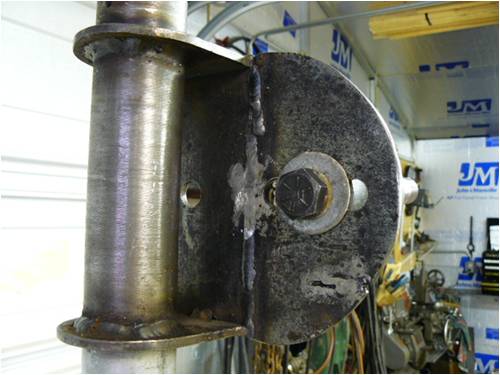

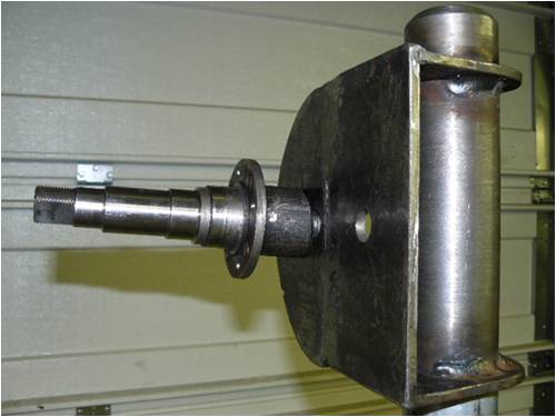

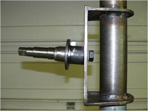

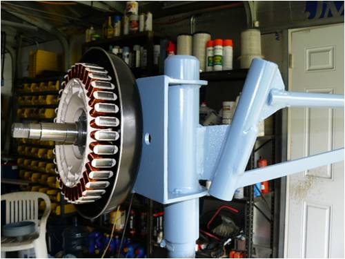

Off set, blade tilt.
Ok I think I may have something here. Adjustable off set at 76 mm, 101.5mm and 129mm.
Blade tilt at or around 4 degrees.
I machined the end of the spindle to get the tilt. Hopefully this may work for me.
Comments please.
GWatPE
Joined: 01/09/2006
Posts: 2127
Posted: 02:10am 18 Aug 2009
Hi Jim,
It may have been easier to slot the top brace, and reweld with the amount of angle. You will need to stop the stub axle from rotating now.
Gordon.
become more energy aware
oztules
Joined: 26/07/2007
Posts: 1686
Posted: 09:03am 18 Aug 2009
pin it
JimBo911
Joined: 26/03/2009
Posts: 262
Posted: 11:42am 18 Aug 2009

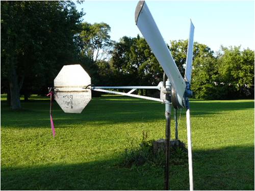

I know it's not the prettiest looken thing but hell who's going to see it close up when she finds her new home LOL.
Already started the tail pivot.

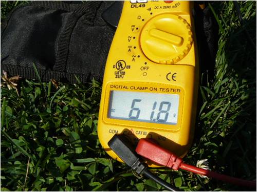

Woke up last Sunday to the sound of wind rustling the tress around, I couldn't stand it any longer so I set out to make my first electron. Made up a quick tail, installed the stator' called out my women and pulled up a couple of chairs. You should have seen us sitting there waiting for the voltage meter to display some numbers I think the neighbors where thinking (Dam I think those two are losing it). Well we did see voltage and better yet we got to see the CF bulb lite up. May not seem like much to some of you guys but to us it was a special day.

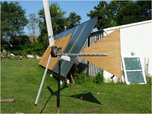

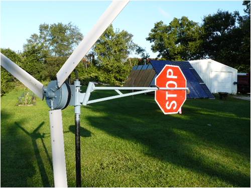

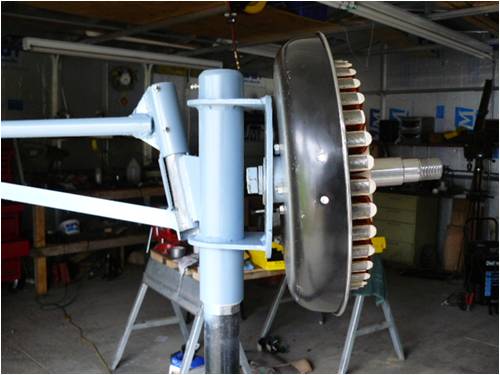

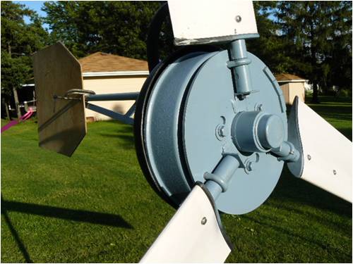

Posted: 01:06pm 30 Aug 2009

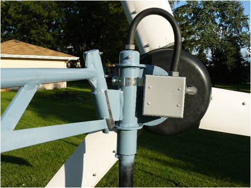

Completed more work on my mill here are the progress photos. My women and I where driving in the car yesterday when all of a sudden she hit the brakes(she was driving) and hung a quick u turn so I asked her what was that all about and she said I JUST FOUND OUR NEW TAIL FIN. I will also install a nose cone when possible.
Of course now that I am ready to start producing some juice (wind trials) there's no wind to be found. I had a difficult time figuring out a way of keeping the weather out of the stator but finally went to Wallmart and bought a saut'e pan to use as a backing plate/weather protection it will also provide cooing.

Hi Jim
That is all coming together very nicely , the good thing is you are putting some thought into the project to make it look good and neat, also be functional when it finnaly gets up , I see you trashed the stop sign in the last photo , a good looking tail and a nose cone will give the neighbours nothing to whinge about .. Keep up the good work
