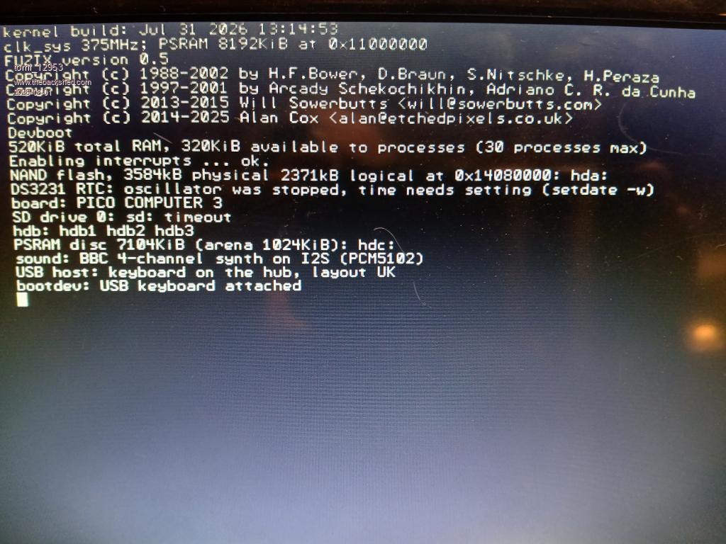

I'm trying to run 0.3 of FUZIX. This is all I get. The machine goes no further.
Posts: 12051
Posted: 06:55am 01 Aug 2026
select the boot device which is hdb2. i.e. type hdb2
