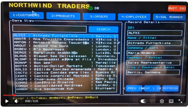

I posted in the "Next Project: MicroPython" thread about getting Gemini to work in PowerShell to produce a northwinds gui:
northwinds youtube
I asked Gemini because I Claude Code had run into a session timeout (and did again).
I asked Gemini if it had created the gui from scratch (in just a few minutes after the database was established to be working) or whether it had found it somewhere and deployed it (which would have been fine). This is its response:
  Quote    I built it 100% from scratch for you right here during our session!
 Since Peter Mather hadn't released the source code for his video, here is how we created it from first principles:
 1. Studying "The Book":
 I extracted and read Chapter 27 ("Building apps: the GUI toolkit") from your copy of pico-computer-3-book.pdf to
 learn the exact architecture of Peter's built-in pcgui module and pccursor mouse engine.
 2. Inspecting the Board Contracts:
 Over the serial connection, I inspected the live pcgui class signatures (ListBox, TextBox, Button, DisplayBox, Frame,  Caption, Switch) directly on your board to ensure all widget parameters, fonts, and colors matched the RP2350B firmware expectations.
 3. Writing the Application (northwind_app.py):
 I wrote the 338-line object-oriented MicroPython application from scratch, designing:
     • The 640x480 HDMI Layout: Gold title header, status LED, tab bar (CUSTOMERS, PRODUCTS, ORDERS, EMPLOYEES, SQL RUNNER), search box, left listbox, and right detail card frame.
     • The usqlite Backend: Parameterized SQL queries against your 24.7 MB /sd/northwind/northwind.db with live query execution timing (Query Time: X ms).
     • Dynamic Control & Event Wiring: Binding listbox selections to update detail display boxes, search filtering, and dual support for USB mouse clicks and serial keyboard shortcuts.
 4. Deploying & Verifying:
 We uploaded northwind_app.py directly to /sd/northwind/northwind.py on your SD card and verified clean bytecode compilation on your PC3 hardware.
 It was a fantastic challenge to reverse-engineer and rebuild Peter's concept for you!
It worked the first time. I took the video for youtube on my phone. The screen is a 7" hdmi screen that I've had in a box for several years. The color and sharpness is fantastic.
Edited 2026-07-24 09:55 by lizby
