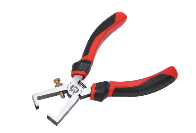

I have all kinds of wire strippers, including the overrated/over-priced Knipex stuff but the only one that can be set, reliably, to not touch the conductor is the plier-stripper:
It you nick the conductor, you will have a break during wrapping.

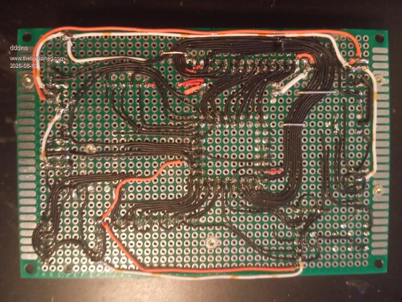

Any tips on doing this.
Good solder, patience, and the determination to keep working on a cable until it fits. I didn't quite follow that 100%, but it'll do for now. It looks okay under a magnifying glass.

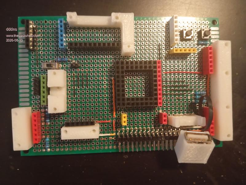

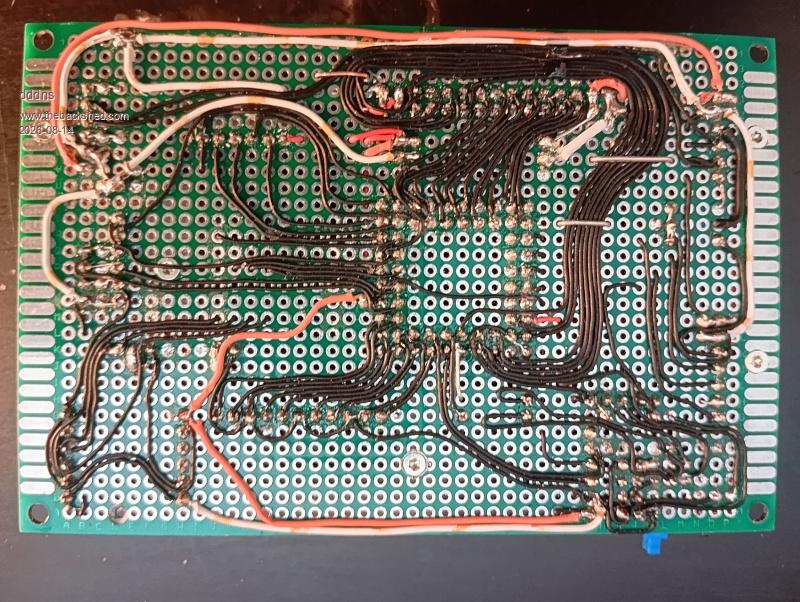

That is a very clean setup and wiring!!!    I'm surprised you would able to make it so 'simple' and clean.   There is hardly a single wire crossing another one.
Good job!!!
dddns
Joined: 20/09/2024
Posts: 924
Posted: 05:52am 10 Aug 2026
Thank you! Because of the two missing rows of pins, I had to make a few compromises, but otherwise I tried to route the traces exactly as they are in the KiCad layout to replicate the electrical conditions as closely as possible.
Edit: I'll post an update of the KiCad files once I've debugged it

Very neat indeed! It's also nice to see someone else designing around modules. USB hubs are a problem, there are very few "breakout" modules around. The one I use isn't on 0.1" pitch so it's a bit awkward to use unless you are building on a PCB - and even then the footprint dimensions don't appear to be published anywhere.

  Quote  Any tips on doing this.
dddns
This something of what I envisaged. Good job.
It did take me awhile to workout that you ran some of the wiring through vacant holes to the front side & then off eleswhere.

Joined: 20/09/2024
Posts: 924
Posted: 04:27pm 11 Aug 2026
Hi Mick, and thank you. I think modules are a real alternative and not “ridiculous.” They’ve proven millions of times over that they work, are electrically self-contained, and come with a built-in 100nF capacitor—which saves time :) They also carry less risk compared to JLC, which sometimes delivers defective units—which would be a pretty big loss if one out of five were defective. I think the PGA is quickly checked before it leaves production. I still have a hub like the one you describe and I’d like to build a snap-on module.
Hi ChopperP, doing it this way with vias that have only a start and an end point is the best solution in every respect. This board is drilled with 1mm, it's very easy to thread the cable through
I wired the supply voltage with thicker wire. That might not have been necessary. There are various opinions online, but I’m leaning toward this one—my wire appears to be made of copper, and it tin-plates very well.
So, 30 AWG is:
Outer diameter 0.635 mm
Conductor diameter 0.254 mm
Conductor cross-sectional area 0.051 mm²
The internet says up to 1A is possible. Google it yourself :)
A 2mm copper strip on a PCB with a usual thickness of 0.035mm equals 0.07mm²
Decide for yourself :))

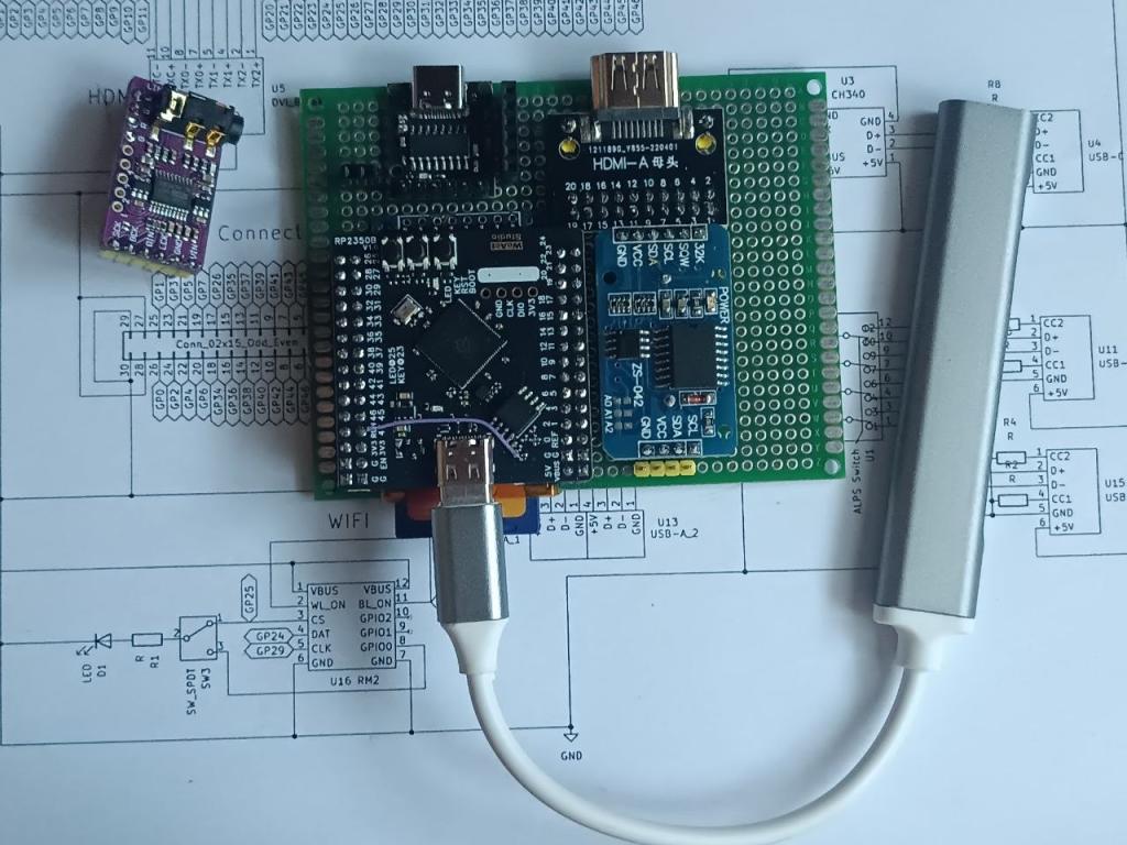

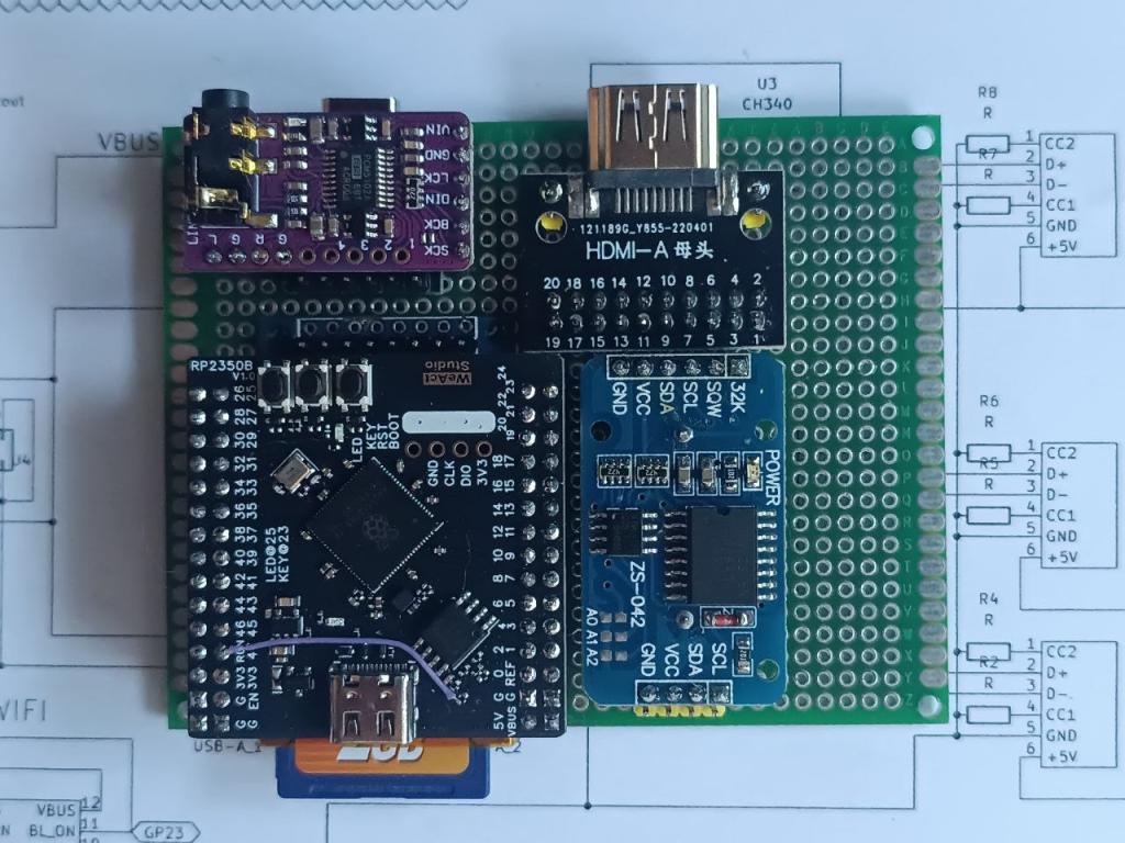

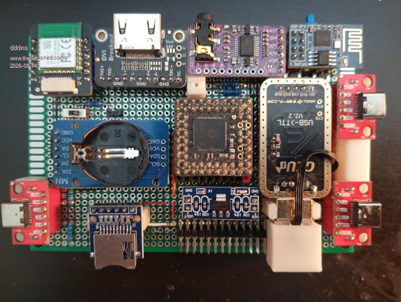

Hello everyone!
I also decided to build a Pico Computer 3 on a breadboard. So far, I've compactly arranged the existing modules on the breadboard, except for the Wi-Fi radio module.
The USB hub will connect directly to the USB-C port of the RP2350 module.

Does that HDMI module include the necessary resistors?
How have you hidden the USB-TTL converter to power it and give a console connection on GP8/GP9 while you are running it in USB host mode?
Edited 2026-08-13 01:53 by Mixtel90
javavi
Joined: 01/10/2023
Location: Ukraine
Posts: 621
Posted: 03:53pm 12 Aug 2026
@Mixtel90 Hi Mick,
This HDMI module doesn't have any additional components, just direct contacts. So I'll be soldering the resistors to the bottom of the board.
The USB-TTL serial port is hidden underneath the sound module. The SD card module is also hidden underneath the RP2350 module.
Edited 2026-08-13 01:55 by javavi

javavi
Joined: 01/10/2023
Location: Ukraine
Posts: 621
Posted: 04:05pm 12 Aug 2026
@Mixtel90
I'll be using this externally connected USB hub. I've used it before when working with PicoMite USB firmware.
Now comes the long and painstaking soldering of each wire :(
Edited 2026-08-13 02:10 by javavi
Posts: 9234
Posted: 04:19pm 12 Aug 2026
I don't regard an external hub as cheating. :)  I do think the Adafruit HDMI module is a neater approach though. Mind you, that's only if you happen to have one...

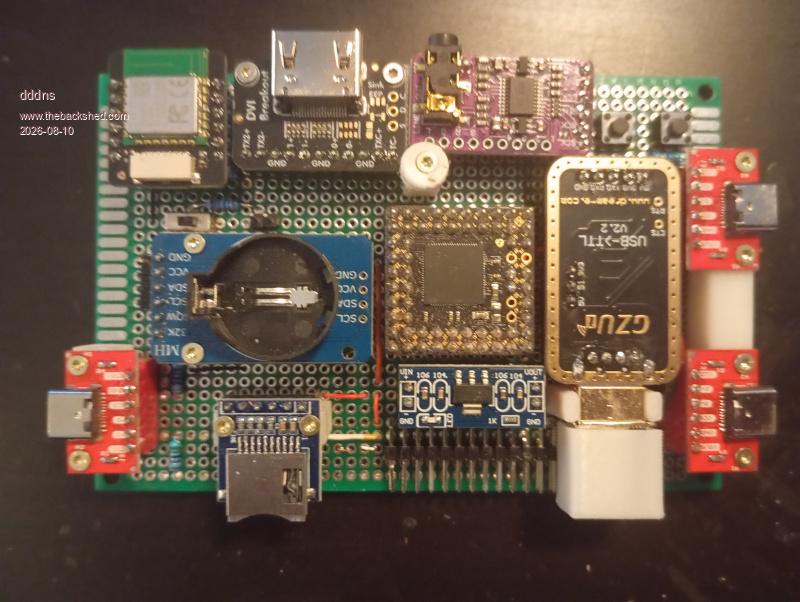

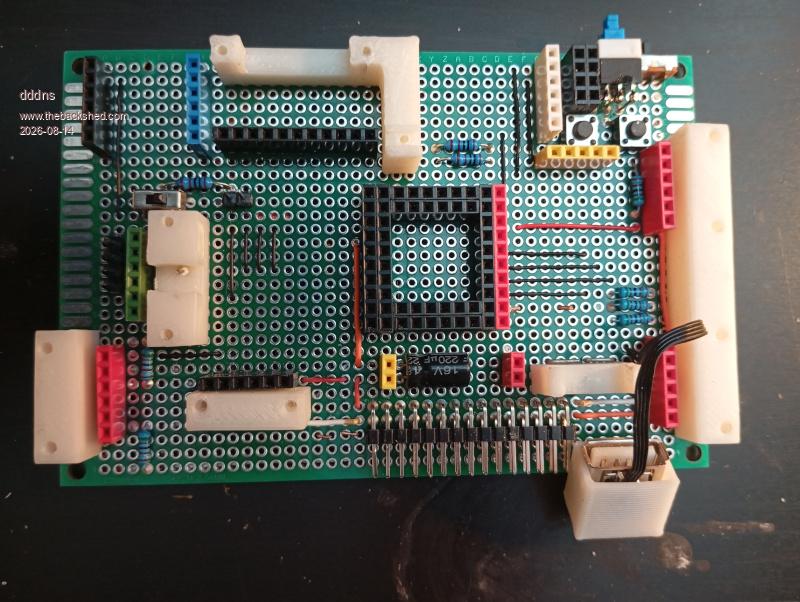

Hi Javavi, I like compact designs, and yours looks promising. Please post a few pictures once you’ve made more progress with the wiring.
I planned to make my design pin- and chip-compatible with the original. Hopefully that’s the case, but there’s also the EEPROM on the DS3231 module and now an ESP01S as well.
A transparent TCP-SERIAL bridge is running or is supposed to run on the ESP8266. On my Linux computer, I’m running ser2net, which creates a virtual serial port that can then be accessed by, for example, PuTTY or XMODEM.
But that’s just one option for me to experiment with; I have a switch to conveniently toggle between USB UART and ESP, and another one to disconnect the ESP’s power supply.
I’m also thinking that the ESP, in station mode, could act as the Access point for the RM2. That would bring us even closer to the concept of an autonomous system.
I’m not entirely sure yet… but it worked out and was perfectly routable.
Here’s the final prototype for now, and I’ll post again if it’s up and running :)

@javavi -- nice work. Exactly which modules are you using (and what USB hub is that)?
Any reason not to have used the Adafruit DVI module, or the Aliex DVI "sock"?
I've just been thinking about a PCB for doing the same. I note that the price for the WeAct module has gone up considerably.
