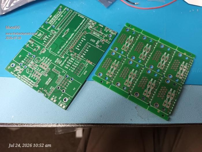

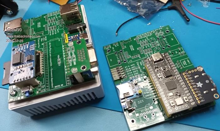

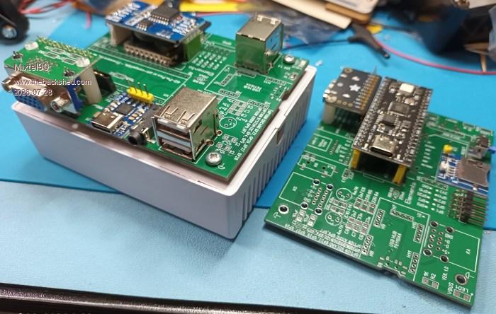

The boards (these big ones are faulty):
These are "dry run" pics, obviously, to see if bits will fit. They'll give you an idea of the variations that are possible though:
I've not shown the USB hub as I haven't got one to hand.
The RTC module is shown fitted inverted, as originally designed. In theory it just fails to fit inside the case if it plugs in with the battery on top. It could probably be "staked" down solid in some way to make it fit but that would make any access to the SD card socket impossible. Something to consider though, as modifying the RTC module is a bit of a pain.
