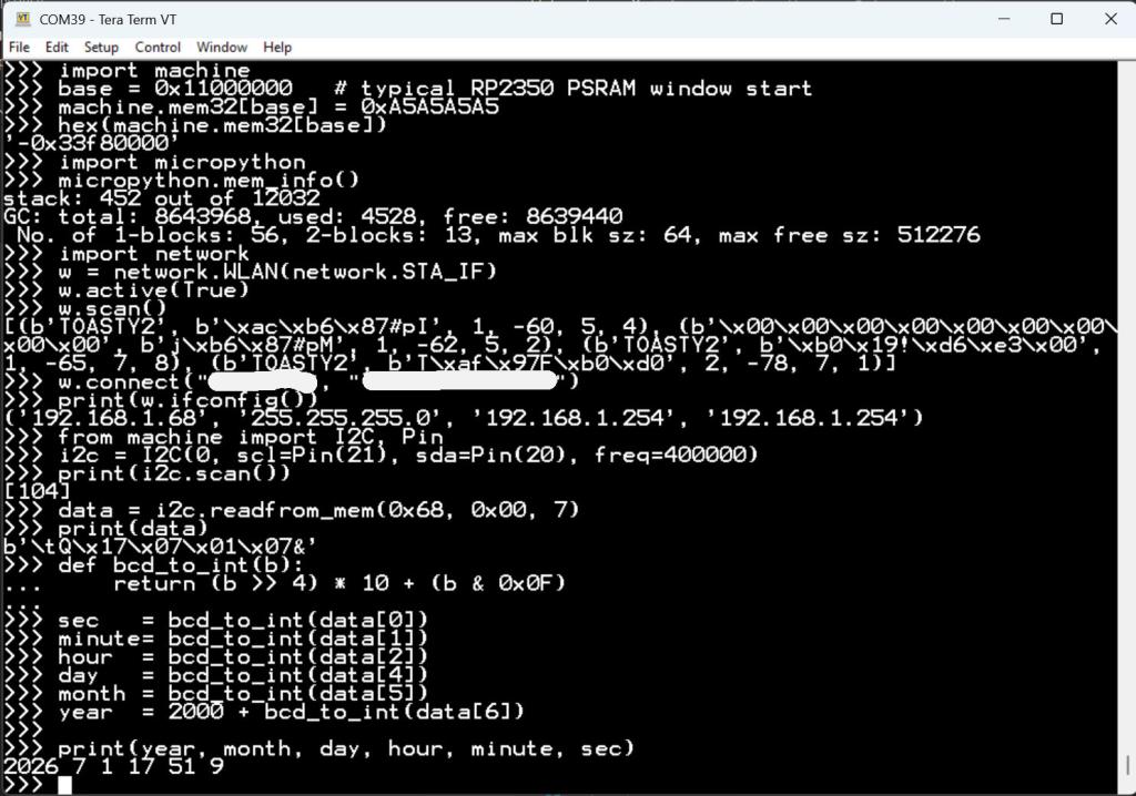

Micropython running on the Pico Computer 3. Still a lot of work to do to enable all the peripherals but the core is now working. Looks like USB host will be the hard one Micropython hasn't got any USB host functionality.
The intention is to make this a fully self contained environment with editor etc.
Edited 2026-07-02 03:59 by matherp

But does this mean 32bit integers?
Posts: 12051
Posted: 09:47pm 01 Jul 2026
Can be either 32 or 64 and floats can be single or double - haven't decided yet

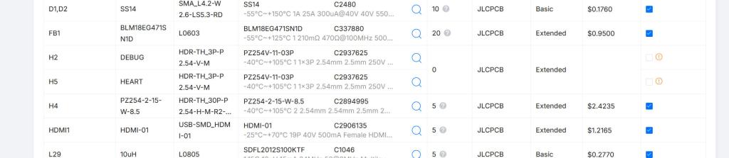

Ok finally got it sorted with JLCPCB now it did say the wfi chip wasn't available also it said 10K resistors weren't either so that has me worried.
The price for 5 of them is $266 but the cheapest freight brings the order upto $366.75 so about $73 for each board.
Does that sound right or not ?
Regards Bryan

The shipping sounds very expensive compared to the UK. I'm not seeing any shortfall on resistors - there is on the psram chips. The only thing odd on the components are the two three pin headers where if you want them to include them you need to check the boxes.

Ok I talked with support and reloaded uploaded the files and selected different 10K resistors, now only one board will have the psram as thats all they had and no wifi chips either.
So got the total cost down to $256 for 5 boards so for Australian members got 3 boards for the cost + shipping.

Please post details of the part number of the replacement resistor (Cnnnnn) in case anyone else hits this.

Didn't see your post mate while I was in the shed but what I did find after I clicked the search button a new page came up with 10K resistors so just chose one where they had plenty of stock.
Now I did ask about the $99 shipping and was told they will refund the extra which they did
