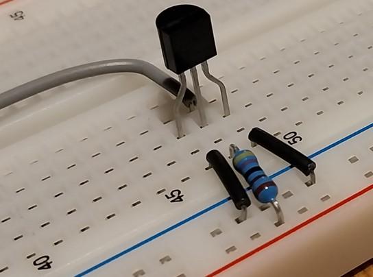

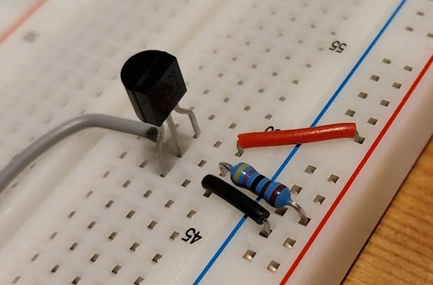

Peter63
Joined: 28/07/2017
Location: Sweden
Posts: 217
Posted: 02:31pm 25 May 2026
Hello, Phil99
Have connected a DS18S20 (Power mode parasitic)
I have about: 25 degrees in the room, but get 69.8125 from the routine.
Do you have any ideas why?
/Peter63
Posted: 03:30pm 25 May 2026
try not using parasitic/phantom power; connect the Vdd pin to 3v3. also, are you sure that resistor you are using is not 470 ohms? the fourth band should be brown, while in your photo it looks closer to black.
rob   :-)
Peter63
Joined: 28/07/2017
Location: Sweden
Posts: 217
Posted: 05:25pm 25 May 2026
I have connected the DS18S20 with external power supply.
But I also had to change a little in the program code to make it work.
Attaching the new version here...

  Quote   are you sure that resistor you are using is not 470 ohms? the fourth band should be brown, while in your photo it looks closer to black.
Jepp, 4.7Kohms
/Peter63

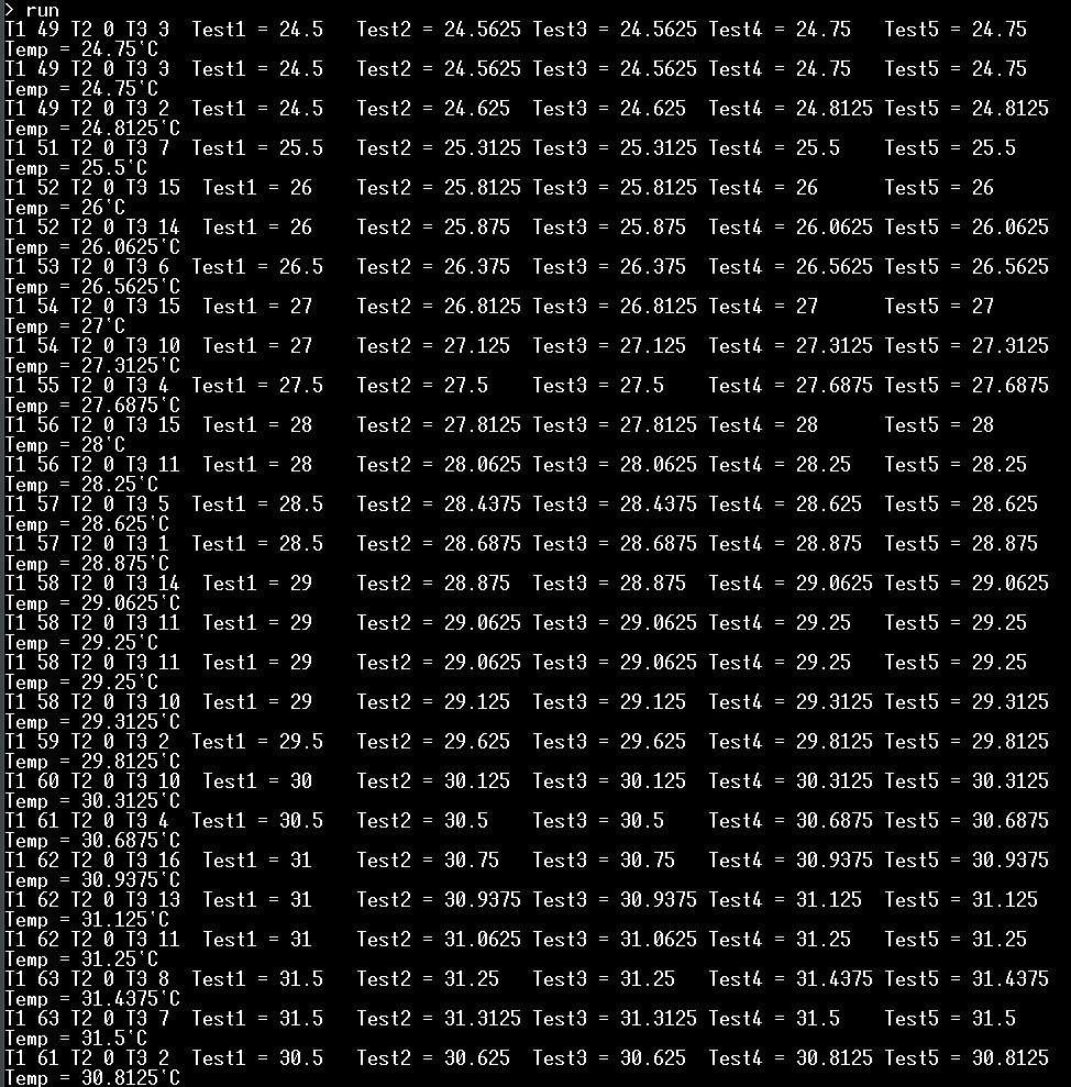

Peter63
Joined: 28/07/2017
Location: Sweden
Posts: 217
Posted: 02:15pm 28 May 2026
Tested all variants:
' --- test loop ---
Print DS18S20test(MM.Info(pinno GP7))
Pause 2000
End
Function DS18S20test(PinNbr As INTEGER) As FLOAT
' derived from DS18x20 test code by TassyJim
 Local INTEGER  T1,T2,c,d,e,f,T3
 OneWire RESET PinNbr                       ' reset before command
 OneWire WRITE PinNbr, 8, 2, &hCC, &h44     ' start conversion
 Pause 750 'mS = maximum conversion time
 OneWire WRITE PinNbr, 1, 2, &hCC, &hBE      ' command read data
 OneWire READ PinNbr,0,7,T1,T2,c,d,e,f,T3     ' get the data

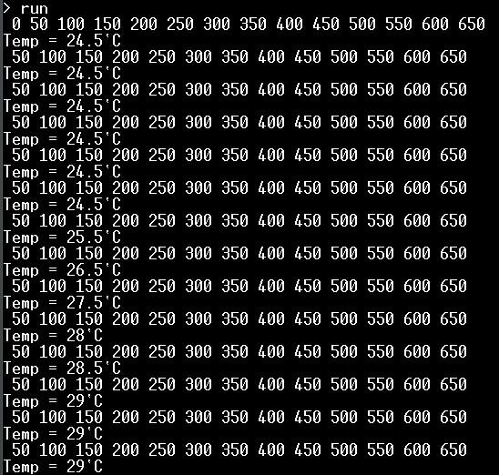

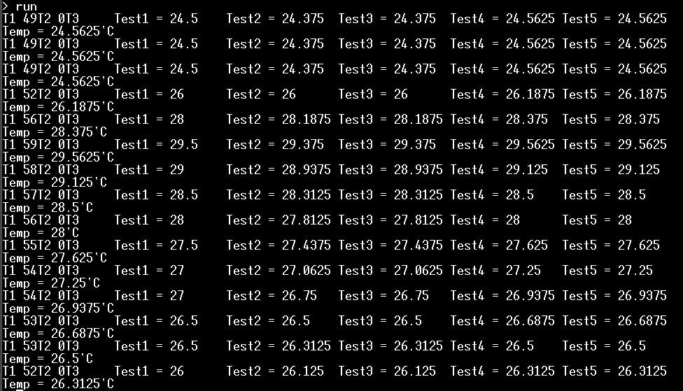

Peter63
Joined: 28/07/2017
Location: Sweden
Posts: 217
Posted: 11:14am 29 May 2026
Tested the new function, it gave this out:
Then I tested the other program:
And finally I tested the last program:
Seems like it works...

Posts: 3416
Posted: 01:52pm 29 May 2026
There are a lot of gaps in the test data, a slower rate if increase or decrease would be needed to fill them. Plus the T3 values.
However I think this is the most likely high res. output line for the first program:-
DS18S20 = Str2bin(int16,Chr$(T1)+Chr$(T2))\2 -0.25 + (16 - T3)/16
And this for the second:-
Value = Str2bin(int16,Chr$(T1)+Chr$(T2))\2 -0.25 + (16 - T3)/16
After all that this is as per the datasheet.
I had imagined the high res data would simply add the fractional part to the low res value.
But instead it appears the high res goes from 1/2° below the low res value to 1/2° above the low res value, with T3 going backwards from 20 to 4.

Posted: 03:46pm 29 May 2026
here comes a new run with T3 values...
/Peter63
