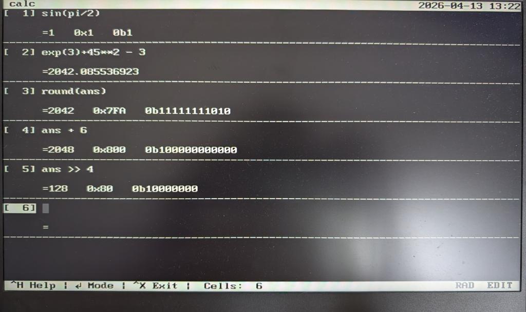

Posted: 05:39pm 06 May 2026
@matherp Peter,
Since things are moving forward, can I ask too?
Is it possible to make a built-in calculator for PicoMite, using the CALC command?
A calculator like the one in PicoTop
https://github.com/7west/PicoTop
