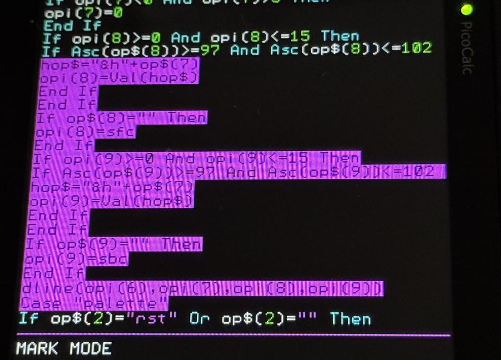

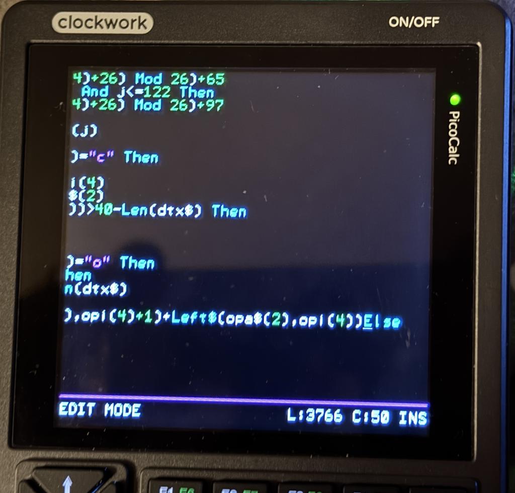

Tested long lines in new version. Something is still wrong when I press backspace after a long line.
Beginning of all other line I can’t reach with the cursor until I press enter or quit the editor and go back.
And mark mode color is changing always to the color of the last selected character. See picture.

  Quote  Something is still wrong when I press backspace after a long line.
Explain more, where is the cursor positioned? By backspace do you mean the back key on the PicoCalc?

Hello Peter!
I try to explain better:
Cursor is standing in the beginning of a line. The previous line is a long line. Then oress back key on Picocalc. Cursor will jump to the end of the previous long line and also the next line will come with the cursor.
But from now I can go to the beginning of the line with cursor (and Home) only in this line. Other lines (previous ones and next ones) - where I can see only the second half of the lines I can’t navigate to the beginning of the lines.
I hope so I was better in explanation.
G@bor

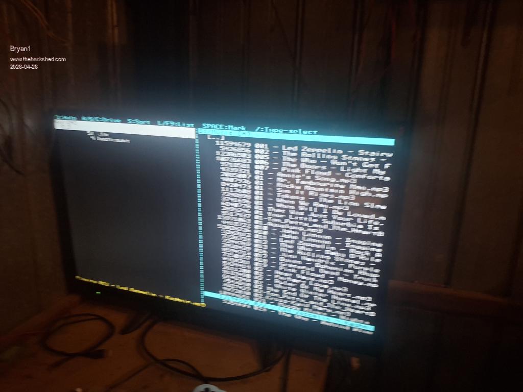

Also a comment on using FM in my case at the moment the divide between A: and B: drive is 50/50 now trying to read the MP.s songs as they have full details the ability to move the middle divider over to the left so the B: folders can be fully seen would be a huge bonus
Here is a picture to show what I mean
As you should see I had Kasmi playing where A: drive doesn't need 50% of the screen
Regards Bryan

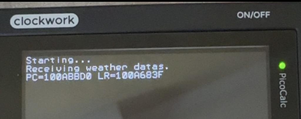

I have a simple test program based on the user manual. Reading data from openweather API.
Connection is ok open, get and close.
But at the first JSON instruction the system sends the attached message and restarts. Then I lost wifi connection, autorun setup.
I can use option wifi again, but same result.
Thanks ,
G@bor

Posted: 03:49pm 26 Apr 2026
RP2350 or RP2040?
terekgabor
Joined: 02/01/2026
Location: Hungary
Posts: 155
Posted: 04:24pm 26 Apr 2026
RP2350B Pimoroni Plus W
