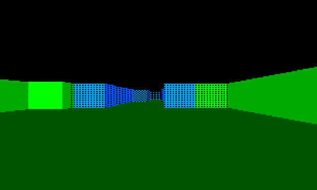

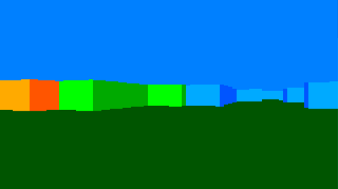

Joined: 04/06/2022
Posts: 1573
Posted: 05:52pm 14 Feb 2026
I have optimised this a little to keep the calculations within the DDA loop as low as possible.

I have revised the map again. Now you get different values when you hit a wall. Here, I have planned to colour different areas differently (as in Wolf3d), which should help with orientation. The value found is stored in 'cll' but not yet evaluated.
Have Fun
Martin
Edited 2026-02-16 22:06 by Martin H.

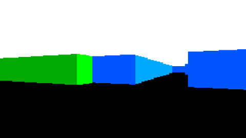

Martin H.
Joined: 04/06/2022
Posts: 1573
Posted: 12:08pm 16 Feb 2026
Addendum: I have adjusted the above listing. Different colours for areas are now taken into account by the programme.
'no comment
Posts: 6195
Posted: 01:25pm 16 Feb 2026
Hi Martin,
You may need a small fix. The use of floor and ceiling color is essential for the program to run. If I change them to rgb(black) and rgb(white) I cannot navigate anymore.
Martin H.
Joined: 04/06/2022
Posts: 1573
Posted: 01:45pm 16 Feb 2026
  Volhout said  Hi Martin,
 Well, I don't understand that, because
colSky = RGB(White)
colFloor = RGB(Black)

@dddns Thanks for the feedback. I don't have an LCD Pico myself at the moment, but it's good to hear that it works there too.
Here I have further optimised the routines and now pre-calculate the angles in lookup tables.
On an RP2040 @225, image rendering now takes 40-85 ms.
I don't see any further optimisation possibilities at this time.
If you can think of any further optimisation possibilities, please let me know.

Because it's Sunday. Version 0.86, some calculations have been sped up again, and it is now possible with the dither%-switch to darken the walls depending on
'the distance (selectable dithering).
Everyone is free to use and improve the routines.

I removed the calculations from the loop as best I could.
I replaced many “if queries” with calculations using true and false.
Testing line by line to find out which type of calculation is currently faster.
This speeds up execution considerably, but does not contribute to readability.
To understand the calculation and how it works, it's best to watch this Video .

with the current one; that will help you understand.
  For x = 0 To scrW - 1 Step resStep
    cameraX = x * invScrW - 1
    rayDx = dx + planeX * cameraX
    rayDy = dy + planeY * cameraX
    mx = Int(px) : my = Int(py)
  If Not rayDx  Then dDx = 1000 Else dDx = Abs(1 / rayDx)
  If Not rayDy  Then dDy = 1000 Else dDy = Abs( 1 / rayDy)
  If rayDx < 0 Then
    stepX=-1:sdX=(px - mx)*dDx
  Else
    stepX=1:sdX=(mx+1-px)*dDx
  End If
  If rayDy < 0 Then
      stepY = -1: sdY = (py - my) * dDy
  Else
      stepY = 1 : sdY = (my + 1 - py) * dDy
  End If
    'cast one Ray
    Do While Not m(mx,my)
     If sdX < sdY Then
        Inc sdX,dDx:Inc mx,stepX : side = 0
      Else
        Inc sdY,dDy:Inc my,stepY : side = 1
      End If
    pDist=Max(0.1,(sdX - dDx)*Not(side)+(sdY-dDy)*side)
    lH = scrH / pDist
    shade = min (int(pDist>>3)*24,72)*dither%
Blit shade+scrw-8+8*m(mx,my)+4*side,0,x,Max(0,halfScrH-(lH>>1)),resStep,Min(lH,scrH)
  Next x
If I find further ways to optimize it, it will certainly become even more unreadable.
