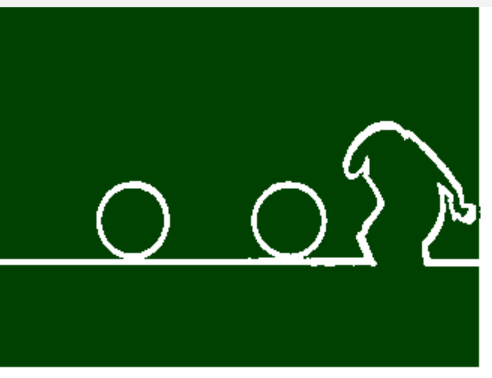

This is a (3 Sec) brief feasibility test using Polygons in mmb 4 Windows. The data would then be stored in an external file. In addition, there is still much to optimize (counting duplicate frames, etc.).

Here we have the full La Linea 10 Video for the Pico, using Polygons.
Need option resolution 640x480 378 MHz to stay in Sync with the Audio
Have Fun

the video should run at 25 FPS, i.e. 40 ms per frame. Even at 378 MHz, the “longest frame” takes 51 ms, but this is not noticeable and the video remains synchronized. The audio is 16 kHz 8-bit mono. No, I haven't tried flac yet, but it's a good idea.
I first reduced the video to 320x240 using Handbrake and then exported it as individual frames using VirtualDub.
For vectorization, I use the Douglas-Peucker algorithm and had gemini write a JScript
for it, although I still had to modify the output file again with the hex editor, .
render3.zip
Because it still wrote the color value after each “-1” (end of page). In addition, he used the RGB value instead of the color value Col (8), so I had to swap that with search/replace.(The RGB values differ between MMB4Windows and Picomite.)
