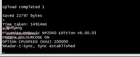

Posted: 06:08pm 20 Nov 2025
Hello ville56
Today I started my first attempts getting contact to LD2450C but unfortunately I'm hanging with the print output shown in the picture.
I'll further looking, but maybe you already have a tip.
Wolfgang
Edited 2025-11-21 04:09 by Wolfgang

Apologies, I made a mistake in the description of my radar module.
It is an LD2410C and not an LD2450C as stated in my previous message.
Wolfgang

ville56
Joined: 08/06/2022
Location: Austria
Posts: 646
Posted: 10:36am 21 Nov 2025
I will get my LD2410 today and then I have the opportunity to adapt the code to this sensor. May take one day or another, but I will do it and post the code here. But first I have to understand what the LD2410 really is capable of.
