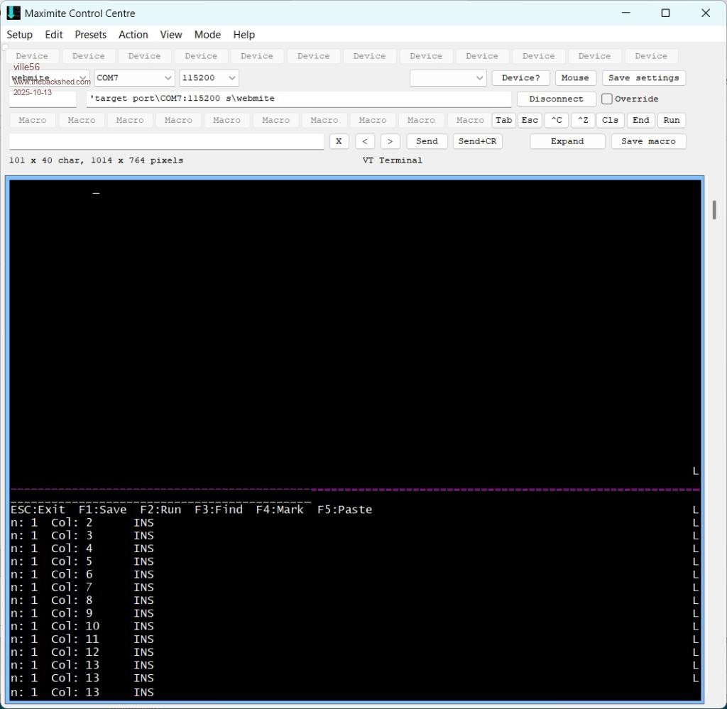

with RP2350 webmite I get the following screen when using "EDIT" ....
for each character I type in, I get an additional line at the bottom.

I did nuke the flash before uploading the debugging firmware ... Is there anything I did not set correctly?

  Quote  for each character I type in, I get an additional line at the bottom.
Try setting MMCC display to match the 'mite 145 x 45
