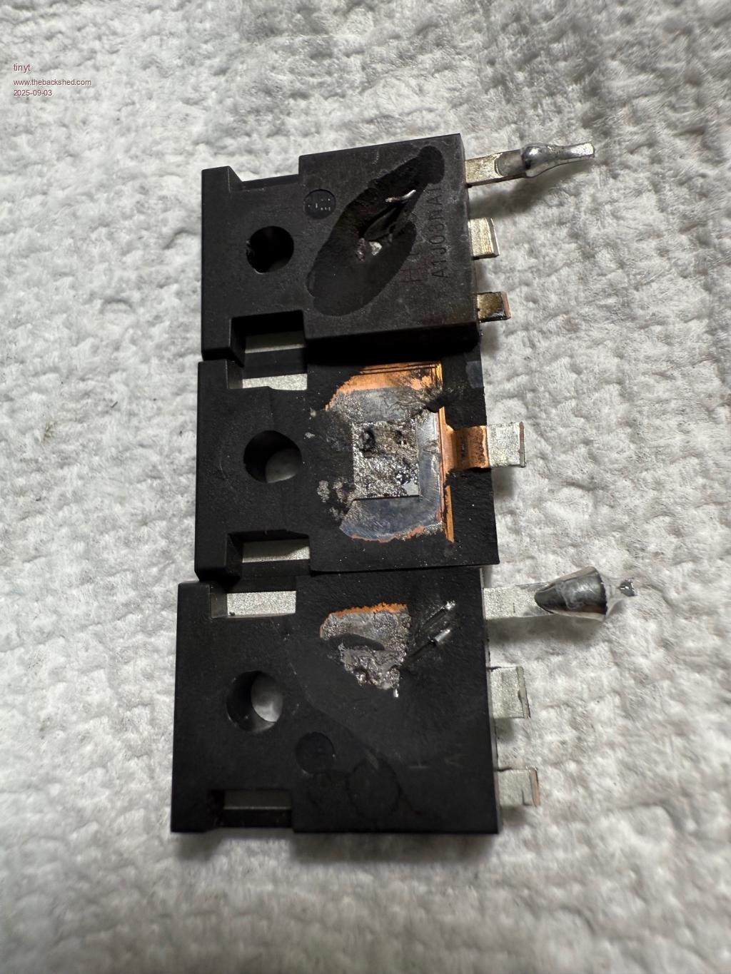

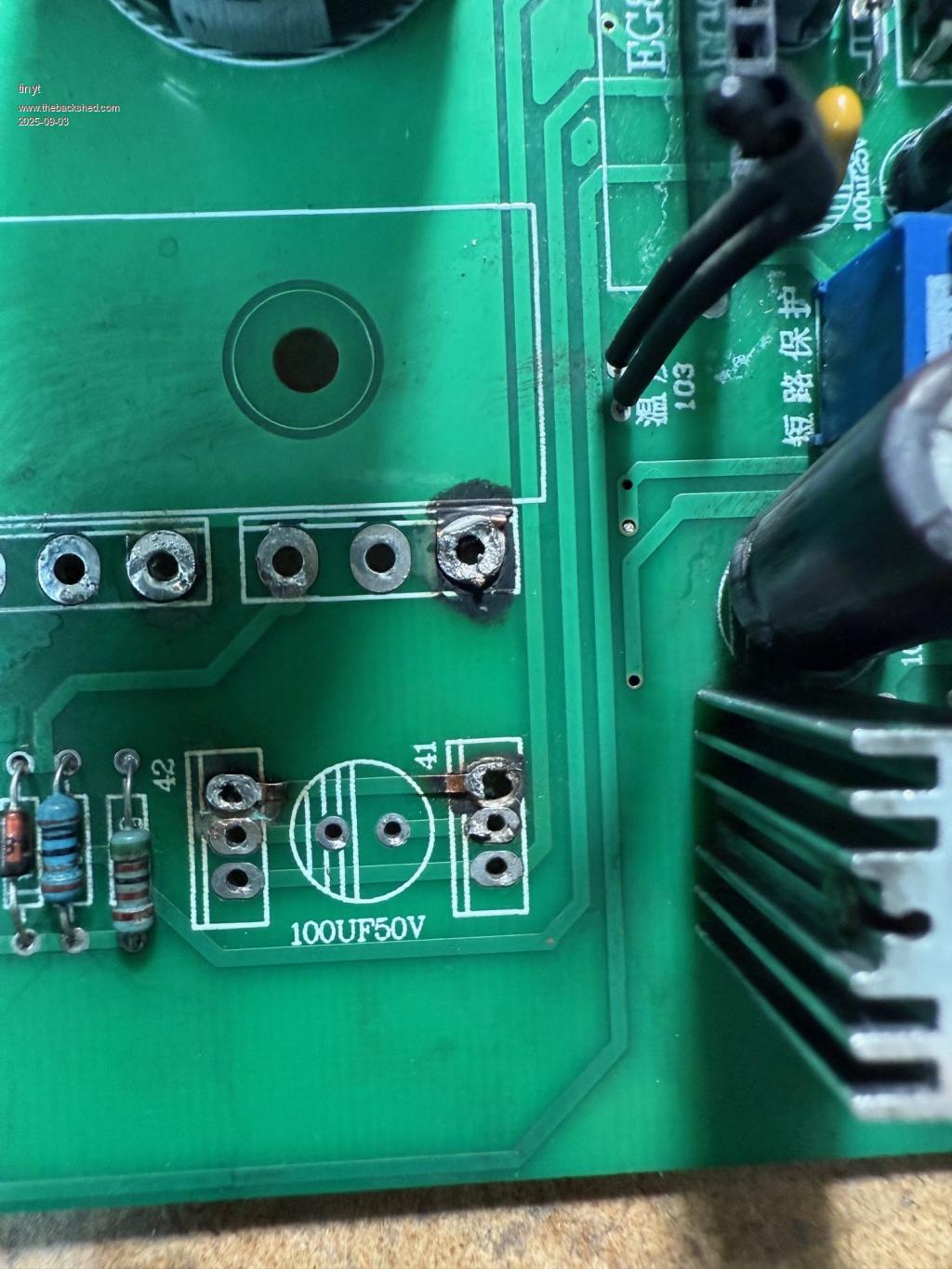

So, I started removing the blown mosfets using suction desoldering tool.
And I added more damage by tearing the top side copper foil. Luckily, I can beef up the connection at the bottom side. To avoid further copper foil damage, I cut two adjacent legs of the mosfet (my small cutter can reach only two) so that I can easly desolder and pull the remaining leg. I will be replacing all 24 mosfets anyway.
One pair of totem pole transistors also was damaged together with their solder pads. I will be replacing all four pairs. Note also the solder pad damage of the badly blown mosfet.
Here is close up of three blown mosfets. The top mosfet shows one of the source terminal bond wire sticking out which measures roughly .013" (.33mm) dia. with a caliper. The bottom mosfet seems to show that there are two bond wires for the source terminal. And apparently their explosion caused the body to crack.

Good luck with the repairs Tiny.
That was a pretty good blow up. I hope it all goes well and that you find all the damaged components first time.

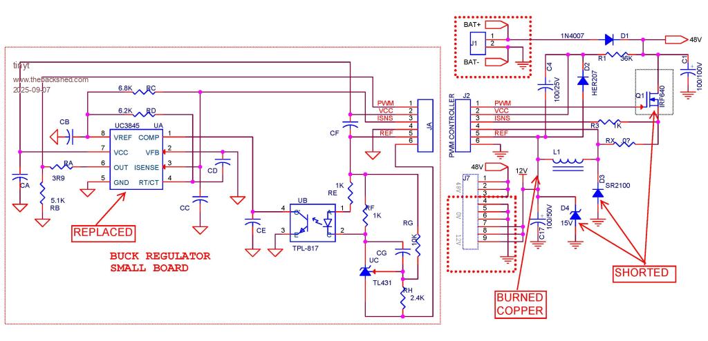

It also took out the 48V to 12V buck regulator and opamps. Still testing for more damage.

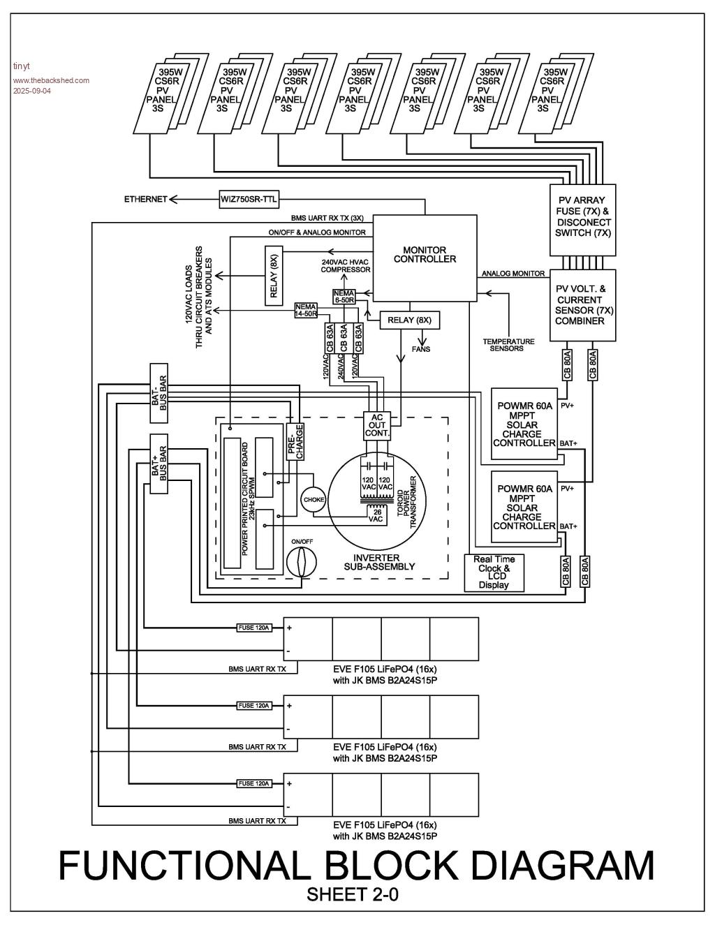

Way back I started a technical manual for my sons when I am gone. But I have not finished/updated it.
I think this page is still good except for the auto pre-charge board which is now replaced with a simple pushbutton/power resistor combination.

Nice diagram Tiny.
I have done similar for my place for the next people who live here after I leave the planet.
But my system is very simple, there are a few change over switches so the Grid inverters can feed back through two different battery inverters and there is a system of switching for using the EV charger
Plus a voltage controlled relay that switches the GTI inverters off when the batteries are charged.
No ethernet
Batteries are Valve Regulated Lead Acid, so no complicated BMS.
Just 4 regulators for the panels, and two GTI inverters for another two banks of panels.
So instructions required for anyone else to know how a system that has grown from 1.2 kw of panels and one inverter, to 10kw plus of panels and 3 inverters.
Good luck
Pete

Tiny, On the Diagram, I'm curious about the CB 80A on the solar charger input.....
Cheers Aaron

  Revlac said  Tiny, On the Diagram, I'm curious about the CB 80A on the solar charger input.....
That is what I had on hand, I don't if it should be lower rated at 60A. But it is mainly used to remove/apply PV power to the SCC. Note that the PV- connections are not shown in that diagram.

After removing all 24 mosfets and four pairs of totem-pole drivers, I tested to see if the 48V to 12V buck converter circuit is working.
Of course it is not. Found shorted components and it took me a while to 'discover' a burned copper trace hidden under a connector. In the process, learned a little bit about how the UC3845 works. Replaced the shorted and suspect components, jumpered the burned copper and I now have 12 volts.

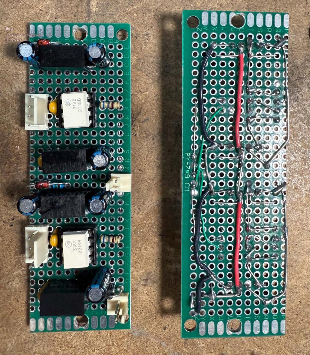

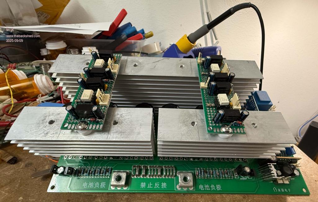

So, I assembled the two identical circuits on two prototyping boards.
I tested the ouput voltages and they were as expected. With no input, the output of the  FOD3182 is at negative bias voltage.
I drilled and tapped the top of the heat sinks to mount the boards.
I then looked at my reverse circuit drawing of the inverter.
To fit the new driver circuits, I have to make 12 copper trace cuts, solder 2 jumpers, and solder a total of 22 wires for the connector harnesses.
And I chickened out.
A lot of things can go wrong: MY reverse is not accurate, mistakes in copper trace cuttings, etc. Also, I have no spare inverter.
I have decided to save my work in case I really need to do it in the future.
I think for now I will just concentrate on the compressor motor soft-start. And make sure I don't overload the inverter really bad.
Edited 2025-09-09 13:20 by tinyt

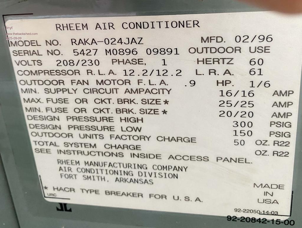

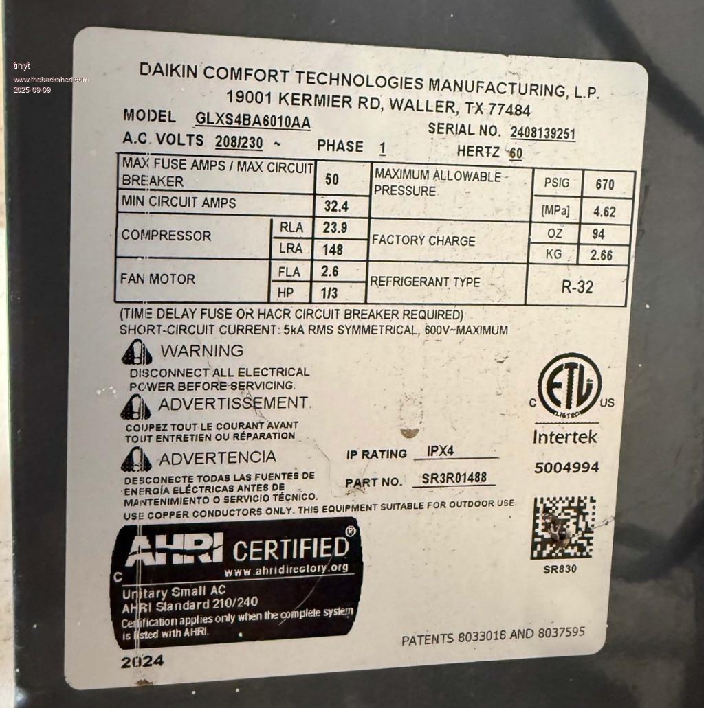

The HVAC that blew the inverter is newly installed (about 8 months).
Nameplate says 2024.
Here are some pages of the spec (schematic included).
goodman-glxs4ba6010-specification-some sheets.pdf
We have decided not to power it with the inverter, we think it is overkill to power it with our inverter, besides battery capacity is not enough to power it long enough.
My other son's A/C is much older, close to 30 years and still running.
We have operated this with the inverter several times already with no problem.
But, we don't want to stress the mosfets, so we are going to use soft start on this one.

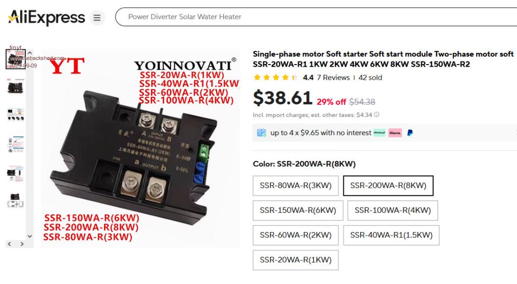

Micro-air is still not affordable, so I ordered these.
The plan is to set the ramp voltage time of the SSR to about 1/2 second or even less so as not to stall the motor, then with a tbd. delay circuit activate the HD relay to bypass the SSR. This way we don't overheat the SSR.
I hope this works.

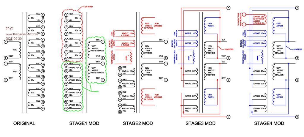

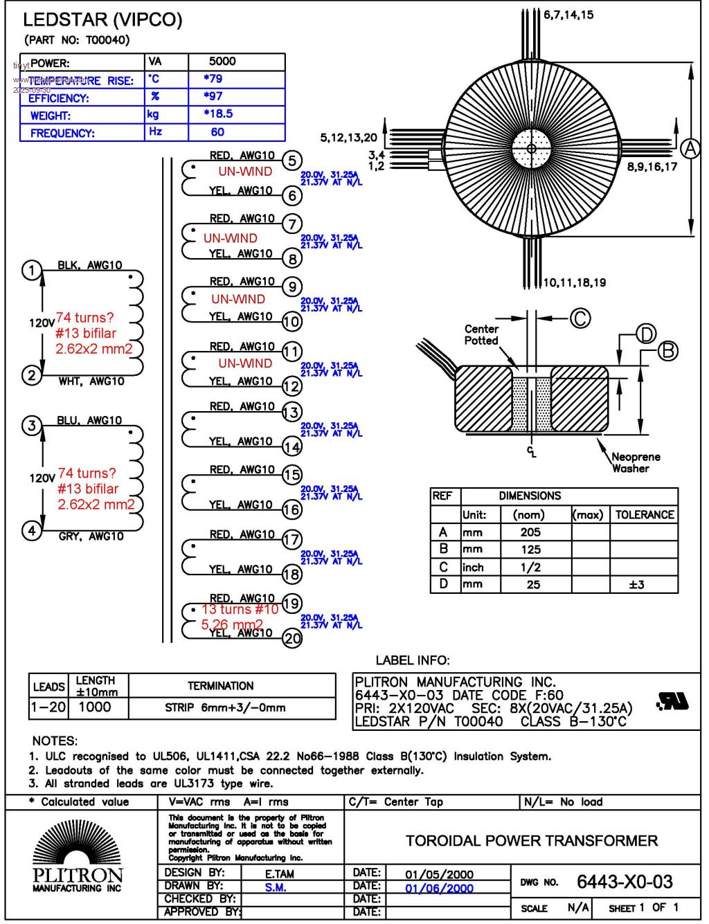

For reference here is the data sheet of the original toroid transformer with my notes in red.
Calculated weight says 18.5 kg (40.78 lbs). Seem that my mod added only 1.3 lbs.
Here also shows my modification in stages.
Using my notes and the picture above, and using number of turns instead of voltage, turns ratio is ((74 + 13) x 2) / 19 = 9.15
Secondary cross section for the 74 turns (120V) is (2.624 x 2)  = 6.8757 mm2
for the 13 turns (20v) is (1.6277 x 2) = 5.176 mm2
Primary cross section for the 19 turns (26v) is 1.6277 x 20 = 32.55 mm2
I hope I got my rithmetic right.
Edited 2025-09-30 07:12 by tinyt
analog8484
Joined: 11/11/2021
Posts: 242
Posted: 05:11pm 30 Sep 2025
AFAIK, the only inverter of similar power rating that can start a 5 ton A/C (without soft start) is the Schneider XW PRO which is rated for 6.8kW and has an 80 lb transformer.  It's remarkable that your inverter can start a 5 ton A/C with a transformer that's half the weight.
That turns ratio is certainly closer to typical.  So, is the actual voltage ratio similar (26VAC to ~238VAC)?  If so, it seems the original transformer datasheet voltage ratio was a bit off?
Hmm ... the build thread and the diagram above indicate 14 AWG for each strand for the primary winding which  has a 2.08 mm2 cross section.  The 1.6277 number looks more like the diameter of 14 AWG.
For the secondary winding (the 120V portion), the build thread and diagram indicate 2x13AWG + 1x14AWG.  The "2.624x2" above would mean only 2x13AWG?
Can you verify?
In any case, if you ever run the 5 ton A/C again with the inverter, it would be great to know how low the voltage gets.
tinyt
Joined: 12/11/2017
Posts: 564
Posted: 11:40pm 30 Sep 2025
  analog8484 said
Can you verify?
Yes, you are correct, at my age I keep making mistakes now. AWG 14 cross-section is 2.08 mm2.
And you are also correct for the secondary:
The 120v section is 2x2.624 + 2.08 =  7.328 mm2
And the 20v section is 2x5.267 = 10.534 mm2
The primary is 20x2.08 = 41.6 mm2

No load:
Secondary(L1-L2) = 236.6vac
Primary = 26.16vac
Primary including the choke = 31.9 spwm
Calculated turns ratio: 236.6/26.16 = 9.044
L1-N loaded with 120vac pool pump drawing 7.6A
Secondary(L1-L2) = 237vac
Primary = 26.37vac
Primary including the choke = 32.5 spwm
Calculated turns ratio: 237/26.37 = 8.987
Note that no load voltage output is lower than with load. We noticed this on the 3 inverters that I built.

  tinyt said
No load:
Primary = 26.16vac
Primary = 26.37vac
Sounds like you are measuring this in the Inverter, so that's likely a bit of switching noise skewing the VFB sense or slight distortion on the AC VFB from the load ETC, so the load to unload comparison may be a little off.
Is spwm = duty cycle spwm %  (if accurate) it's extremely low?
