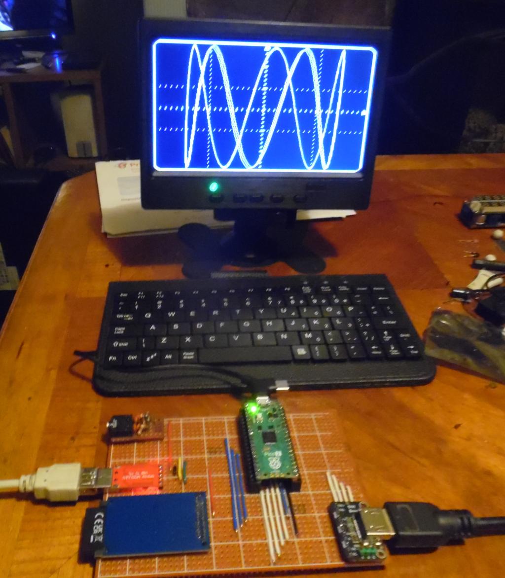

Posted: 10:47pm 26 Jul 2025
tried on board with audio hdmi usb the manual suggestions and ok
