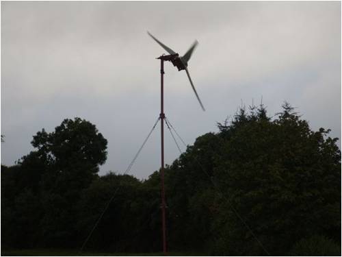

finally got a pic of the furl....its been doing this a good bit all evening ...the frisbee effect is the best way to describe it..

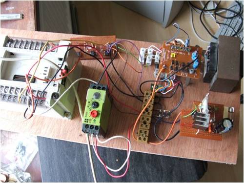

the small up wind vane sends right/left signals back to a plc via a toy car transmitter..even with the dodgy wiring this is working well ,this way i can leave the plc next to the computer
the plc can send signals back the same way to a yaw motor (no ideas yet for the motor ...)..it shouldnt need to be active very often , maybe once every hour and hopefully make a correction (with some feedback from the vane) and then the yaw should lock...if i can rig a motor it could be a lot of fun (not quite so practical though)

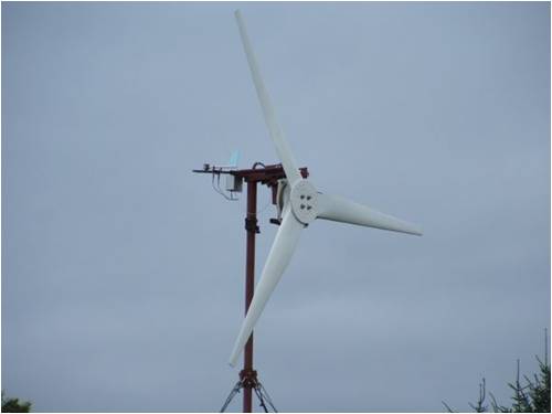

With no furling mechanism my turbine had a very clean aerodynamic profile (See pic below). The electromagnetic brake worked fine & it seemed to turn the turbine offwind when it activated - possibly from torque reaction but I can't quantify that theory yet. Problem is that if the brake ever fails in high winds I want to be in another state when the turbine explodes.

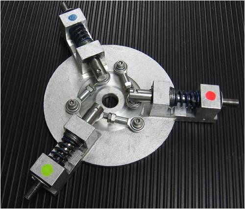

I have also been investigating the idea of converting a centrifugal clutch from a small motorcycle or scooter into a mechanical brake but as I am living in a Motorhome I lack a lot of workshop facilities, does anyone else have expertise or knowledge in this area?

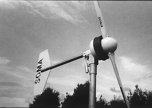

Recently I fixed a dishwasher for a bloke from up the north of this island. It turns out he has has a Soma windmill running for the last 6 years without incident.
Interestingly, it is a head-lift furling type, and has only 2 blades.... 9' diameter. This is an Australian unit.... the Irish bought out our Westwind machines I think......
Not sure when I will get time to get up there and take him up on the offer to look at it, but I am more interested to do so now.
They have solved these procession problems, and now I am curious to look at it.
It is an upwind type with a straight tail (solves procession and tower noise)
Maybe a better way to go??
