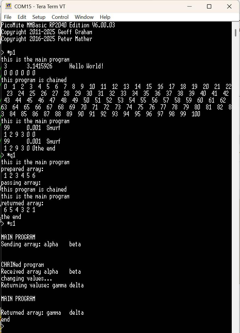

If sending a simple string array it gets chopped off after the first element:
Print
Print "MAIN PROGRAM"
If MM.CMDLINE$ <> "chainret" Then
 Dim a$(1) = ("alpha", "beta")
 Print "Sending array: ";a$(0),a$(1)
 Chain "a:/s2.bas"
Print
Print "Returned array: ";
Print a$(0),a$(1)
Print "end"
Print :Print
Print "CHAINed program"
Print "Received array ";
Print a$(0),a$(1)
Print "changing values..."
a$(0) = "gamma"
a$(1) = "delta"
Print "Returning valuse: "a$(0),a$(1)
Chain "a:/s1.bas","chainret"
> RUN
MAIN PROGRAM
Sending array: alpha    beta
CHAINed program
Received array alpha
changing values...
Returning valuse: gamma delta
MAIN PROGRAM
Returned array: gamma
end

This makes no sense. All the code does is copy the entire heap to disk and then restore it. I'm beginning to think it therefore must be a caching issue or similar.
More investigation needed.....

  Quote  With this firmware it only copys the firmware onto the drive of the pico (yes I pressed and hold boot button).
That means it is the rp2040 firmware on the Rp2350 or visa versa.
Check you are using the second zip I posted not the first.
NB: I think I have found a workaround for the CHAIN issue
declare a dummy string which you are not going to use before any other variables
e.g. for Mick's test
Print
dim dummy$
Chain "a:/s2.bas"
Print
Print a$(0),a$(1)
Print "end"
Please check this and confirm for me. Assuming all OK I'll try and find a proper fix

That certainly works on my last test. :)

Nope, sorry. It still only works on the standard 2040 with dummy$ dimensioned.
This is seriously weird...  There's nothing on this thing. The flash slots are empty and only my test files are on A:. It was a new install from 5.08 when I started playing. I'm only using the console, no display, standard, original Pico.

Just checked - standard RP2040 PicoMite - no options set. Your p1/p2, q1/q2, s1/s2 test programs all work perfectly as posted with the latest firmware. Try downloading again/clear cache etc.

Thanks Peter, that was the answer - clear cache. :)
Things are much better now. :)
