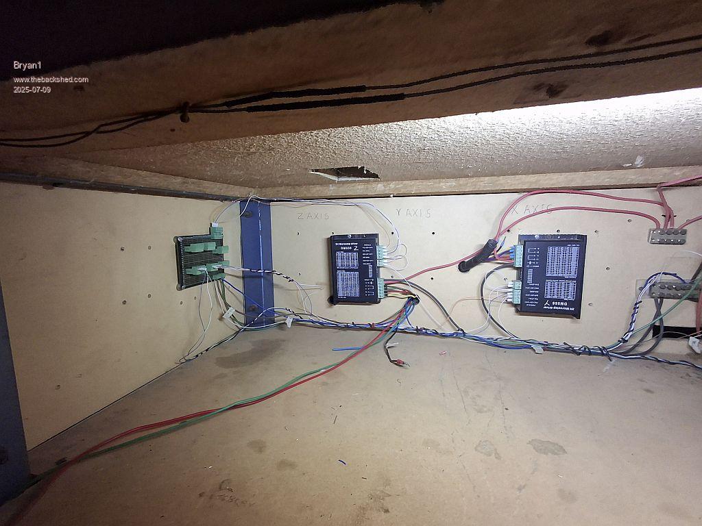

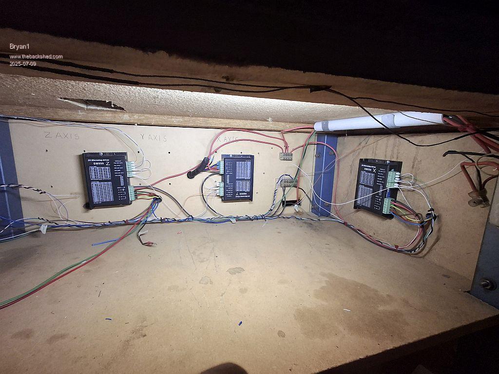

Posted: 06:58am 09 Jul 2025
Ok got it all wired up and all checked so the next step is setting up the 2040.
Now on the left picture one can see that green board thats where all the wires go and put separate green lugs for the output.
The red and green wires are for the spindle motor and the blue and black are 2 spare inputs from the motor connection so a trace can be later made and used.
I did have the right termination fittings for the cat6 wire and each DM556 has been pulled down to earth so a high signal will be needed. Did this before with the test so it shouldn't be a problem.

Bryan1
Joined: 22/02/2006
Posts: 2297
Posted: 08:08am 09 Jul 2025
  PhenixRising said  Now would be a good time to check your fire extinguisher
That wood bench has been on there since day 1 of my CNC mate   Now where the X-axis 556 is I did put in a new side for it.
As it was dark in the there I just set up a 3 section LED strip which did give plenty of light but also got nice and warm too so once everything is up and working that light won't be needed. I did stick it on using double sided tape and it did fall down a couple of times that when I noticed the warmth.
Now the main table is some high voltage switch board stuff that is easily drilled and tapped and being 20mm thick it doesn't bow at all.
So if I do have time tomorrow I will be testing each axis and putting a dial indicator on to check travel down to 0.001"
Then the huge learning curve can start on the coding and now the V6 manual is out now may just use that $12 colour laser printer to print a copy
If those DM556's do get warm in use I have a heap of heat sinks so they be remounted on them. Now once the CNC is all working I will be moving it out of my shed and down to the area I have in the house shed and it is setup to be be removed from the frame it's currently on.
Phenix the CNC has 100x10mm flat bar at each end with that 20 mm board screwed on each end so when I do want to set it up in it's final destination I will more than likely fabricate up a steel frame for it.
But between now and then is going to be awhile as I can't see the finish line from here at the present moment.
