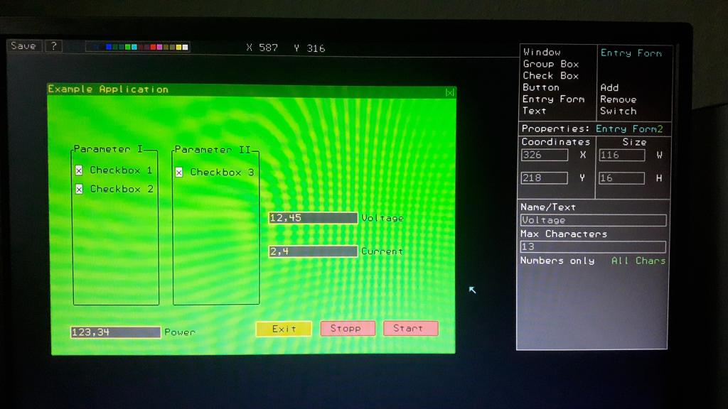

Update:
- Added selection between Numbers only / All Chars (Entry Form)
Now supports these resolutions so more users can test or play with, if they want:
- 848x480 (Widescreen)   <- as seen on the image below
- 720x400 (Widescreen)
- 800x600 4:3
- 640x480 4:3
- small bugfixes
File:
gui_editor_b22a.zip
Greetings
Daniel

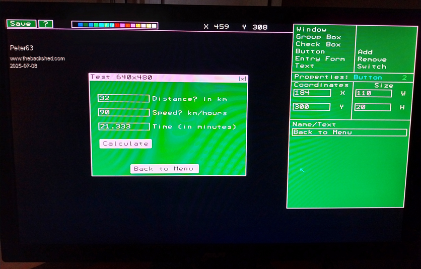

Posted: 03:52am 08 Jul 2025
Tested resolution 640x480:
/Peter63

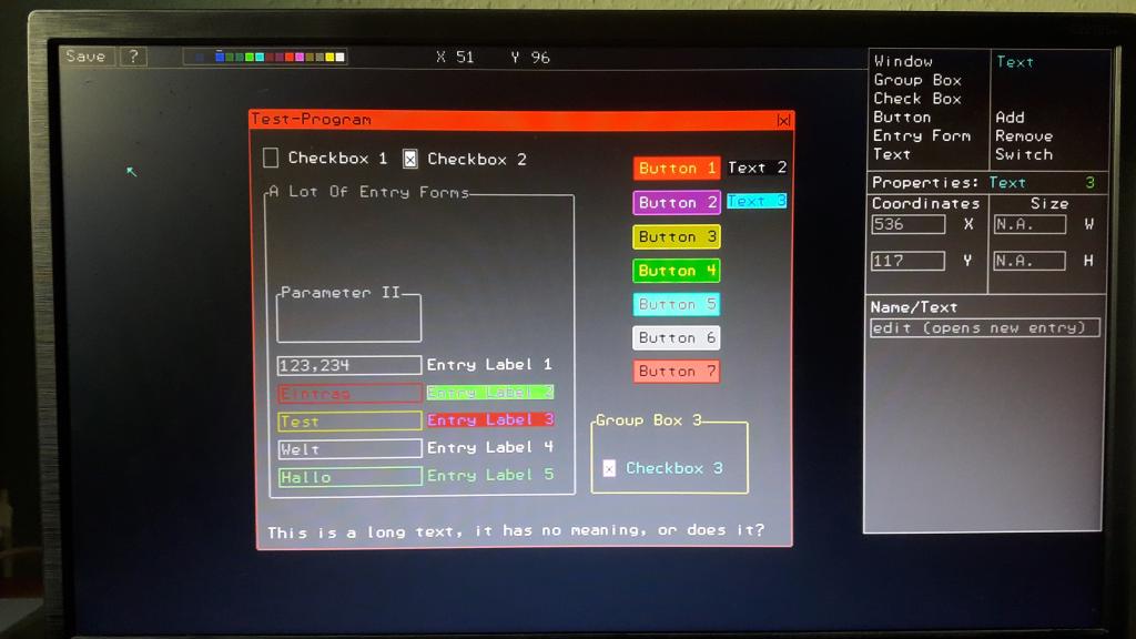

Update:
Now everything "basic" is integrated and all is functional...
- Text Item is working now and allows long text line
- Window Item is now completly removable (not everyone wants the window frame!)
- Resolution adjustments and fixes
For the next update, I will finally add the option for more items (of each sort)
current maximum is 3 per item category.
gui_editor_b22a.zip
Greetings
Daniel

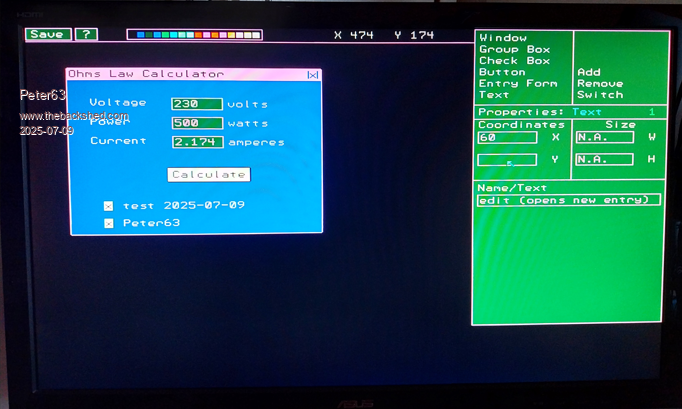

Posted: 03:53am 09 Jul 2025
/Peter63
