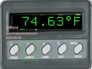

Still very rough, and not all logging functionality is integrated...
IR temperature spot sensor for Game*Mite...

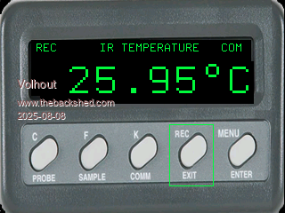

The associated Game*Mite program is this:
2025-08-08_070747_mlx90614_gm3.zip
The Game*Mite shows something that looks similar to a FLUKE reference temperature meter. Which this (obviously) not is....;-)
The software displays degrees C/F/K, can output the data on the USB(console) port, and can record on the A: drive.
Navigation:
Left and Right buttons move the focus
B select the top function
A selects the bottom function
The functions MENU and ENTER are not implemented yet, but could be used to change the file name of the log file on A:.
P.S. for the record, this is running on 6.00.03 dated 7-7-2025
