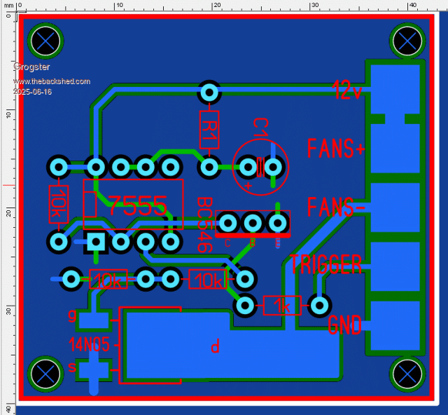

This is my prototype PCB layout:
Still playing with the idea, but....
Very small PCB - 43mm x 40mm.
Will easily fit inside the projector.

It's a bit posh! I'd have dug a scrap of veroboard out. lol
Your mosfet should fully saturate with that low a load. RDS(on) will be 0R1 or less so power dissipation will be about 13 milliwatts!

OK, so then perhaps I don't need the copper-heatsink on the drain then!
I was just thinking that I normally run the projector for many hours before I shut it off, so more copper-pour as a heatsink was better then none.

It's fine - it won't do any harm to have something to hold the tab down. You almost certainly won't need a lot though.

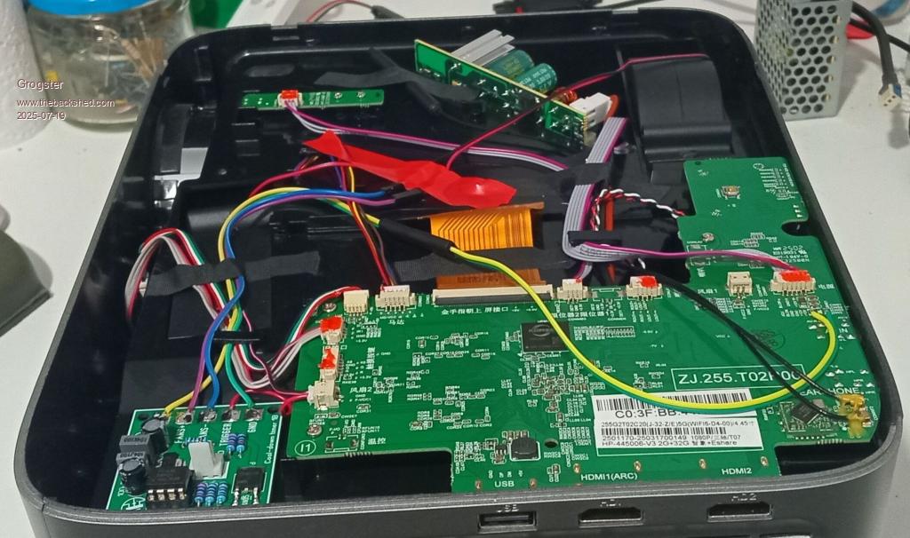

All done, installed and most importantly - working great!
This is version 1B of the cool-down PCB, and I switched the 555 for a PICAXE 08M2.
This was because while testing on the bench, the 555 would not reliably keep the fans on.  Sometimes it would, other times it would shut them off after about 10 seconds instead of 60 or so.
Anyway, it was easier to just plop a PICAXE chip in there, cos then I could easily adjust the cool-down time in code without having to pull parts.
Those who look carefully, might note that the design of this projector is good enough, that they have not just buried the LCD in the guts requiring a full disassembly to get to it - note the little plastic clips on the top of the LCD(one on right of image covered with IDC cable and black tape holding wires down) - you can release those, disconnect the FPC cable, and pull the entire LCD up and out of the optical assembly.
Very nice design.
About the only thing missing, was a cool-down timer on the mainboard.  Perhaps I could suggest it via email with this photo and thread as a bit of evidence?  Would they even care though, that's the thing.....
