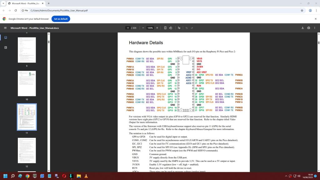

wanting usb to ttl to be on different pins
using
> option list
PicoMiteHDMI MMBasic USB RP2350A Edition V6.00.02
OPTION FLASH SIZE 4194304
OPTION COLOURCODE ON
OPTION KEYBOARD UK
OPTION RESOLUTION 640x480 @ 252000KHz
OPTION DISPLAY 30, 53
OPTION SDCARD GP22, GP6, GP7, GP4
tried OPTION SERIAL CONSOLE COM2,GP20,GP21 but says invalid option
gp22 and gp9 used.
just want to wire usb to ttl and sd card reader neater

Posted: 05:34am 15 Jun 2025
check syntax
Posted: 06:19pm 15 Jun 2025
  dddns said  check syntax
OPTION SERIAL CONSOLE COM2,GP20,GP21 seems ok syntax
using OPTION SERIAL CONSOLE COM2,GP8,GP9
PWM4A COM2 TX I2C SDA SPI2 RX GP8 11
PWM4B COM2 RX I2C SCL GP9 12
27 GP21 I2C SCL COM2 RX PWM2B
26 GP20 SPI RX I2C SDA COM2 TX PWM2A
why gp8,gp9 ok but gp20,gp21 not when they both
COM2 TX
COM2 RX
? stan
Edited 2025-06-16 05:36 by stanleyella

GP8,GP9 is default for USB versions. Sure you can assign them to any other valid free GPs with this command.
True is, that GP8,GP9(default serial) have to be assigned to other pins before you can use them for other issues
So initial setup would be:
flash USB firmware
connect temporarily USB/UART converter to GP8,GP9
change pins to whatever combination
connect finally USB/UART converter to new assigned pins.
But with every firmware change which probably resets all options to default this procedure would have to be done again.
So I would try to use the default GP8,GP9 in any circumstance
or
@Phils solution with .opt
Use LIST PINS to have the best overview
Here appendix A from Manual which exactly describes your problem:
And the following command for the second channel (referred to as COM2):
SETPIN rx, tx, COM2
Valid pins are
RX:
GP5, GP9 or GP21
TX:
GP4, GP8 or GP20
So in your case:
Option serial console gp21,gp20
for default 115200
