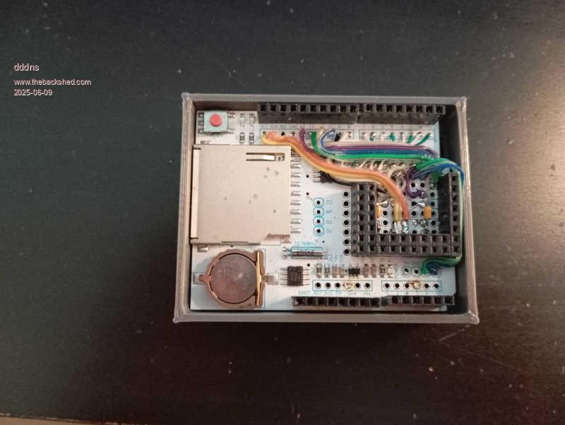

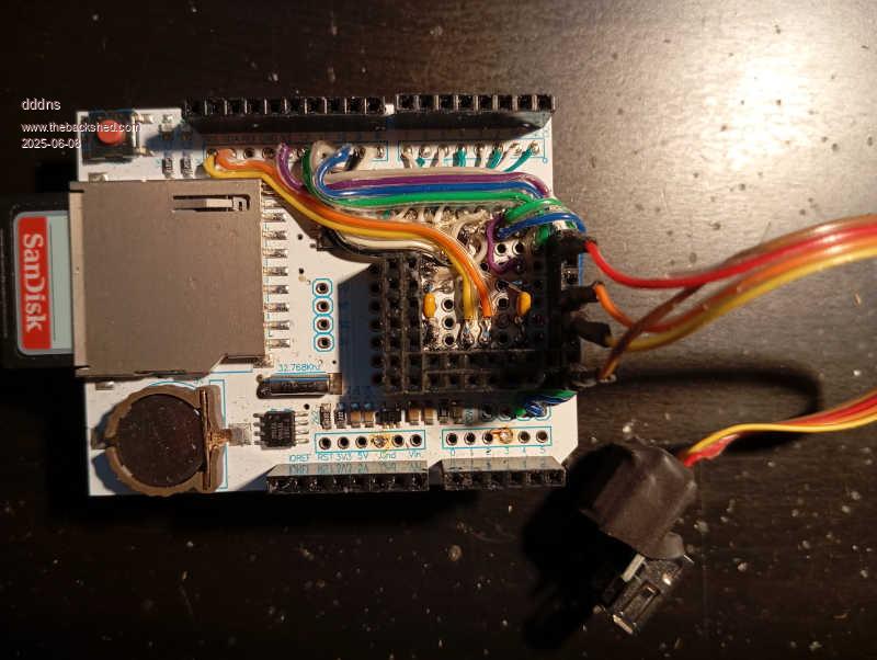

This is my work of today. SDcard, i2c/RTC and audio working:
Up to now I didn't touch the logger shield, it runs with 5V and a level shifter..

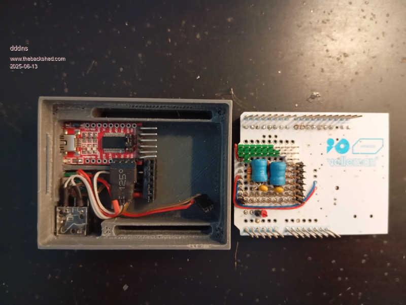

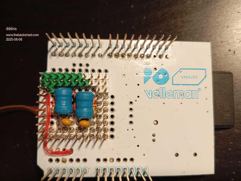

And I implemented @Volhout's audio filter:

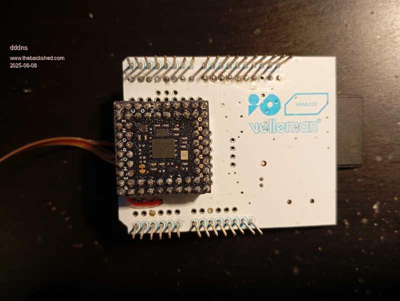

Posts: 6195
Posted: 07:31am 08 Jun 2025
Impressive and compact.
There was just enough room to put the pga.
But this is not doable for the average shedder.
Posts: 9238
Posted: 08:44am 08 Jun 2025
That little board that I posted a pic of above is about 52mm square, although it's using the Pico rather than the PGA2350 so there are less GPIO pins available. It should overclock ok though. :) The Arduino UNO is 53mm x 66mm usable area. Also, the blank PCBs are 5 for about £4 delivered. That Velleman board is £7.37 for one (plus postage) here.
I know there's a lot of fun in squishing the components into an available space. I just prefer to do the squishing virtually rather than on the fly with the soldering iron. :) I used to do a lot of hardware squishing before I discovered SL6 and cheap PCBs. lol

The logger shield I bought at a real Conrad store once they still existed 10 years ago. BTW, the batterie is still good :))
These are my very last parts to do something, and as the parts are only few I saw the puzzle pieces..
I have a mill but no more bits or raw material..
This is my very last tinkering I promise! I will quit this non-sense!

Back to this Prototyping(@Volhout) and one more to the concept.
Pins GP0 to GP19 are hard wired but still accessible from outside in these arduino pin rows. All complete free pins end up in the middle. GP8 and GP9 will be for serial and GP10 and GP11 are left. All pins from GP20 to GP46 are free in a row and I will create an adaptor for the 16-bit ssd1963:

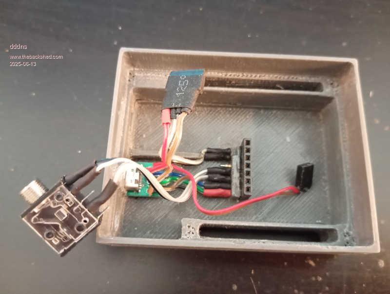

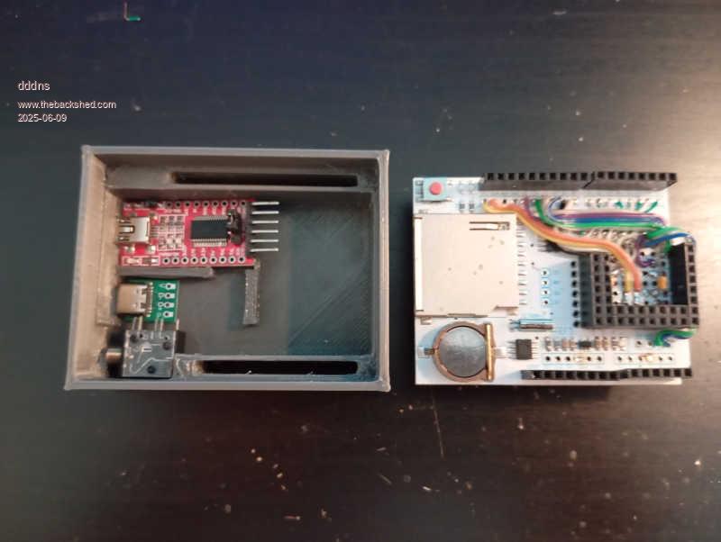

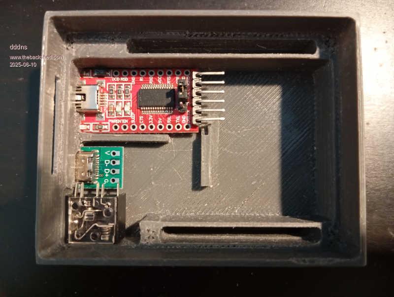

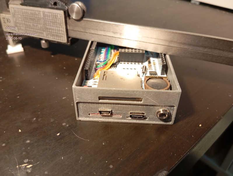

The last components missing are USB/UART, USB for the Pico and an audio socket.

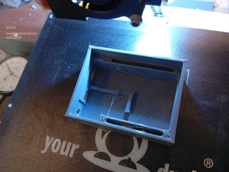

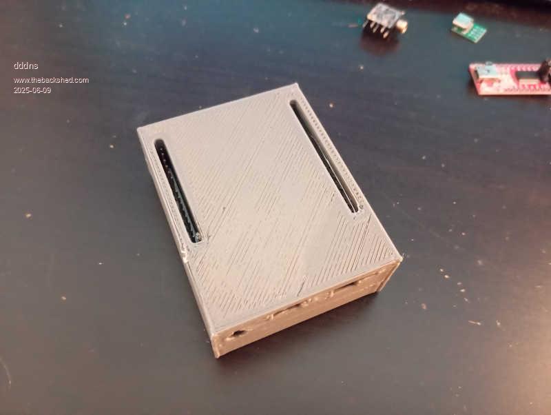

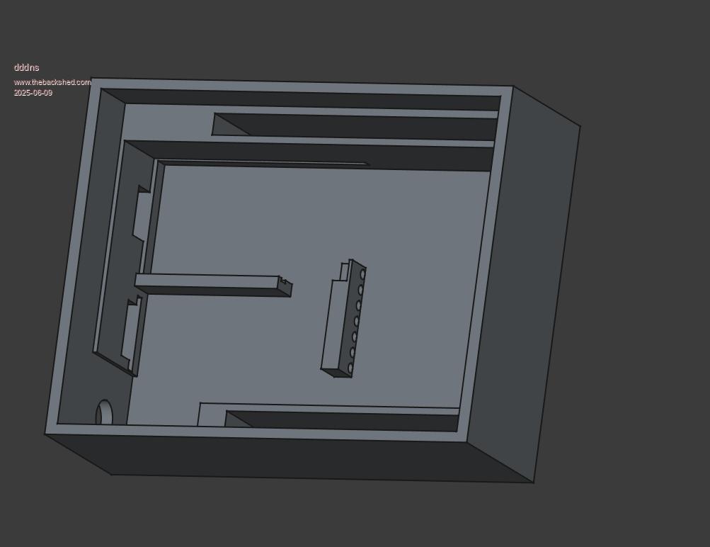

Now I take it as challenge and will not modify the board and need something to mount the missing parts. I took Freecad and designed a housing:
housing1.zip
Last material I have is PLA.. very ugly in every way, what can I do..
I can only estimate how much it also shrinks, a pain
After some Kg printing I about know now..it fits well :)
It can have a docking whatever :))

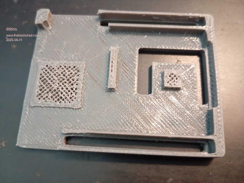

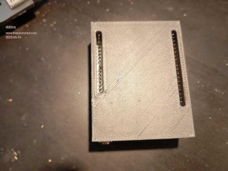

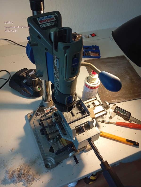

I have a little toy mill I use for (retro)fitting and this is the only tool
I will use to finish it. Everything is handmade and just in time, this morning:
Cleaned the print and went over all planes which I want to have "precise":
Leveled everything and milled a 0.8mm deep pocket:
The "docking pins" are 1,5mm below:
And this material for covering, it's PET and does not break. It can be cut with scissors or a cutter knife:

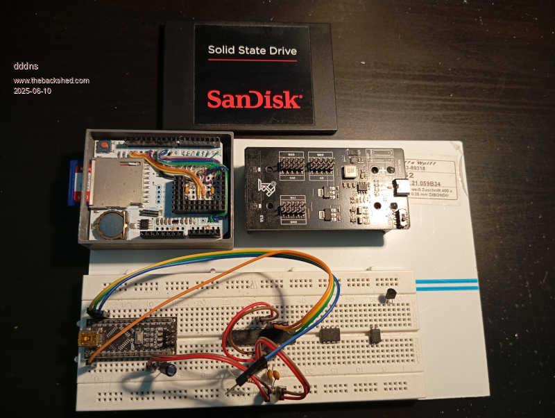

The path is the goal :) My last idea for a sense making "docking" solution. A chinese power source with 5 and 3V for two 18650 and a breadboard (ssd for size comparison):

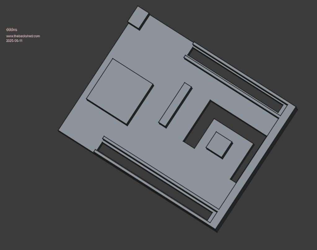

Posted: 01:21pm 11 Jun 2025
Hello :)

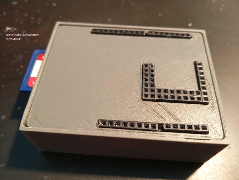

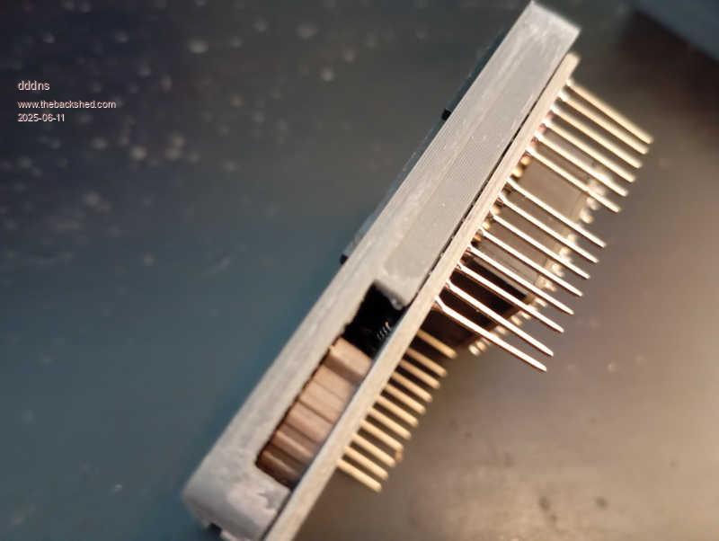

Today sun is shining and I'm not so motivated. But carpe diem and I designed an inlay:
Again, cleaned it with the little mill:
and fitted it in. Another pocket of around 1mm is created:
The inlay is 7mm in heigth:

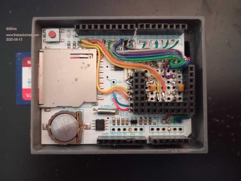

Posted: 06:05pm 12 Jun 2025
Good evening!
I need to get this done now..enough is enough of tinkering now.
I would like to look into HDMI so I clenched my teeth.
First the PET:
Then the inner wiring and on the board:
Finished so far, maybe I will move GP1(SD CS) to GP10 later:
Multilayer :))

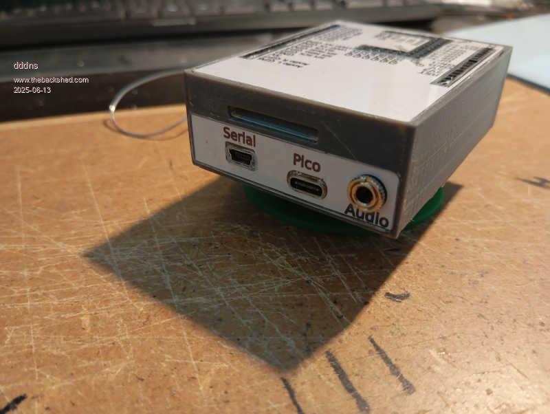

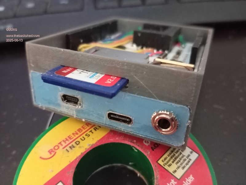

Posted: 12:55pm 13 Jun 2025
Hello All :)

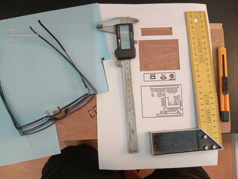

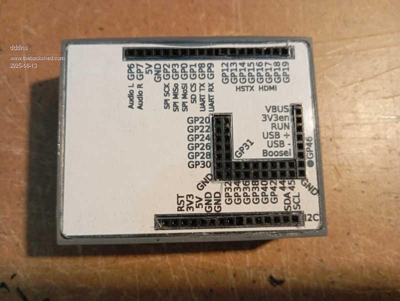

I've exported the inlay from Freecad as .svg to Inkscape. Now it's easy just to position the labeling around. Only need to setup a linefeed of 2,54mm and just write it down on each row. Then I printed the first drafts on white paper and made sure everything fits.
For the cutting and tho whole process I used nothing but:
And two hours of concentration and patience:
In this very close up it looks so lala, but in reality you don't see much of it:
